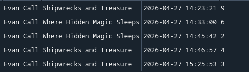

I use Symfonium with Navidrome. And today i took a look inside Navidrome’s DB and noticed that some songs had scrobbles with the same timestamp.
Navidrome
To reproduce the issue, i downloaded the songs in the screenshot and played them while disconnected from the internet, and consequently from the server. Then i did some tests.
Here’s what test each row in the screenshot represents:
1st: Me listening to the same song 9 times
2nd: Me playing 3 times, waiting one minute (Longer than the song’s duration) and playing 3 times again (Note the duplicated timestamps weren’t divided into 2)
3rd/4th: 2x Shipwrecks and treasure, 2x Where hidden magic sleeps and 2x Shipwrecks and treasure again (Noticed how these weren’t split into 3 either)
5th: Played it for 3 times and noticed the timestamp matched exactly with the time when i finished playing for the 3rd time.
Conclusion
This is my theory:
When Symfonium has no access to the server, it saves all song scrobbles on a buffer. When a song inside the buffer is played >1 times, the scrobble count for that song is increased and the timestamp is overwritten with the new one. When Symfonium gets a connection to the server, it sends all scrobbles inside the buffer count times, all with the same timestamp, then clears the buffer.
