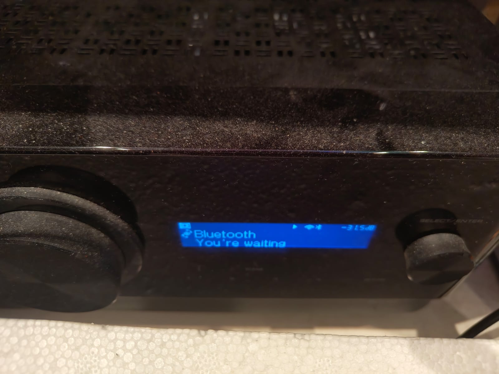

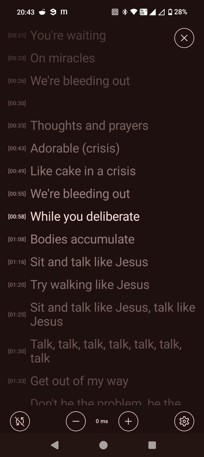

I embedded lyrics on mp3 file, they are working fine in the app but on bluetooth device the lyrics get stuck on 1st or 2nd line. If I seek the song to a different position they shift to new line and get stuck there.
Upload description: Manually embedded lyrics working fine in symfonium app but only 2-3 lines or 1 line is showing in bluetooth display.

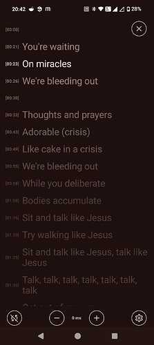

Embed synced lyrics using below command.
mid3v2 --TXXX “lyrics:[00:21.62] You’re waiting” ‘18 - A Perfect Circle - TalkTalk.mp3’

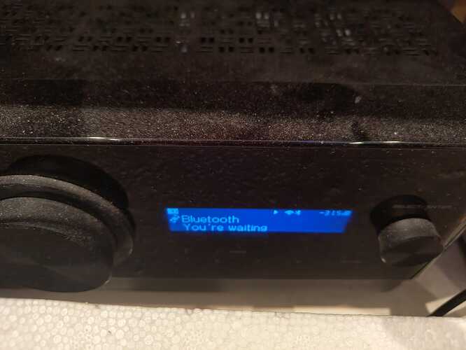

Play song over bluetooth to a device which has display to show song title.
Only 1st line or upto 2 3 lines will appear post that it will get stuck on that line.
Seeking will cause the display to start showing the new line but then it will be stuck on that.

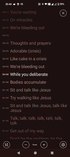

Those lyrics will work fine on symfonium app on phone.

If it works inside the app then it’s probably the OS or the device that fails to refresh if too much updates.
There’s not much I can do as the option is more an hack than anything else.

Yes all those files are showing lyrics inside the app. They work fine for sometime but if I show mini player in the lyrics and start changing songs after 4 or 5 songs the lyrics scrolling gets out of sync with the timestamp. If I flip the phone to landscape the scrolling again gets out of sync with the timestamp.
If I stop and replay the song the scrolling lyrics are correctly synced again so I am still confused have I put embedded some rubbish which might be causing this as I automated the process and ran it for multiple files with bash.

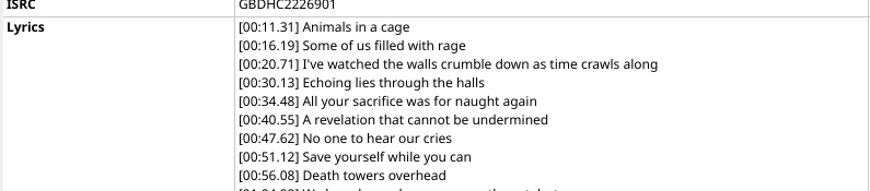

Unrelated but the non working file have broken tags.

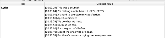

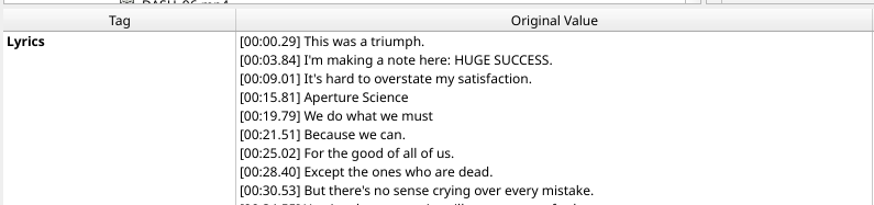

The main difference between both files is that one lyrics have . and : and the other none of those. They maybe break your BT device.
Could you please elaborate on the difference in lyrics one having a . and other having a : as I cannot see this difference.
Below are the snippets for your reference.
Not Working
Working
