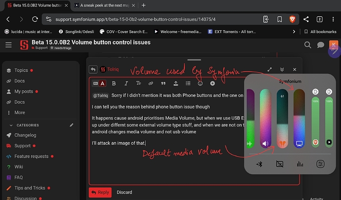

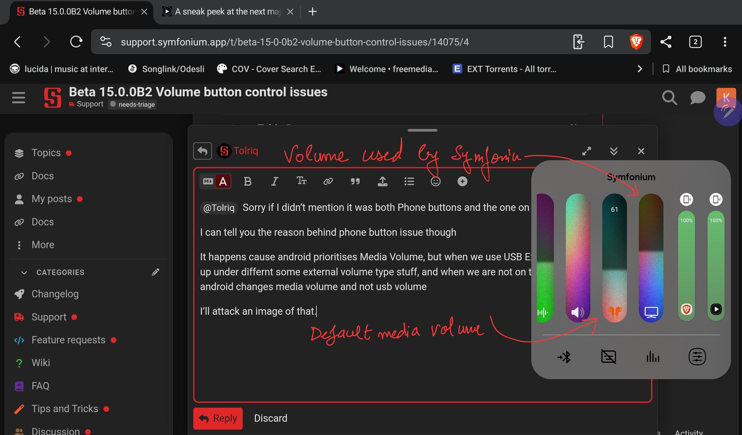

@Tolriq Sorry if I didn’t mention it was both Phone buttons and the one on IEM
I can tell you the reason behind phone button issue though
It happens cause android prioritises Media Volume, but when we use USB Exclusive Mode it shows up under differnt some external volume type stuff, and when we are not on the symfonium screen android sometimes changes media volume and not usb volume.
Esp when Support DAC button is enabled
I’ll attack an image of that.
