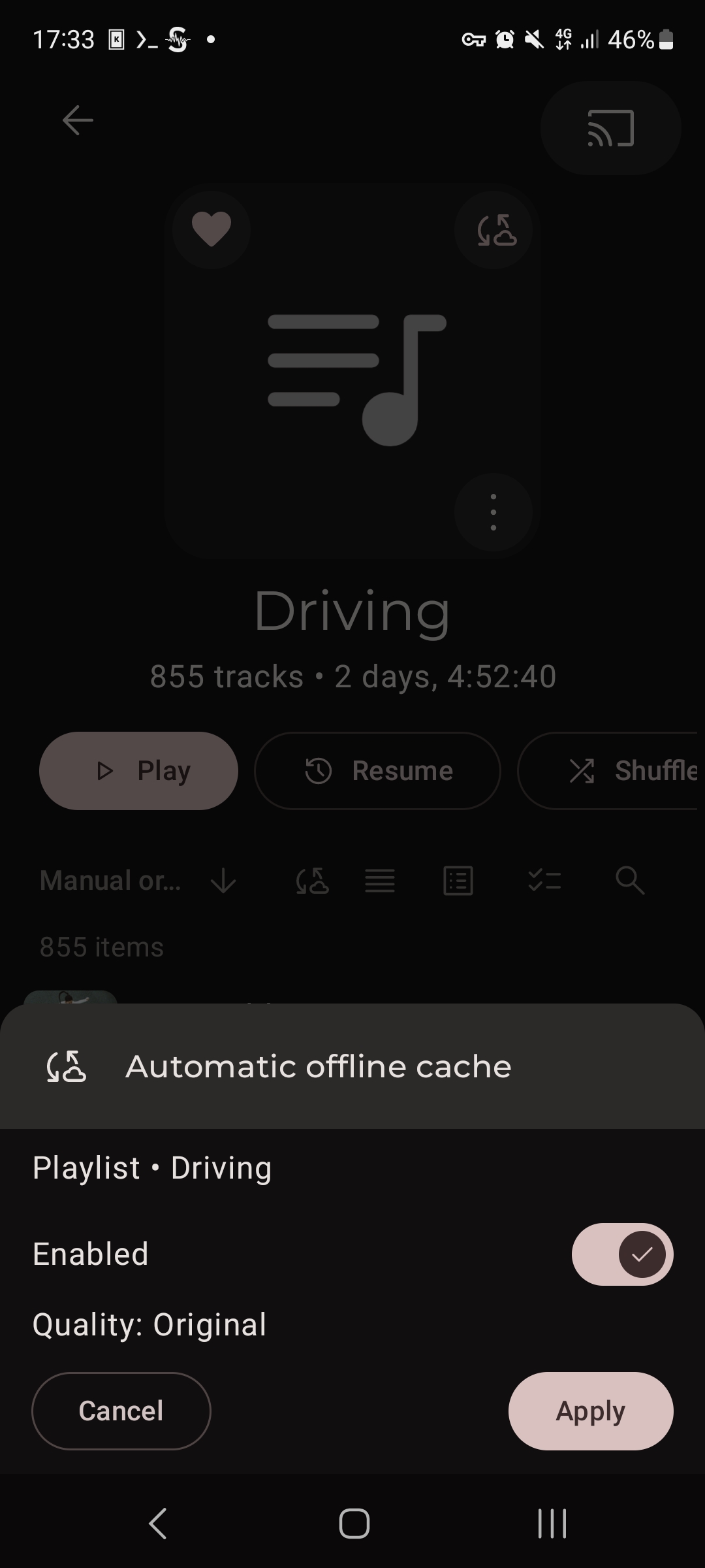

Having an issue with the caching - it is removing what seems to be perfectly good files as if they are no longer associated but I am able to play them perfectly fine through both Navidrome itself and the Symfonium client
Upload description: VikingSchism
I’m having an issue with caching of files, whereby the cached files seem to get cleaned as if the track had been removed from the server (they haven’t been)
This has led to the same files being downloaded and then wiped and then downloaded again (auto-rules)
Using Navidrome as source
On recent update
Cached files are being repeatedly cleaned despite being present on the server and playable

Rule is presence in a playlist, and the tracks are still present in said playlist
The auto-rule is triggering to redownload them after they get removed becuase of this
What kind of playlist? How are they created, what settings for the rule?
The playlist is a standard playlist (not a smart one) and the rule is simply to cache everything in the playlist
