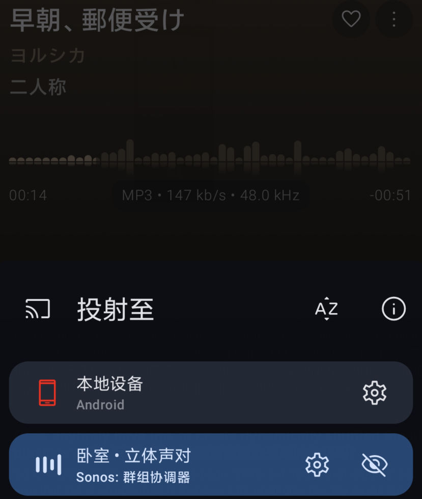

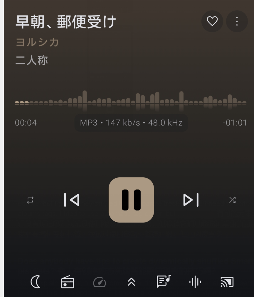

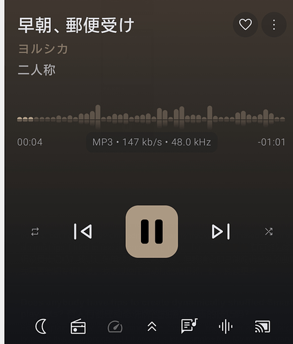

Since updating to version 14.0.0, I’ve noticed an issue when casting music to my Sonos speakers: all audio is now being played in MP3 format.
Before the update, my music used to stream directly in its original format (e.g., FLAC) without any forced transcoding.
