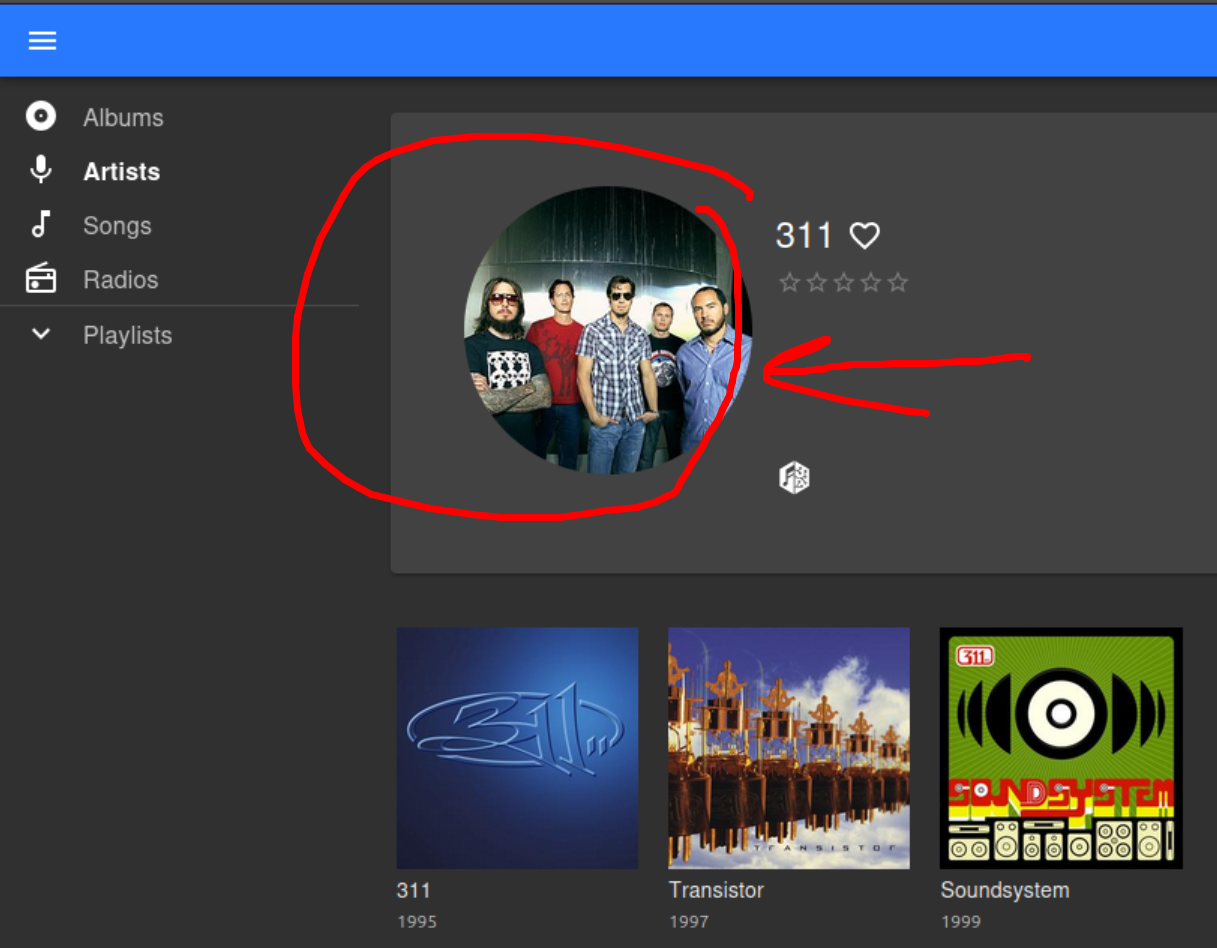

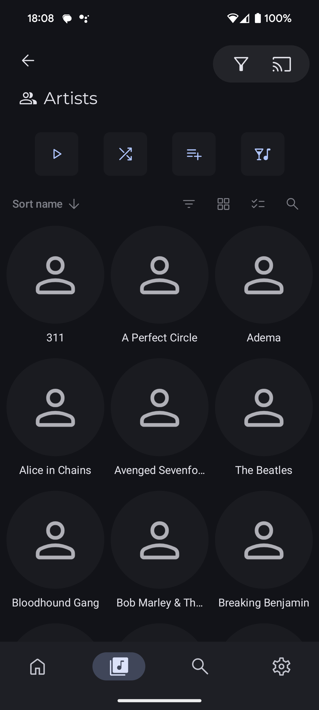

I tried using the “sync” button from “Manage Media Providers” but the Artist images in Symphonium aren’t displaying.
Source image (from Navidrome):
Symphonium Artists screenshot:
Then open your own proper issue with logs :slight_smile:
