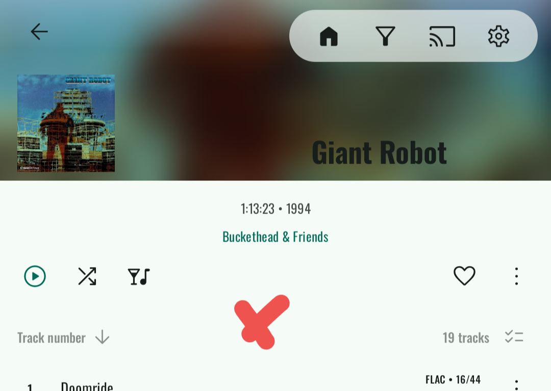

This album shown is by the artist Buckethead, but shows up as Buckethead & Friends which is incorrect.

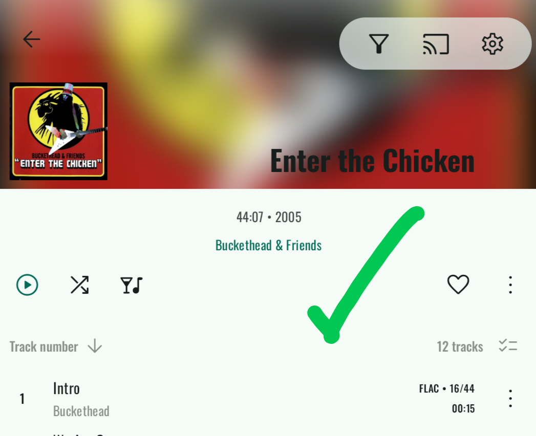

I have one album by Buckethead & Friends, but that is a collaborative record whilst this one (and others) should be by just Buckethead.

Go to any Buckethead album, and it shows as the wrong artist.
Giant Robot is by Buckethead. It is incorrectly labelled as Buckethead & Friends. Enter the Chicken is by the Buckethead & Friends collab artist name making it the only one that seems to be correct. I use Musicbrainz to help with metadata so there shouldn’t be a problem in regards to that.

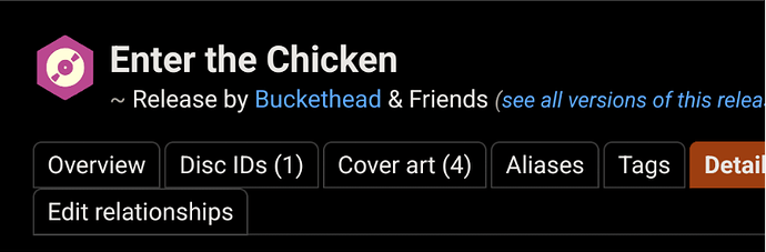

MusicBrainz does not have a separate MBID for BH “& friends” vs just BH.
You can see the linked artist is just “Buckethead”, not the whole “Buckethead & Friends”. Thus, as I said, they share the MBID and will appear grouped in your library. See solution 2 above.

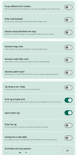

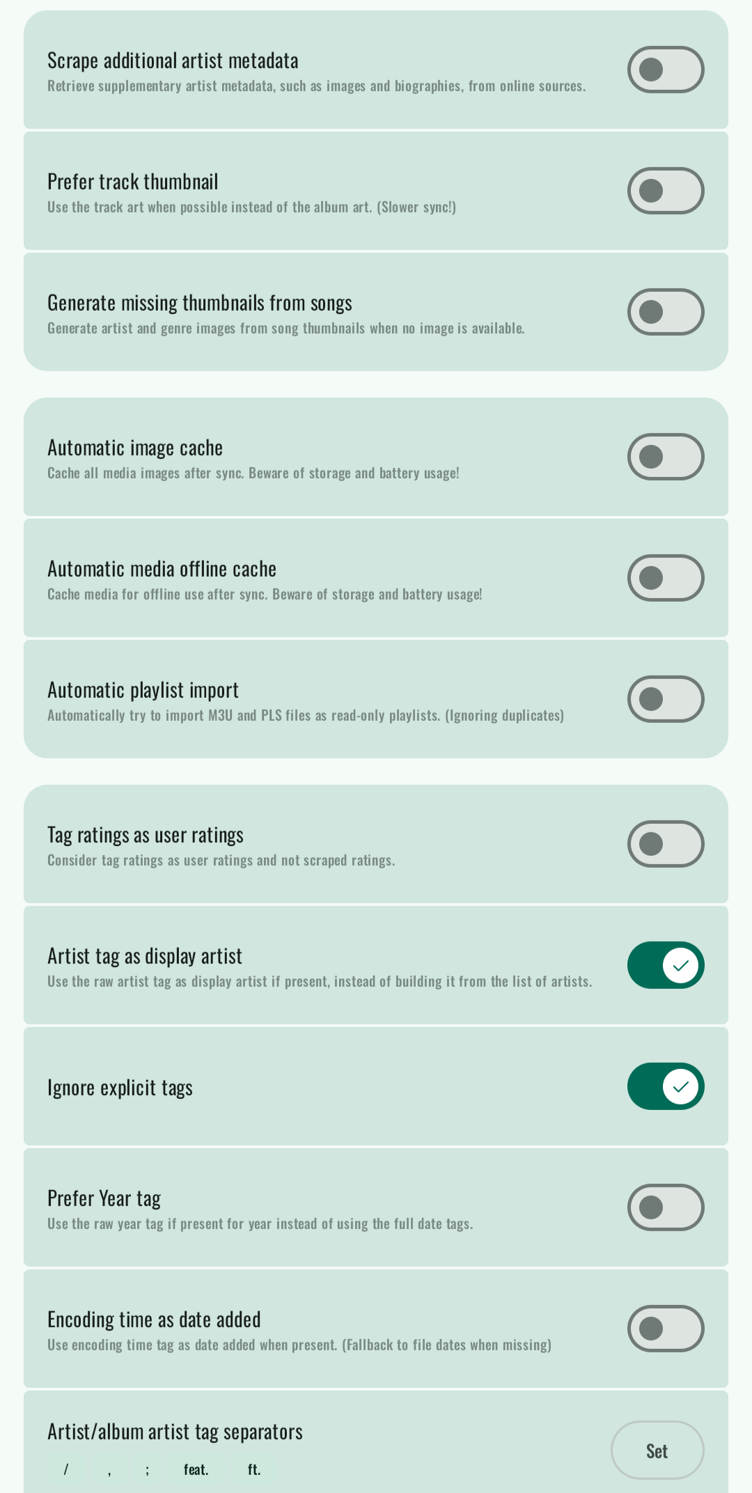

Or if you don’t want to edit the tags, then as I said you can enable the option in Symfonium inside your Media Provider settings to ignore MBIDs for the whole provider. (Which may negatively affect other artists.) This will allow the app to look at the actual Artist tags, so “BH” will be separate from “BH & F” as you would expect.
Hey there. I did disable it, but it’s still incorrect. Not sure whats up.
