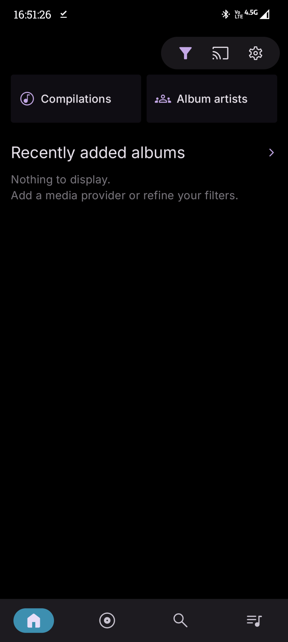

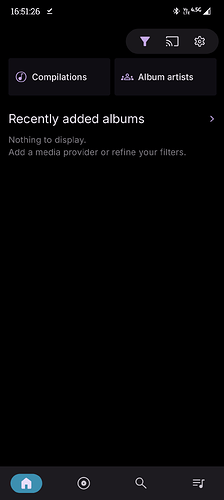

Is this expected behaviour?
Every time theres an app update, symphonium loses sync state, and I cant play the offline cache without syncing to the media player.
Is there a setting to make it sync right after a background update?
Upload description: ucyclean
This happens every time I start the app after a google play update.
Nothing is lost during update and your log is empty so it’s hard to know anything.
All I see from your screen shot is that you have a filter enabled and the text says to check the filters.

Sorry. I will try to produce a log next time it happens.
The screenshot is from thursday.
I set the app to default to “only show offline media” when it is not connected on wifi.
Albums on offline cache did not appear. Is this expected behaviour?
This was quickly solved by manually syncing, as i had a cellphone connection at that time and place.
