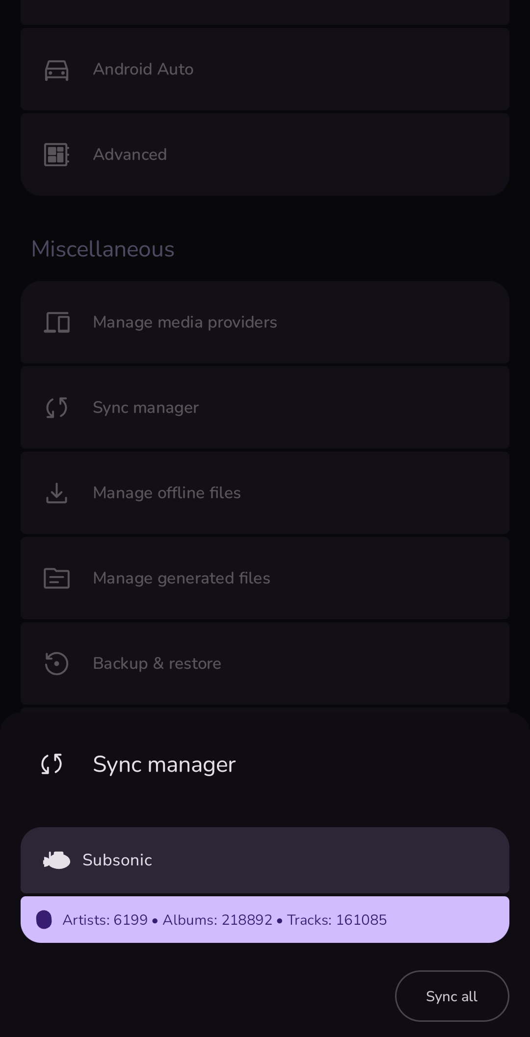

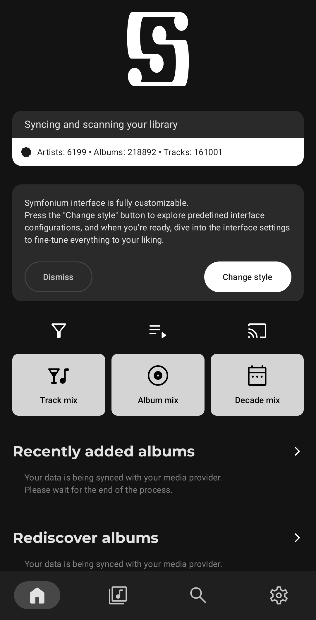

App gets stuck on syncing large database

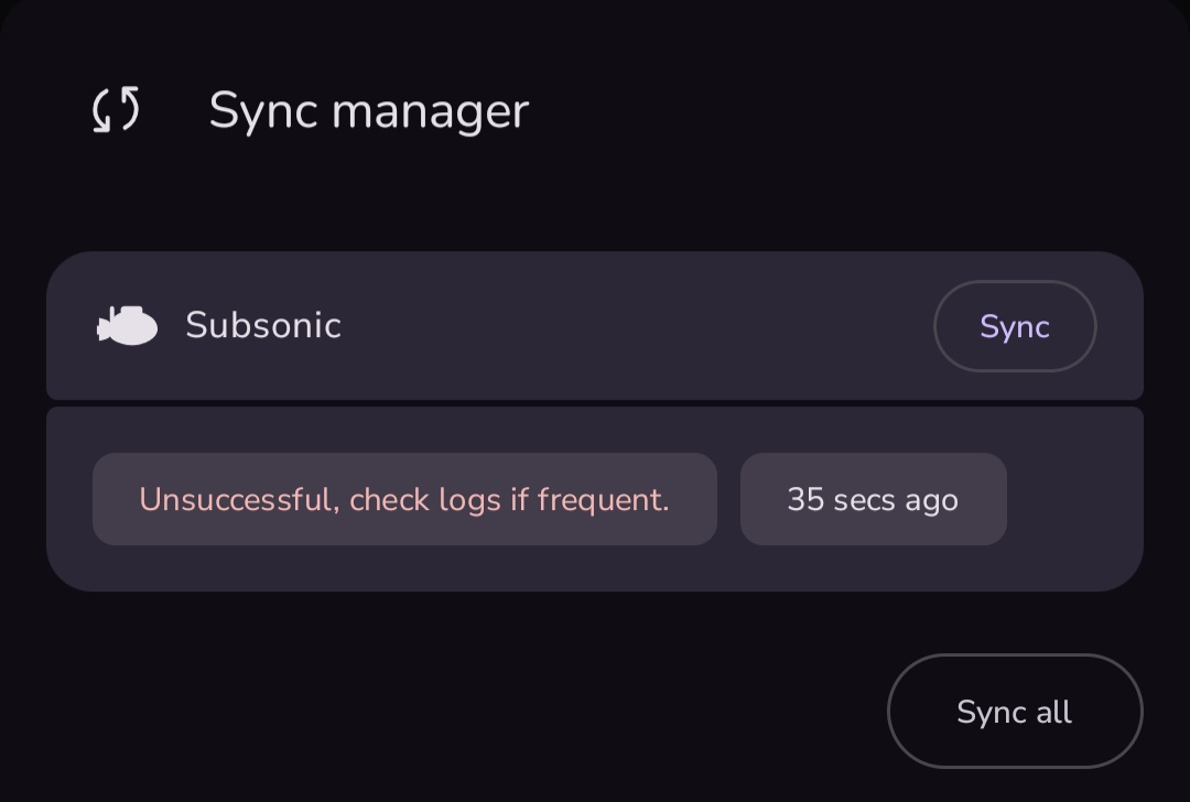

Hi, the app seems to get stuck when syncing the database at around 161k songs. The database has 700k songs in total. I have tried several times and re-installed the app but every time it gets stuck around there. The exact number varies but it stops there and then displays the following message “Unsuccessful, check logs if frequent.”

Ok so this is a Navidrome bug.
Required value 'title' missing at $.subsonic-response.searchResult3.song[94]
The title value is missing for that song, while it’s a mandatory field.

@deluan this is on “serverVersion”: “0.60.3 (34c6f12a)”
Jasmine you’ll probably need to provide that file to Deluan so he can repro and fix.
The only situation where the title may be missing is when it is missing in the DB, and there’s no way the scanner will add empty titles, it falls back to the file path if the tag is missing. Maybe you used some external script that writes directly into Navidrome’s DB?
Reading it again, maybe the title tag is present, but with empty value? @Jasmine can you confirm?
Hi, I’ve resolved this now by changing the title. Sync works!
Navidrome side also have a patch to prevent that in the future thanks Deluan.
