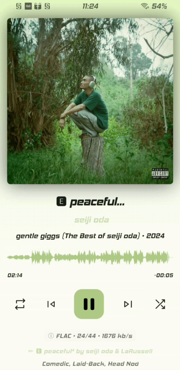

Recently tried this & for me it didnt matter which speaker I used I could open Sonos & group them with the currently playing speaker. Im on whetwver newest version of the sonos app. I did notice Symfonium had a seizure after creating a group of my Sonos Speakers which was odd. I couldn’t get it to do it again in a log so i may have to wait on that one
Screen_Recording_20250319-112440_1
This is just after creating the group in Sonos & heading back to Symfonium. Music playback was fine during this which i found interesting.
