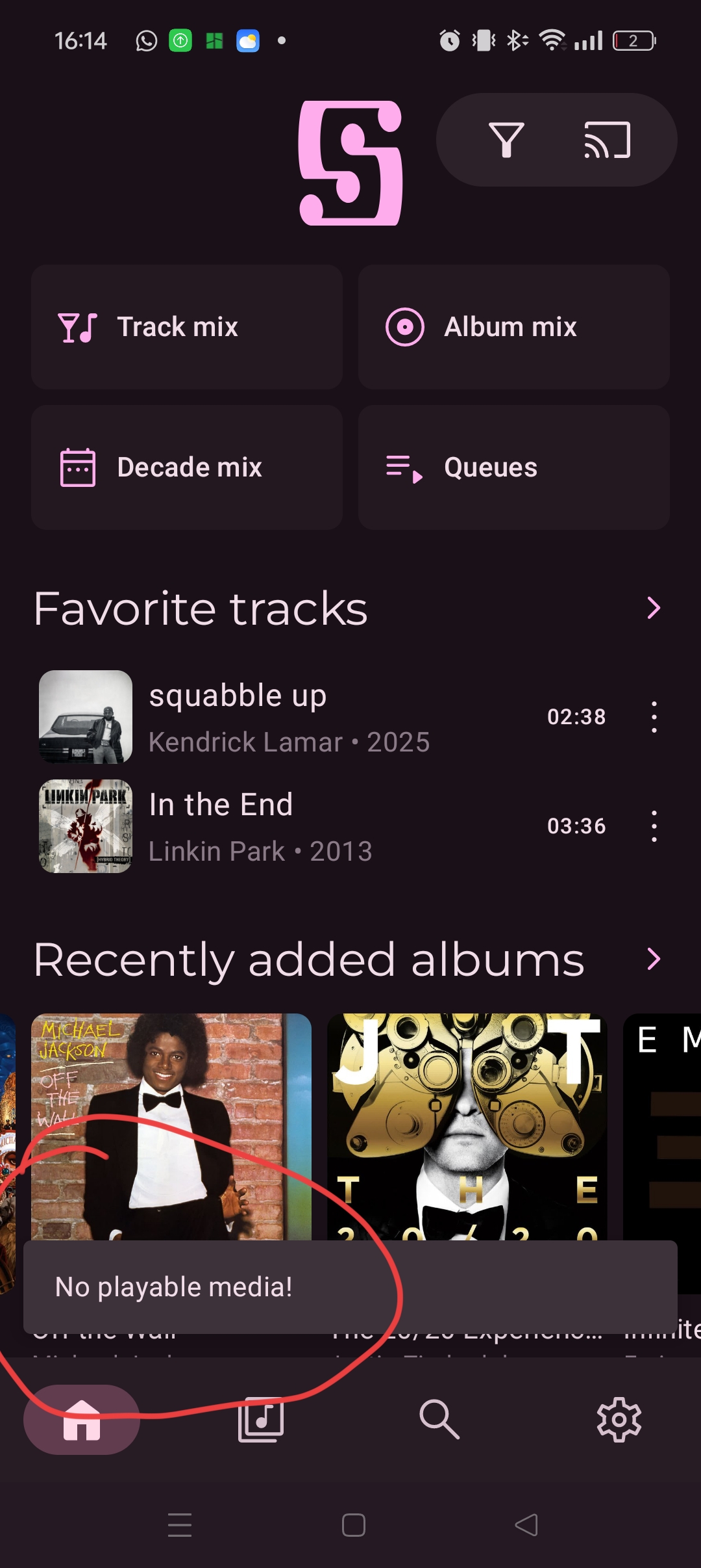

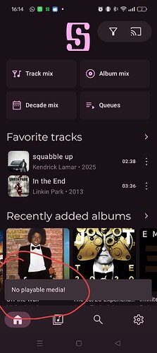

With the Emby server configured, I can access it from the LAN but not from Internet.
Upload description: debug-20250315_160421.zip
Setup Emby source with both hosts.
Connect to LAN and play a song: works
Cut WiFi and attempt to play a song using LTE to access the service: doesn’t work.
