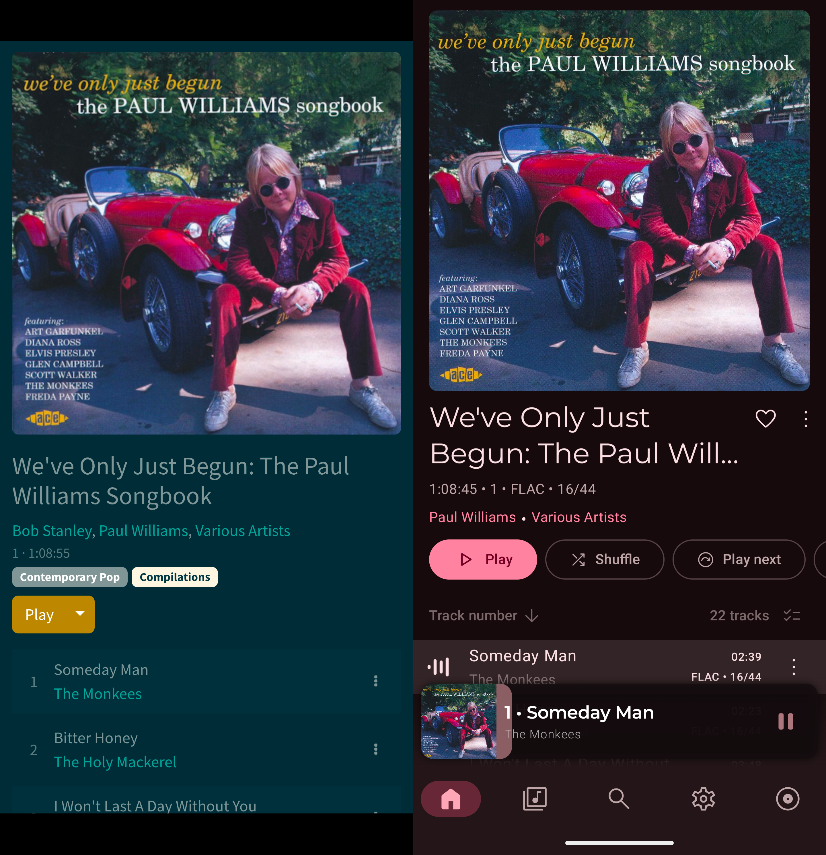

Album Artists not displaying correctly

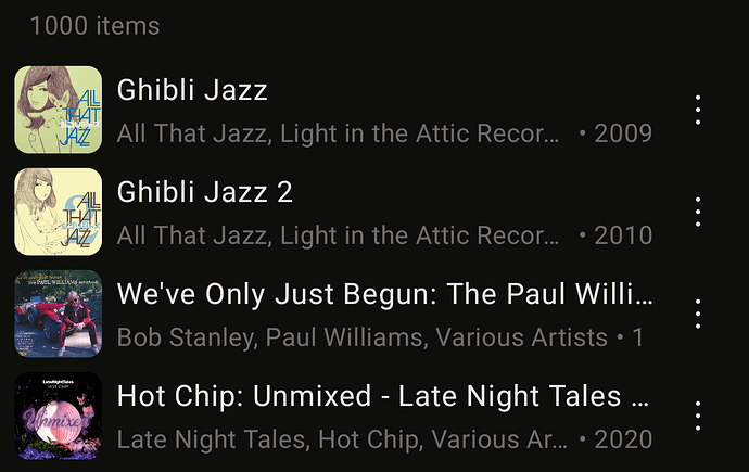

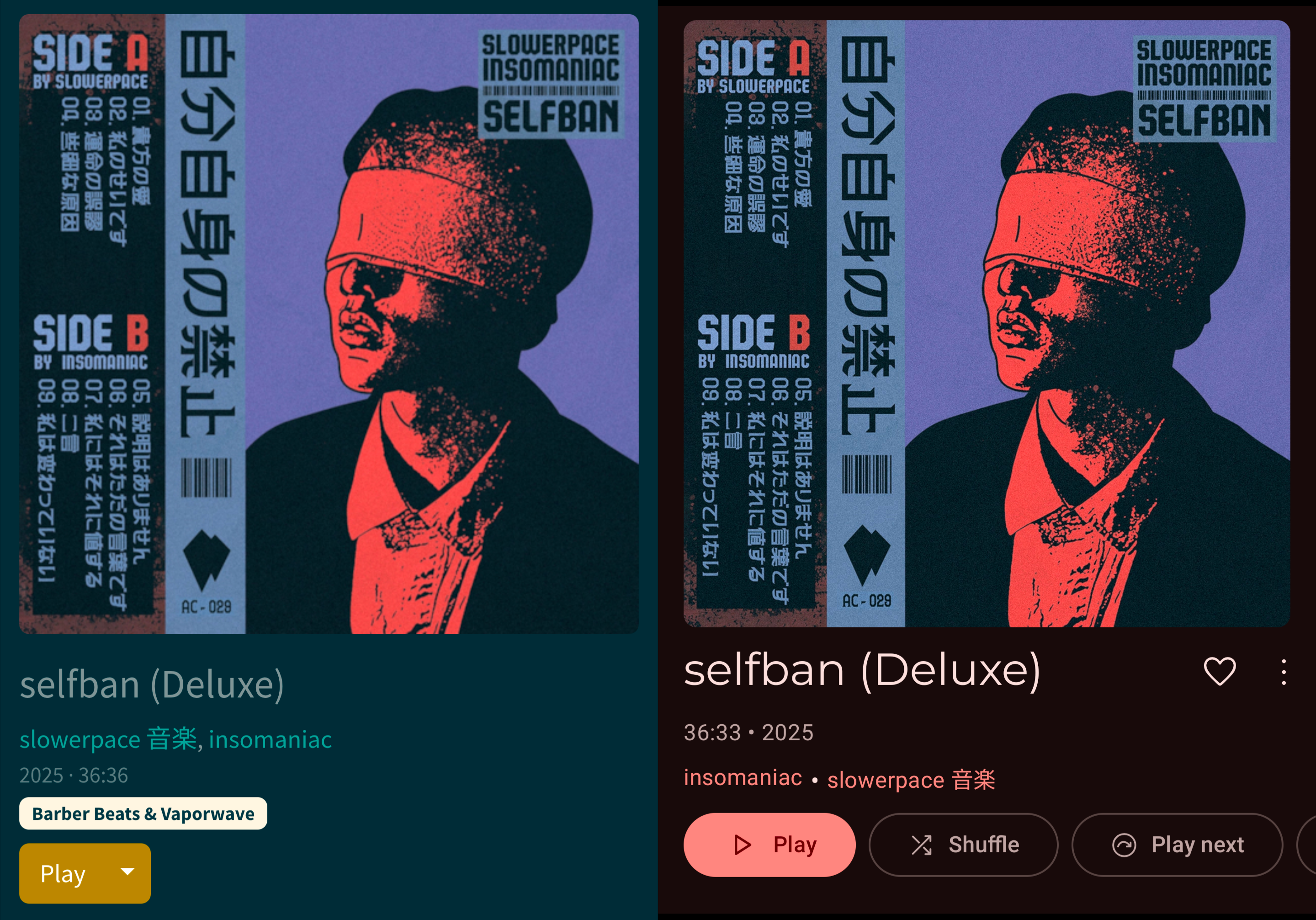

All of a sudden Album Artists are not displaying correctly on the Album and Artists pages, but I can see the correct info on Album Lists. Some albums display everything correctly, but some are inexplicably incorrect.

Symfonium displays what the LMS API returns, in one case it shows the displayAlbumArtist value that seems ok, in the other case it displays the list of album artists returned by the server for navigation.
Either the server does not return all, or there’s a mix up with the ids and the names.

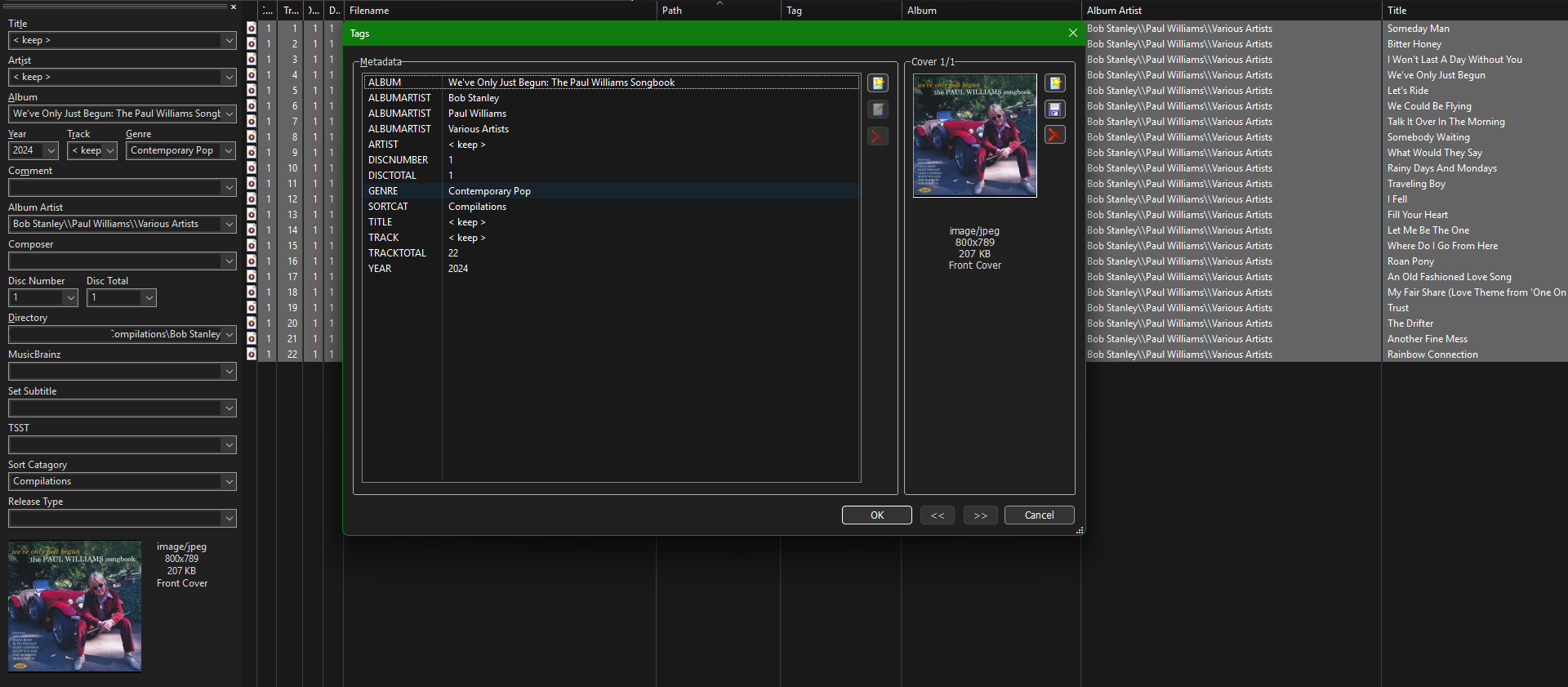

Unfortunately the albumartist appear uniform in Mp3tag

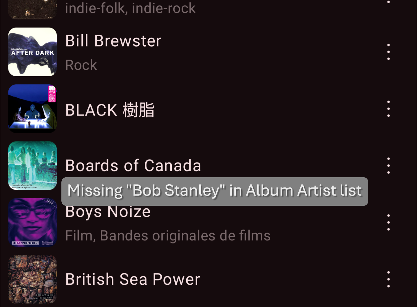

I think I may have figured out the issue: Symfonium seems to check if the album artist actually appears as an artist on an album, and if not it is hidden. I added Bob Stanley as an artist on one of the tracks and after resyncing it shows up properly in the Album Artist list and in the Album view. When I remove him as an artist for that single track and resync he no longer shows up in thee Album Artist list or Album view. All the album artists I am having trouble with I believe are things like record labels, compilers, and collectives that wouldn’t appear as an actual artist on a track, or the album artist is a trio but the tracks are all a single artists.

So the missing artist is:
              "id": "ar-7500",
              "name": "Bob Stanley"
And that artist is nowhere to be seen on the search3 calls for artists.
