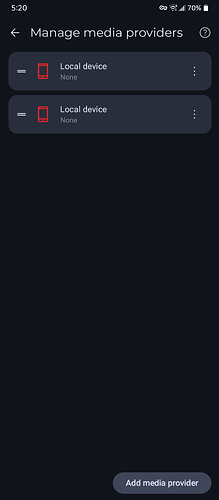

Restoring a Symfonium backup which has different paths set in the “Local device” option will create a second “Local Device” media source using the backup’s paths, instead of merging them into the media source.

No negative effect, files are read from both paths correctly and files from each can be correctly hidden via Source Filter menu.
Honestly a neat “feature” since we can’t manually add multiple “Local Device” providers. Allows for setting different tag separators for a set of paths, or for scraping metadata for only a portion of the library.
Inconsistent when editing existing media source, will test further…
Consistent steps: From fresh install, set source as Path A. Make an app backup. Uninstall app, reinstall. On 2nd fresh install (same device), set source as Path B.
Restore backup from first install, grant access to Path A. There are now 2 media providers listed: one with Path B and one with Path A.
