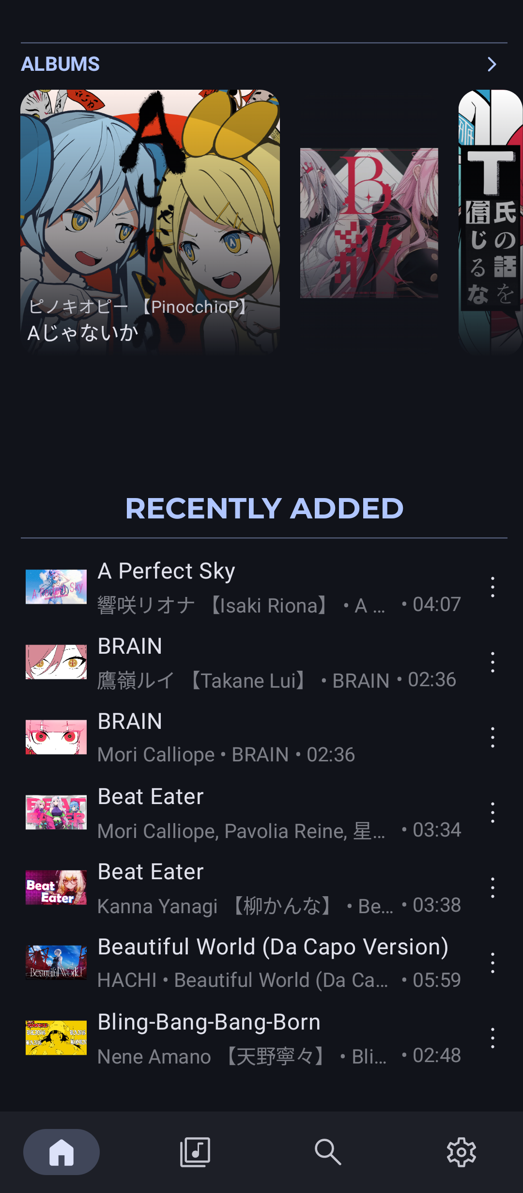

Pic 1: state when saving App Style

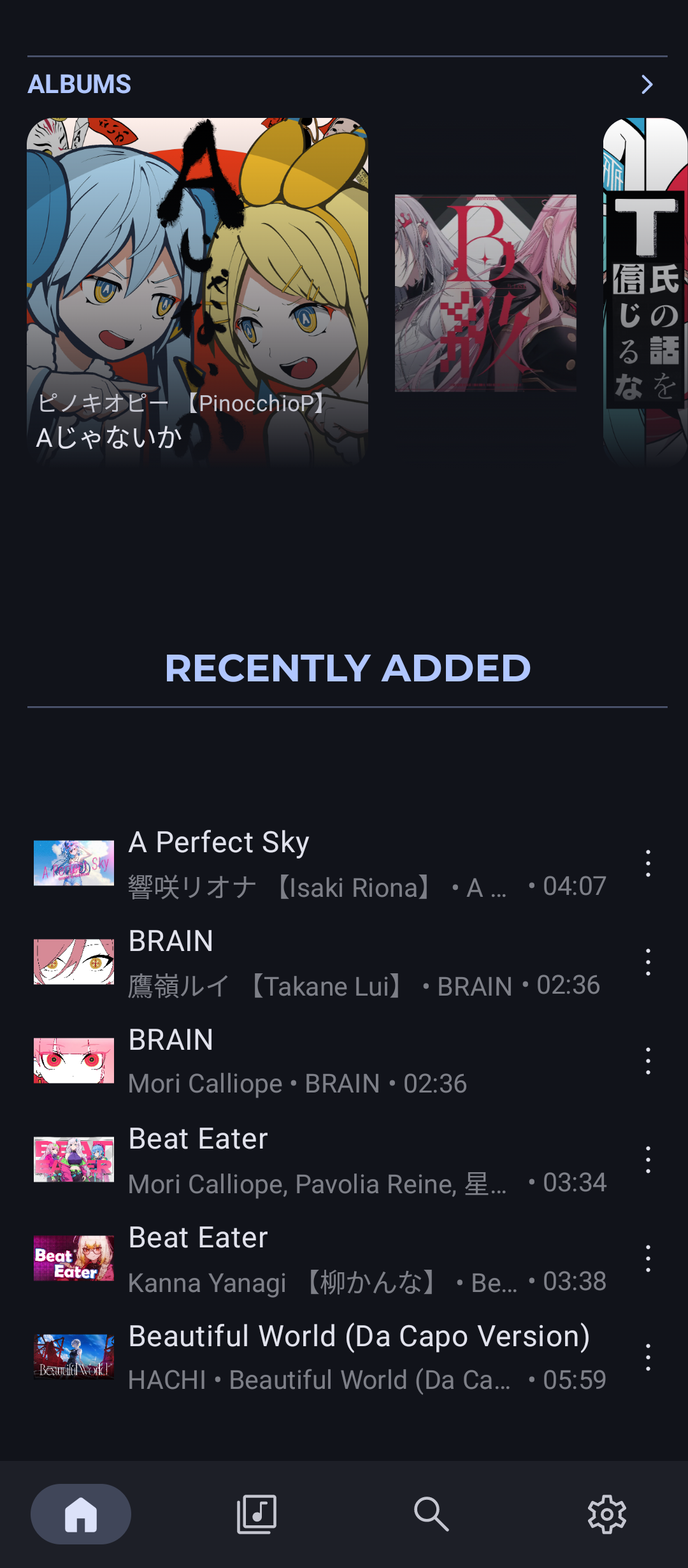

Pic 2: changed spacing before track list. Restoring App Style still leaves me with this layout

Add a playlist to the Home page, then save an App Style. Now go to “Interface > Home page > (Your Playlist)” and adjust the layout. Make an obvious change like setting it to Grid instead of List.
Load the App Style that you made in the first step. The layout will not revert to “List”.
