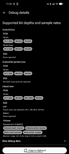

USB Exclusive mode not working 15.02 beta (Pixel 8 pro / Qudelix 5k)
Beta
Testing beta usb exclusive modes using all available options and monitoring the sample rate received into the USB Dac, none of the audio seems to be bypassing the android 48khz limitation when playing 44khz audio, audio above 48khz is given in correct sample rate regardless of exclusive modde or not.

Enable USB Exclusive mode
Play 44.1khz song
Check received sample rate in Qudelix app

I need the logs as the check you checked says :wink: And the content of the debug details from the output settings.
Apologies, uploading through the app doesnt seem to be working for me currently, have uploaded manually titled “Juststylish - USB Exclusive mode not working 15.02 beta (Pixel 8 pro / Qudelix 5k)”

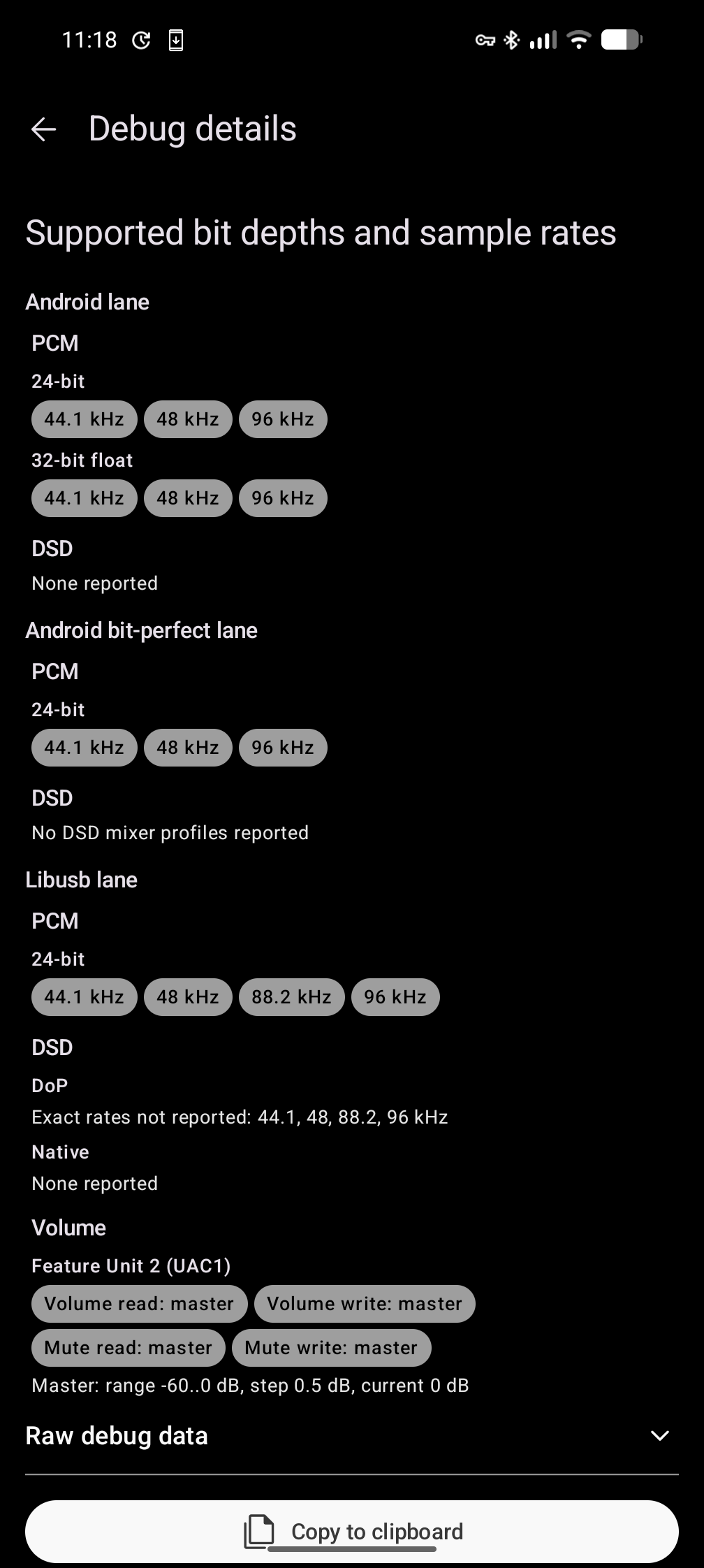

Please also provide this, the copy to clipboard and a screenshot.
Edit and provide a log with usb exclusive showing this, as in the logs all 44.1 in exclusive are send at 44.1.
Current output summary
Captured from USB.
Android lane:
Status: Reported by Android audio profiles
PCM: 24-bit @ 44.1, 48, 96 kHz; 32-bit float @ 44.1, 48, 96 kHz
DSD: None reported
Android bit-perfect lane:
Status: Reported by Android mixer profiles
DSD: No DSD mixer profiles reported
HiBy lane:
Status: Not applicable on the current device
FiiO lane:
Libusb lane:
Status: Profile resolved
PCM: 24-bit @ 44.1, 48, 88.2, 96 kHz
DSD: DoP possible but exact rates not reported (44.1, 48, 88.2, 96 kHz)
Volume: Feature Unit 2 UAC1 volume read master; write master; mute read master; mute write master; ch0 range -60..0 dB step 0.5 dB, ch0 current 0 dB

Can you provide the new log showing 44.1 in exclusive mode actually playing at 48 ?
uploaded new logs under name “JustStylish - USB Exclusive mode not working 15.02 beta (Pixel 8 pro / Qudelix 5k) v2” , this is after using both usb exclusive modes back and forth and messing with all the settings to confirm and 44.1 audio still seems to be being read at 48
I guess that you check the sample rate via the other app and answer yes when it ask for the permission ? That removes the perm from Symfonium and then only expose the DAC as 48k DAC.

Normal case, it will play at 44.1 with no issue.

Not normal case, the app have no more access to anything and only see a 48k path and use it.
