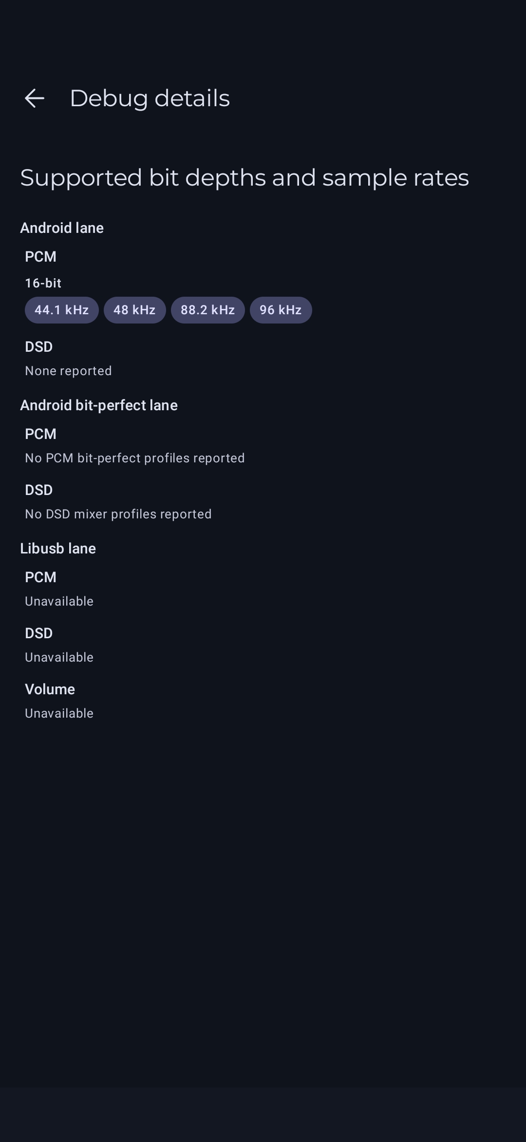

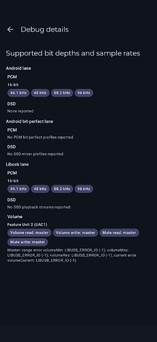

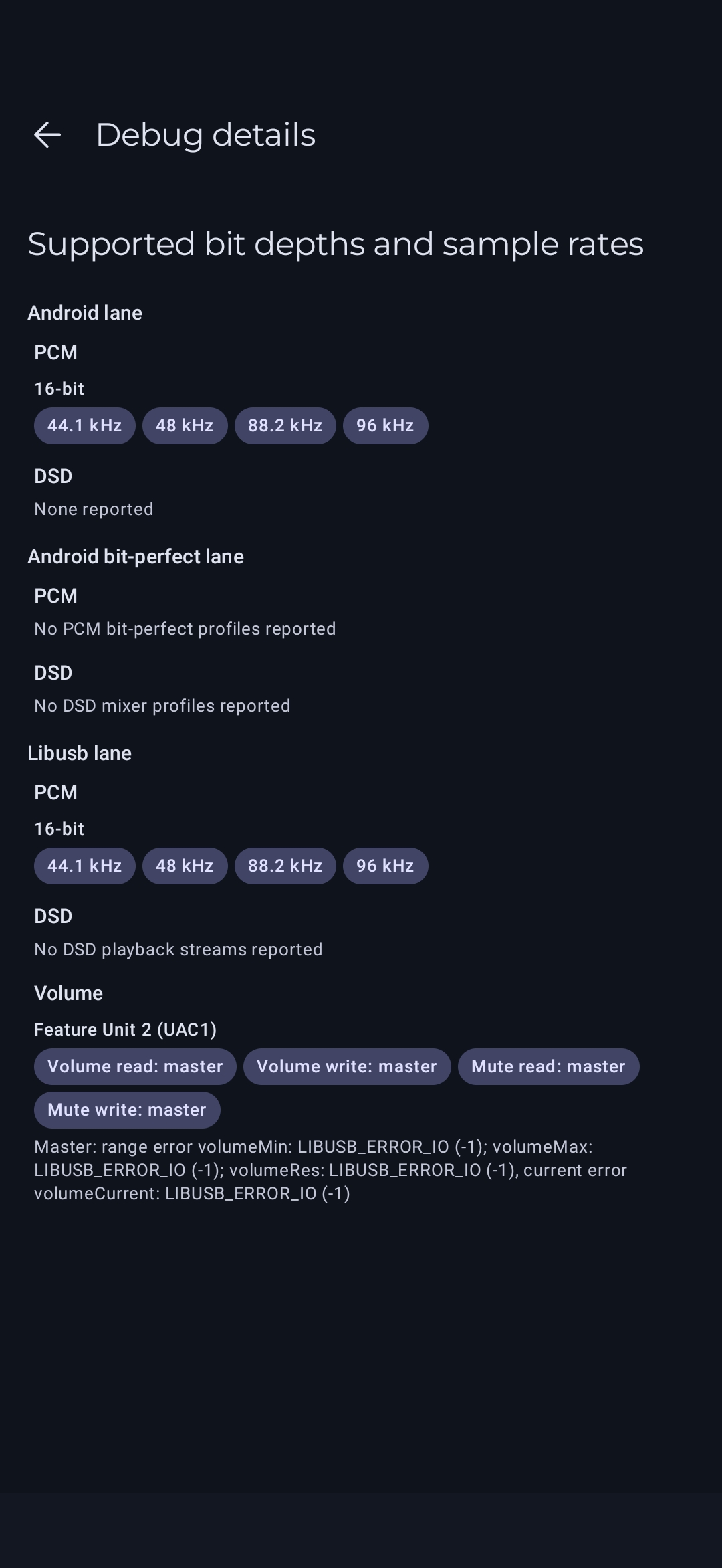

usb exclusive mode (there seems to be some error at bottom)

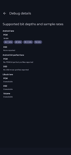

android direct mode (does not seems to show all info)
Outside USB exclusive it’s out of control of the app.
