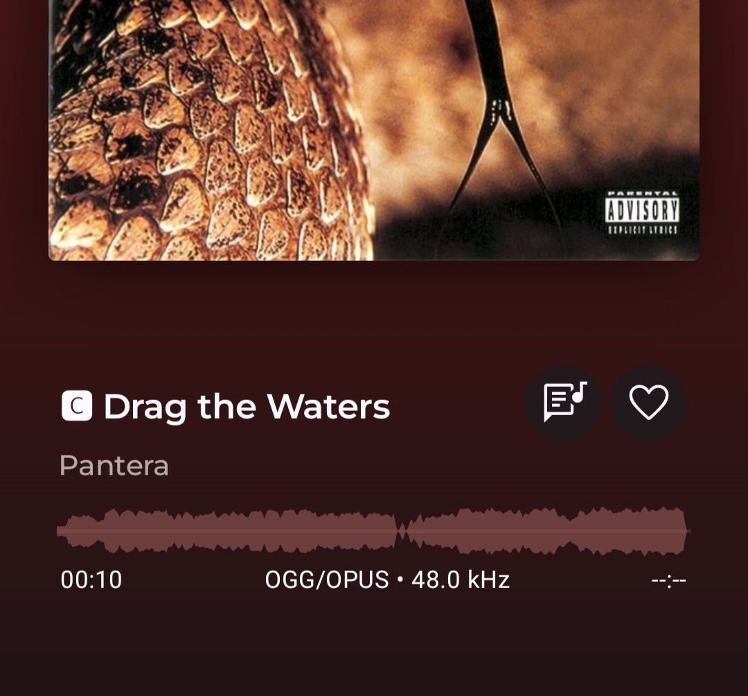

Unable to seek when transcoding enabled
Upload description: m-spitfire
Subsonic server: gonic 0.19
When transcoding enabled on the server side, Symfonium isn’t able to seek ahead in the song. I know that this requires a specific opensubsonic extension on the server, and I have checked that gonic has that extension.
Additionally, seeking works fine in another client, Supersonic, with transcoding enabled, so I think this is a Symfonium issue.
