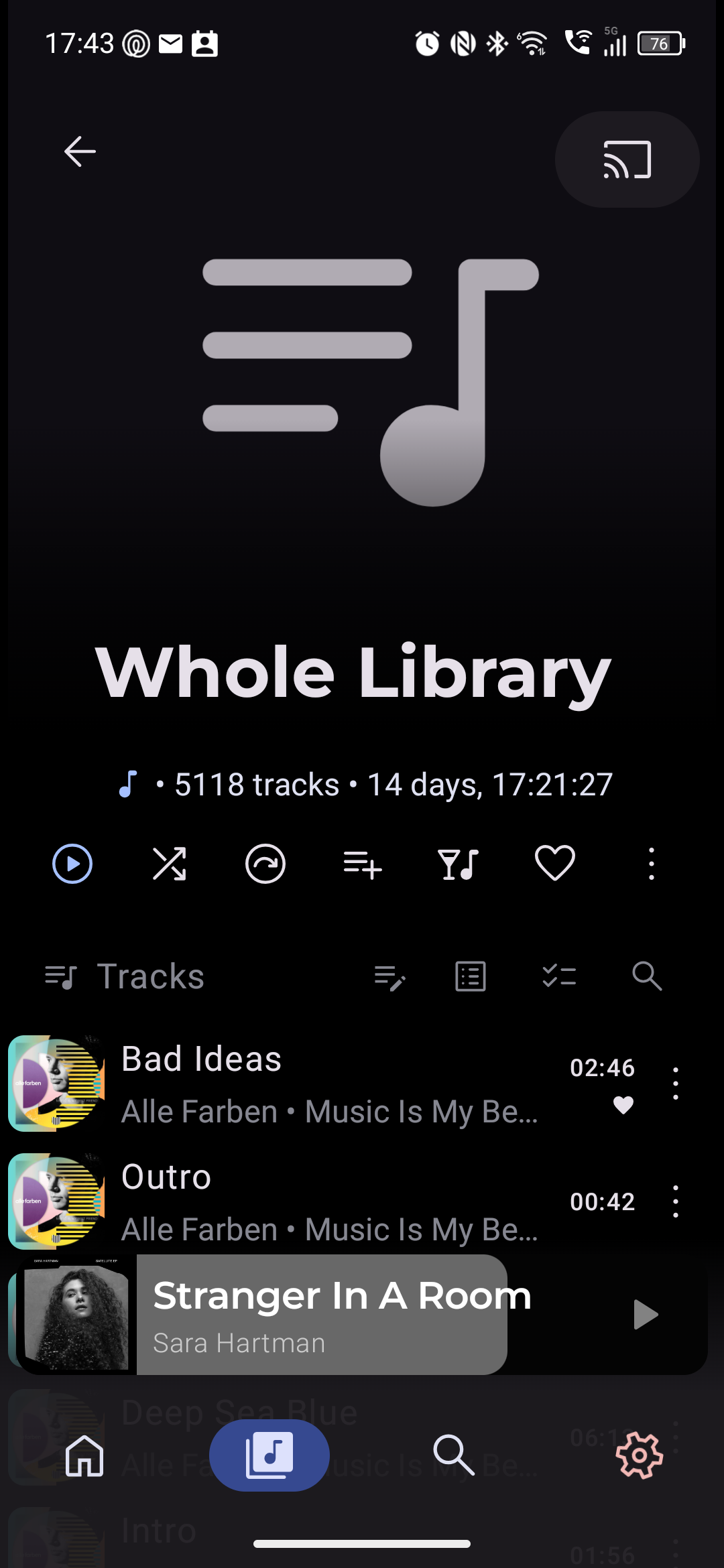

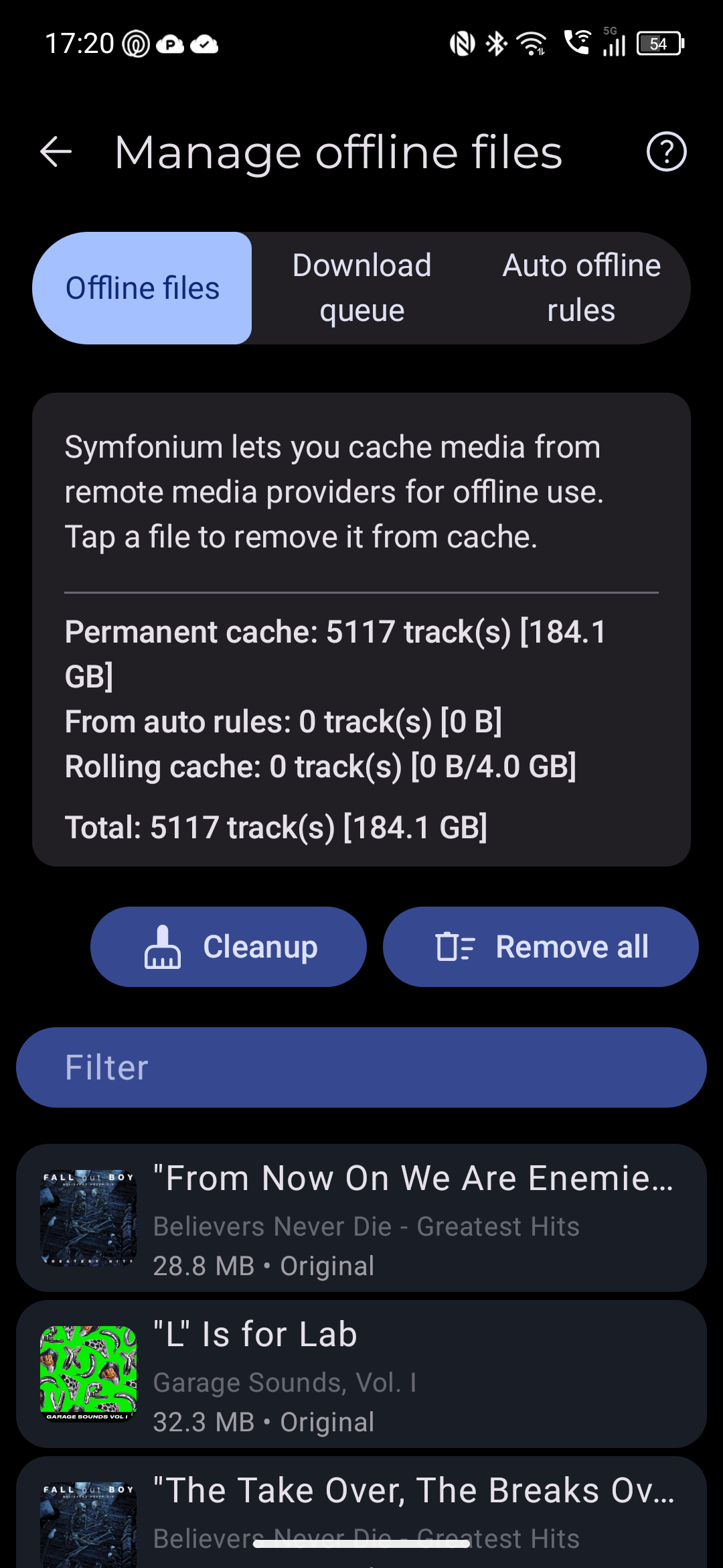

Trying to sync whole library and seem to be missing 1 track
I am trying to sync my whole library to my phone. I’ve created a smart playlist with a match of anything with a duration of 1 second. The playlist shows the correct amount of tracks 5118 but when I sync this playlist to my phone it downloads 5117. I’m not sure why there is 1 track missing. It could be a problem with the track buy I don’t have any idea how to figure out which track is the missing one.
Could you help me figure out which track is the missing/problem track please?
Navidrome
Create smart playlist with a match of “duration = more than 1 second”
Playlist shows all the tracks from my Navidrome library (5118)
In the playlist options select “Configure auto offline cache” > Enabled
Tracks will download to phone
Upon completion downloaded tracks show 5117

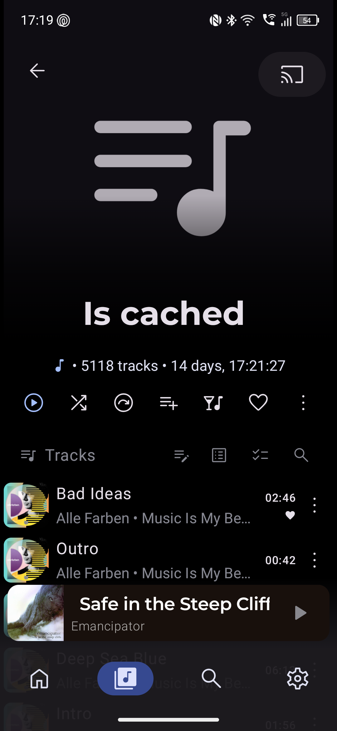

I’ve added screenshots of the playlist showing 5118 tracks and the “Manage offline files” screen showing 5117 tracks

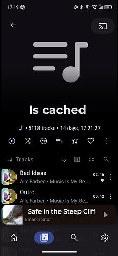

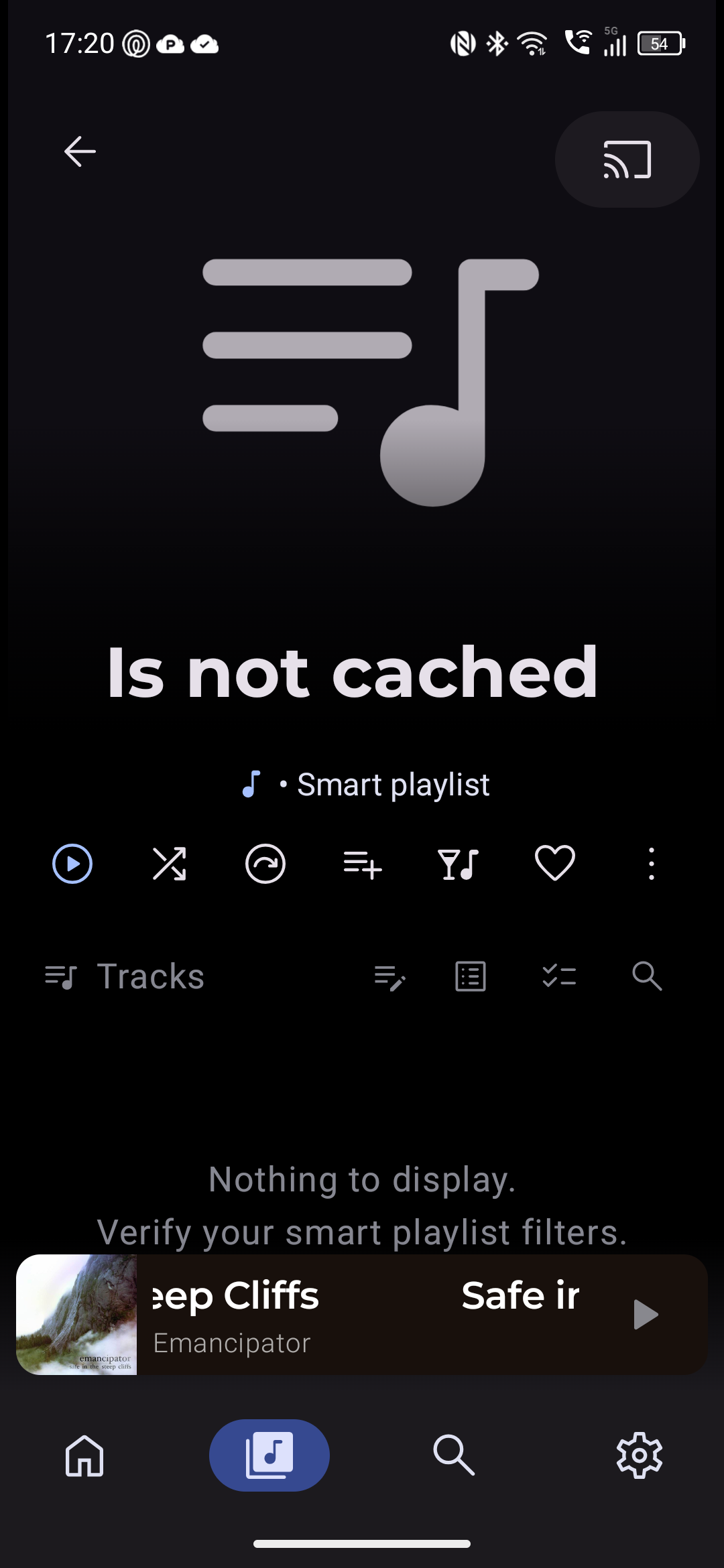

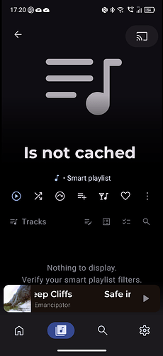

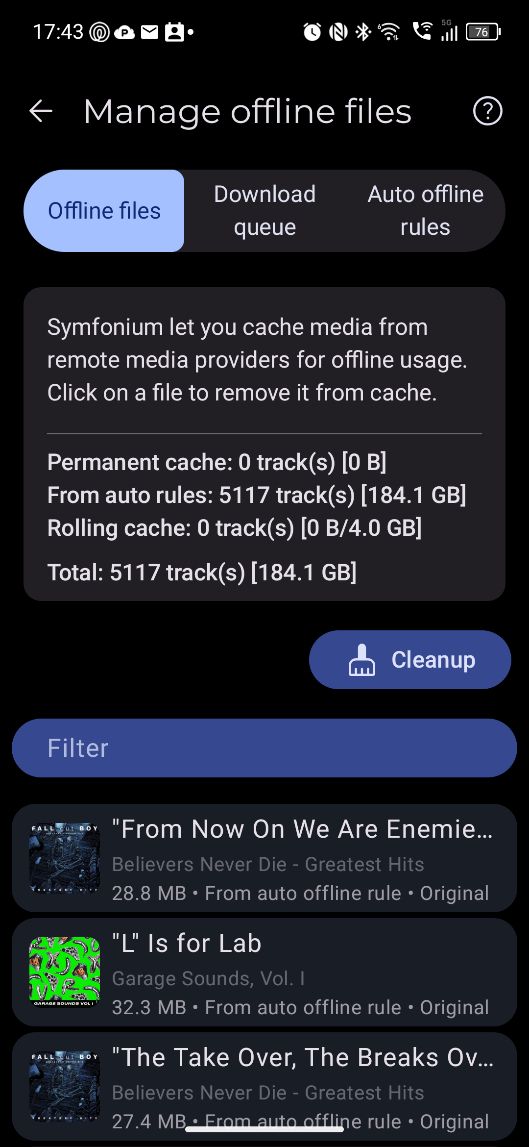

Hi, Thanks for the response. I’ve changed the way to sync my library and did as you suggested.
Unfortunately, I still have the strange missing track on the “Manage offline files” page (showing 5117). If I create a smart playlist and show “is cached” it says 5118 and if I create one and show “is not cached” there is nothing listed (see screenshots).
Any idea why the “Managed offline files” is only showing 5117 tracks?
You probably have a duplicate track with the same path reported by Navidrome. You can enable the option in navidrome to report the real path to fix, but you’ll need to download all again.
