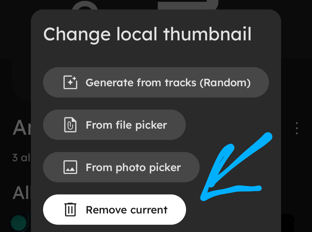

As for the images, I had also included two images files that are used for the fanart and artist photo inside of the folder. What I did to get them to show properly was by changing the local thumbnail and removing the current images that were being used.
I hope someone else will find this helpful in the future!
