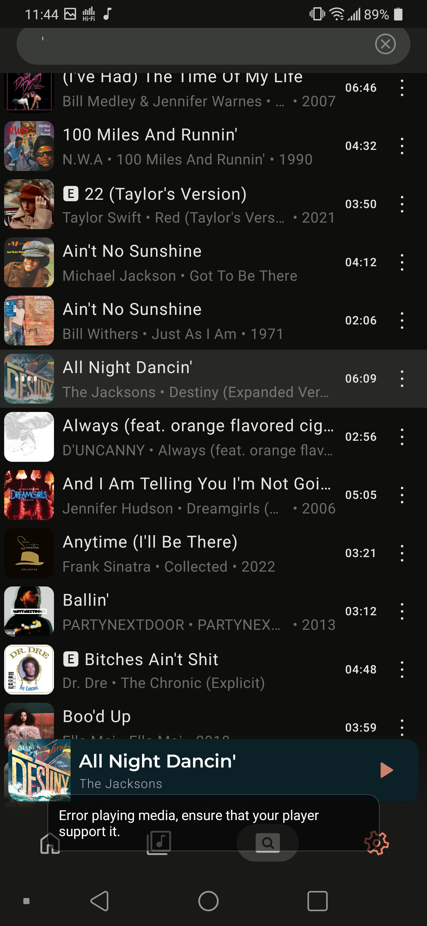

Tracks with " ' " in .WAV format causing error when casting
Almost every track in my library that has an apostrophes (') causes the “Error playing media, ensure that your player support it” message. These same tracks play perfectly fine locally through Sympfonium and while casting through other apps. However, when I try to cast through Sympfonium to my silent angel m1t streamer, the message occurs.
I have rescanned my library multiple times but still the same tracks
