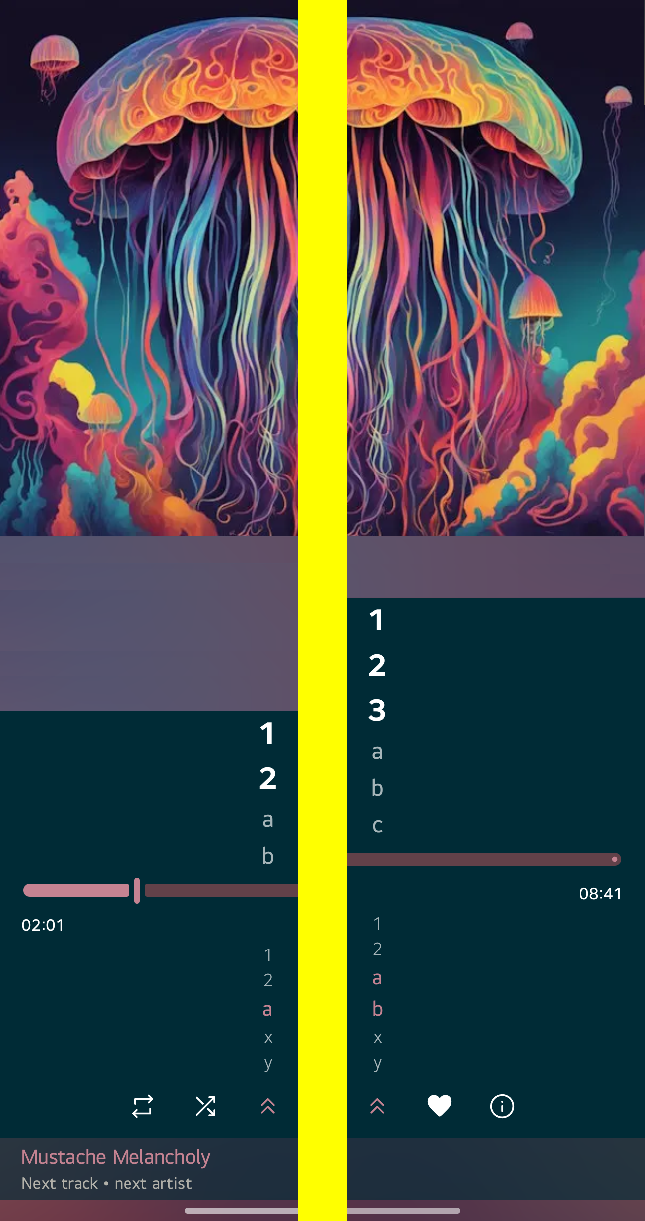

Pic 1: current behavior, all margins at zero. Artwork is centered inside the space available to it. As information size changes, so does artwork position.

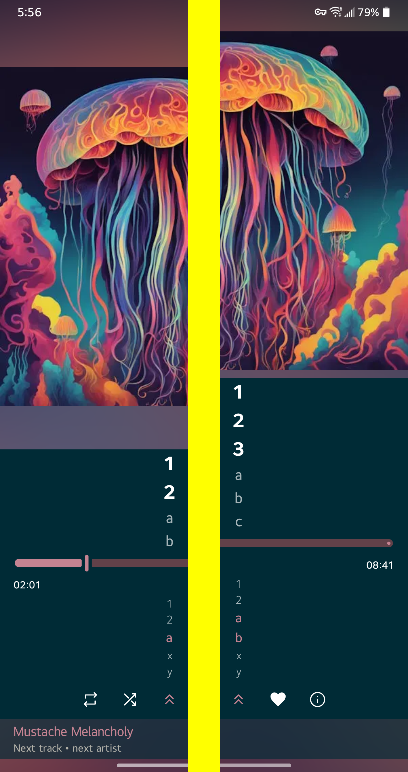

Pic 2: current behavior, bottom margin set to 75 – chosen so the artwork just barely hits the top of my screen in the left-hand layout. This anchors the artwork to the top, yes, but at the cost of shrinking the overall size of the artwork in order to maintain the art’s aspect ratio AND the 75pt margin. (Red section is cropped from left/right and aligned to show that bottom margin is identical.)
If the margin was chosen for the right-hand layout to be pushed to the top edge, then the left-hand layout would still have extra space in which to center the art, causing a shift in alignment again. Thus, setting margins is not an ideal solution to this problem.
Pic 3: desired behavior, all margins set to zero. Artwork is always at the top, allowing the lower panel to consume the blank space WITHOUT resizing the artwork. Once all blank space is consumed, only then will album art be scaled down.

This is only the case if you set the cover style to fill size. If you don’t the cover will always be at the top as expected.
Yup, it really was that simple. That also solved my mystery of the Controls’ “Row Vertical alignment” seeming not to do anything–the art was filling the whole space. Sorry for missing an obvious setting, but thank you for the help!
