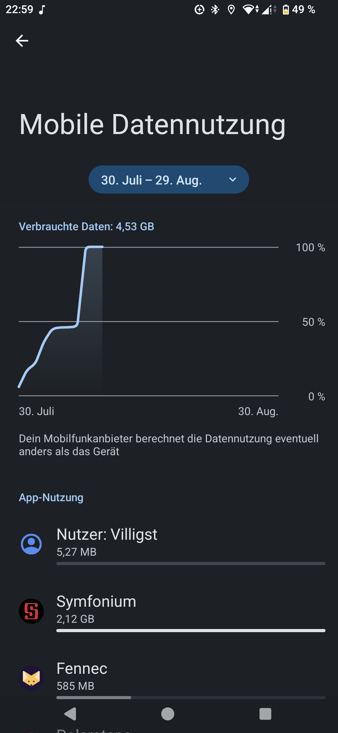

Data and battery drain. One of these unwanted syncs used ~2 GB of my mobile data quota, which is more than I normally use in a whole month. The repeated syncing also drains the battery noticeably. This would is a serious problem while travelling.

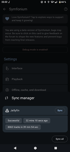

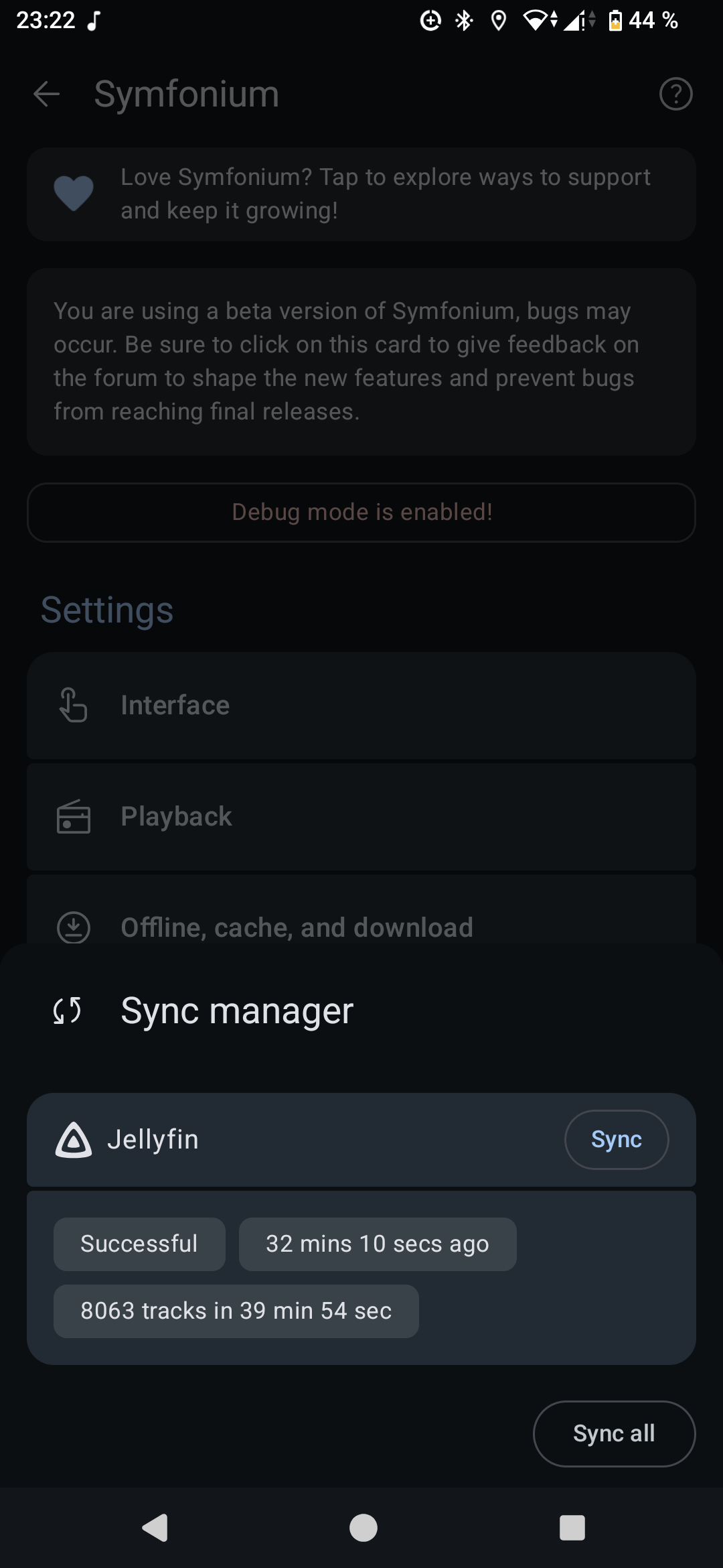

Partial syncs replace my library. My library has ~120,000 tracks and a full sync legitimately takes several hours, that is fine. What is not fine is that the sync restarts from scratch every few minutes. If I don’t notice and cancel it in time and the sync gets interrupted after it has only imported a few thousand tracks, and then only those tracks are visible in the app. In the screenshot the provider shows “8063 tracks”, which is a small fraction of my actual library.

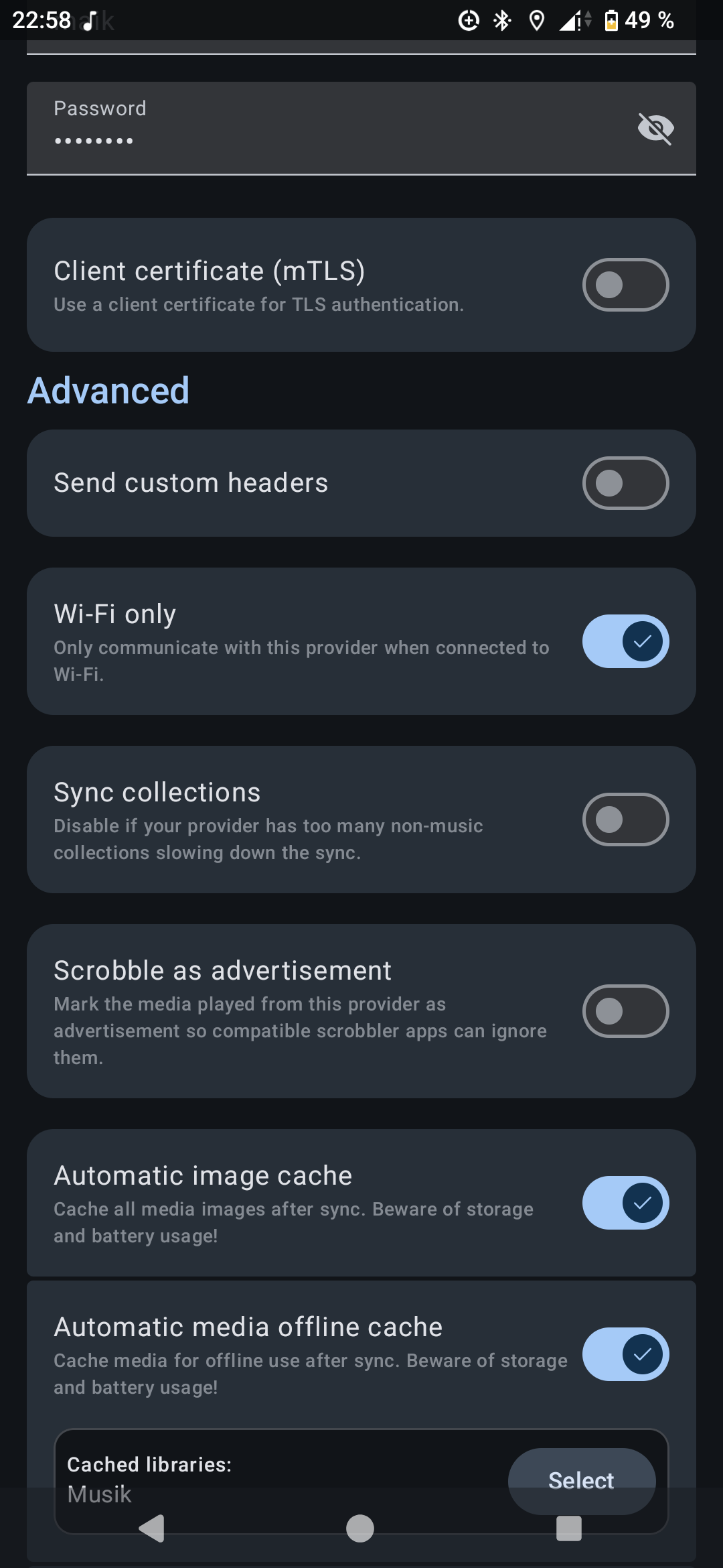

  3. Disable sync for this provider in the provider’s advanced settings.

You did not disable automatic sync … There’s no such setting in the provider, it’s in Library settings.
