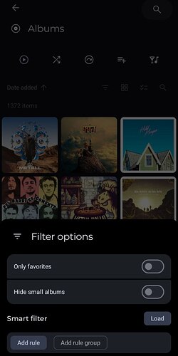

Hi, I installed and paid for the app a few days ago to be able to play the media I have in my airsonic-advanced server (which uses the Subsonic API), and I realised the sync process does not seem to fetch metadata about albums that I starred in the past from the airsonic webUI.

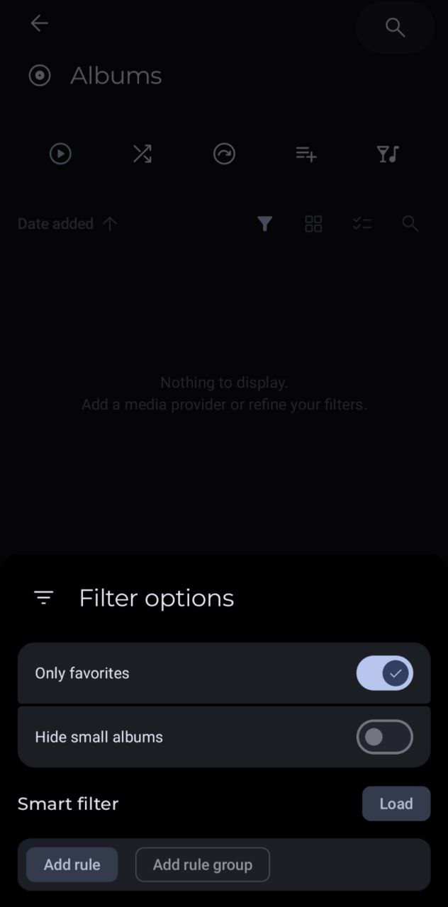

I found this issue when navigating to Library/Albums in Symfonium and filtering by “Only favorites” - the results are empty. It works fine for starred tracks though, I can see them with the same filter from Library/Tracks.

Symfonium use getStarred2 and there’s no such thing as a type parameter on either calls :wink:
Interesting! I checked the getStarred2 endpoint in my server and indeed starred albums aren’t returned there - I’ll investigate why is that the case, and whether I need to tweak/update my server.
The thing about the type parameter… that explains why I was also getting stuff that weren’t albums :laughing:
Thanks for the help! I think this can be closed now :folded_hands: (I’ll come back if I’m able to fix it on the server side)
I migrated my server from Airsonic-Advanced to Navidrome and I can now see all starred items: artists, albums, and songs :slight_smile:
