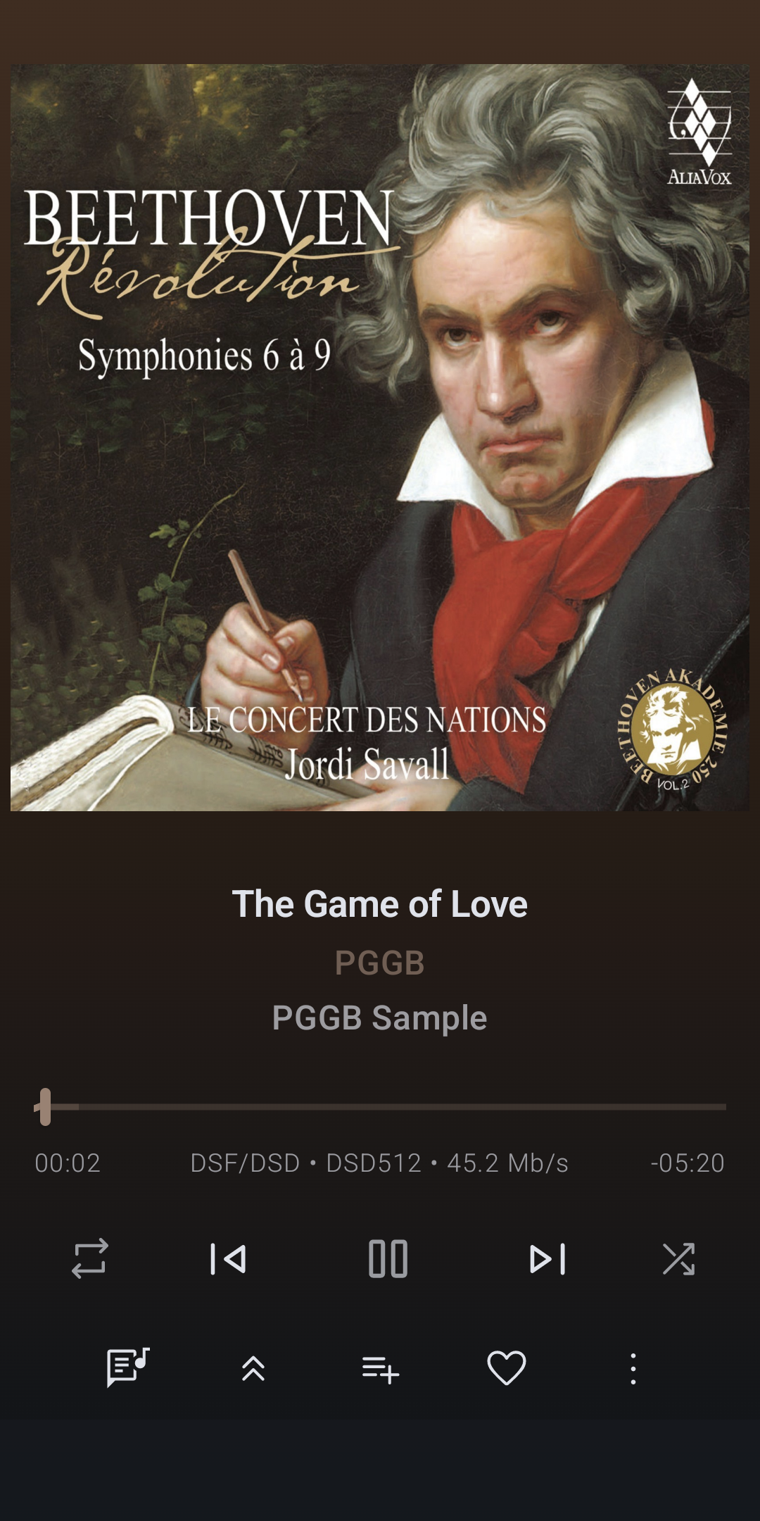

Fiio m27 & DSD files.

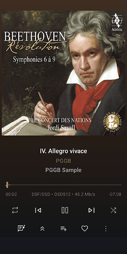

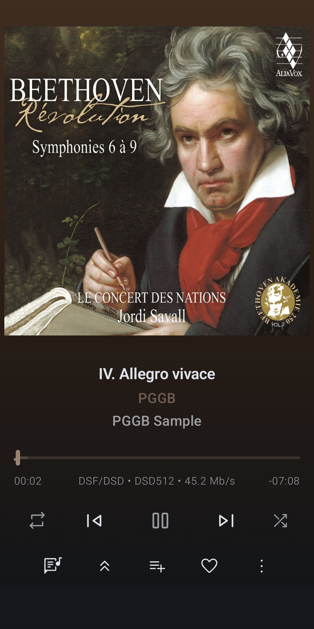

You say can’t play but the screenshot shows them play.

It seems to try to read but there is no sound. The sound I could hear is not musique. No sound silence.

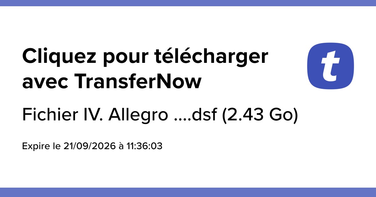

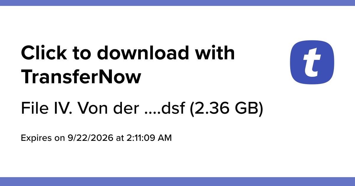

Here a link to download it :
Hum works here, it’s only with dsd512 ? All dsd 512 of just some ? Can you try the 15.1 beta see changlog for download links.

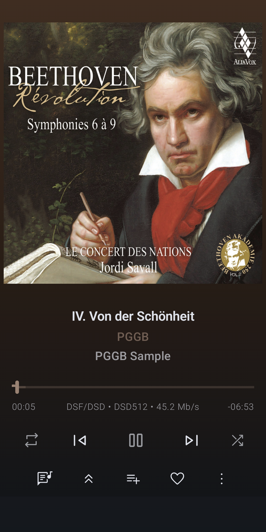

Other DSD files with same pbm :
These are the only DSD 512 files I have. And all of them have issues to be played on fiio m27. These files work weel under uapp and native music app of fiio too.
