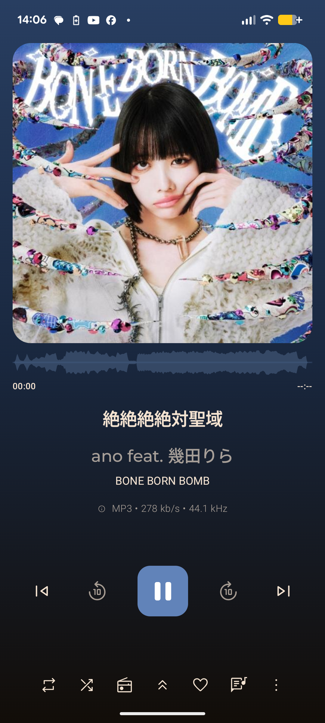

I noticed that when playing on upnp, the end time just say --:–
When I select it to play locally (note: I didn’t include the local device in the media provider, subsonic is the only provider), the end time is displayed correctly with “speed 1x”

I think I noticed the pattern, most of the time, it appears to manifest only on the last song of the album. And in my original example, I only bought a single song from the album so it also happens to be the only and “last” song of that album. It doesn’t appear to matter if it’s mp3, flac or aac.
