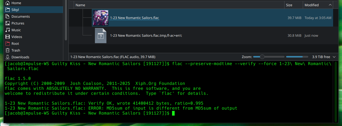

Interesting, perhaps that has changed in the more recent flac versions. I recall re-compression failing because of mismatched md5 in 1.4.3 and 1.5.0 but I don’t have a test flac file to verify at the moment.
@655321 is correct that an extra step is needed with newer versions of flac. @Tolriq’s output shows he’s using flac 1.3.3. I’m using Arch with flac 1.5.0. This is what happens when I run the command that @Tolriq provided with no modifications:
1-23 New Romantic Sailors.flac: ERROR: MD5sum of input is different from MD5sum of output
flac decodes the old file fine and encodes a new file, but it doesn’t overwrite the old file in-place because it detects that the MD5 hashes don’t match (since the old hash was wrong in the first place for the stream that’s actually there).
--decode-through-errors does not seem to do anything to affect this, though (presumably because the problem is happening when comparing hashes after the new encode, not during the old decode). To be clear, I do still end up with the new file in a temporary location, and I can just delete the old one and rename the new one manually, so this still works as a workaround.
