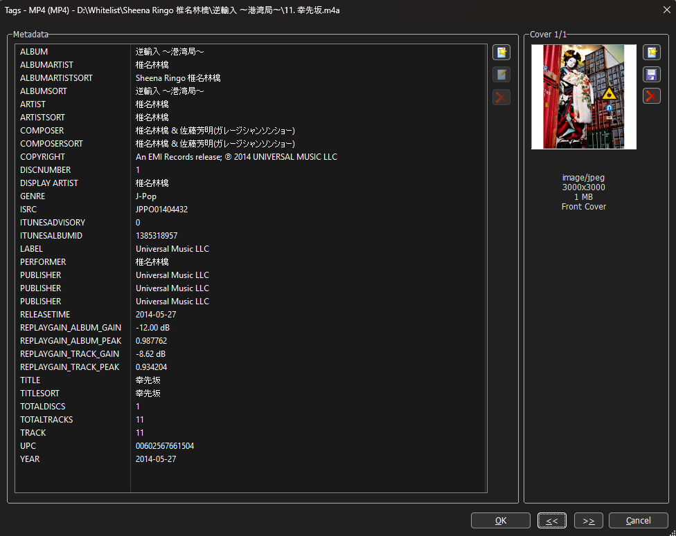

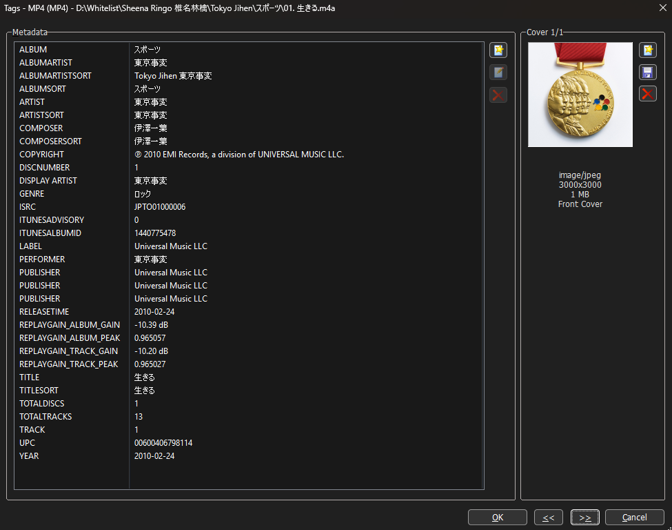

I am putting English names in front of my Japanese and Chinese artists so that they can be sorted in Alphabetical order. 95% of my albumartistsort tags are working as intended, but there are quite a few artists despite having the albumartistsort in the tag, does not sort accordingly and ended up at the very bottom of the album artist page.
Attaching screenshots as an example. While both Sheena Ringo and Tokyo Jihen both has the similar tagging, Tokyo Jihen was sorted properly to the alphabetical order but Sheena Ringo did not.
Have already tried clearing cache/ all the tags and resync. Same issue prevails.

Ho oups you have the wrong Artist sort … (And on many other files)
