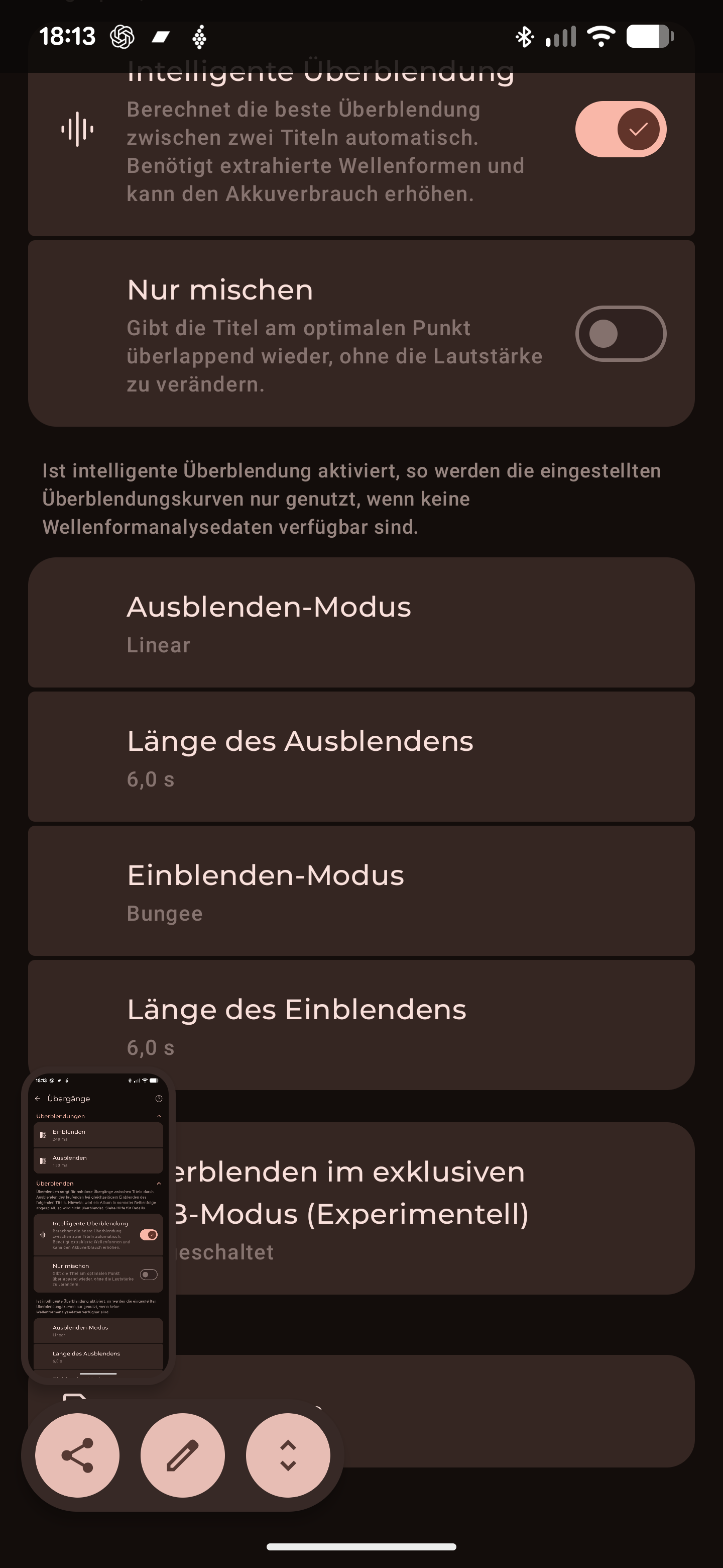

I originally encountered the issue with 15.0.1. I also tested with Smart Crossfade disabled and a fixed 6-second crossfade, but no crossfade occurred either.

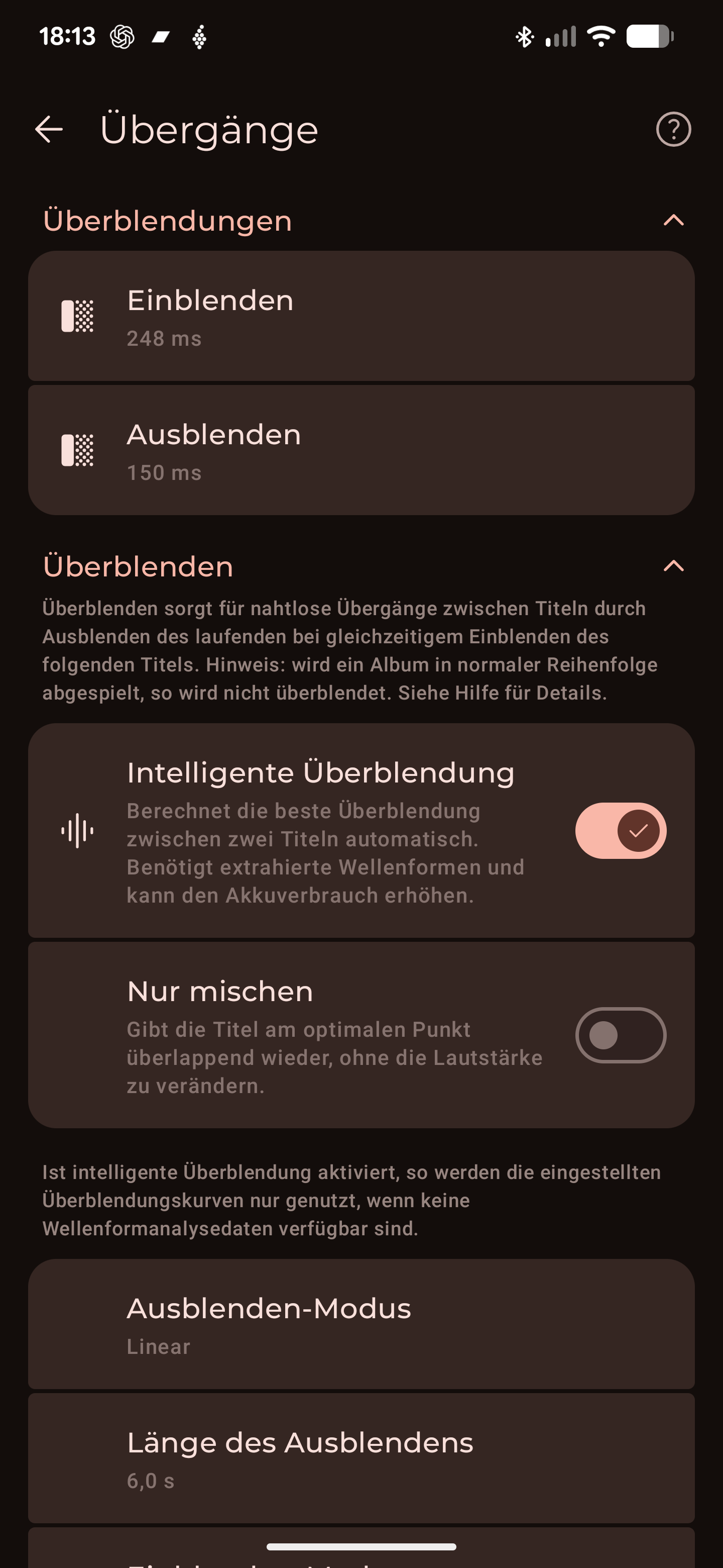

  1. Enable Smart Crossfade in Settings → Playback → Transitions.

As an additional test under 15.0.1, I disabled Smart Crossfade and configured a normal fixed 6-second crossfade. That did not crossfade either.

Your logs show that the queue is still marked as album playback, which disables both smart and fixed crossfade. Adding songs from other albums to that queue can preserve this mode.
Please start a fresh queue using Play from Songs or a song playlist, then let two tracks transition automatically. If crossfade still fails, capture that test with debug logging enabled before starting playback.
