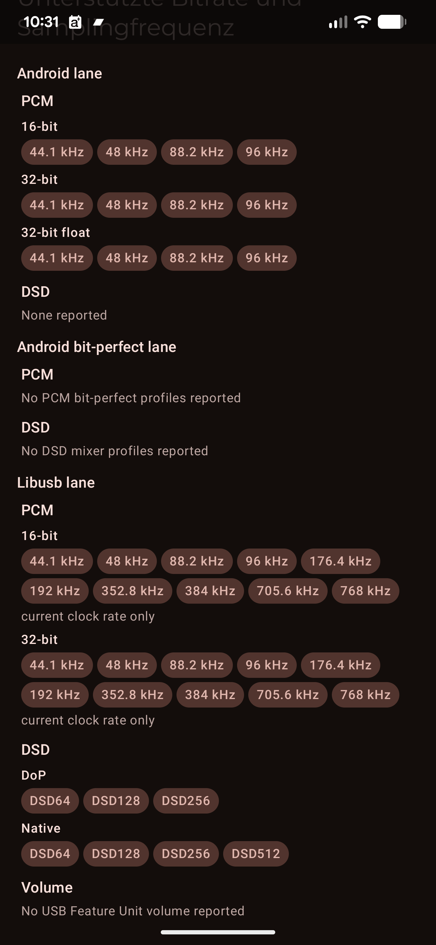

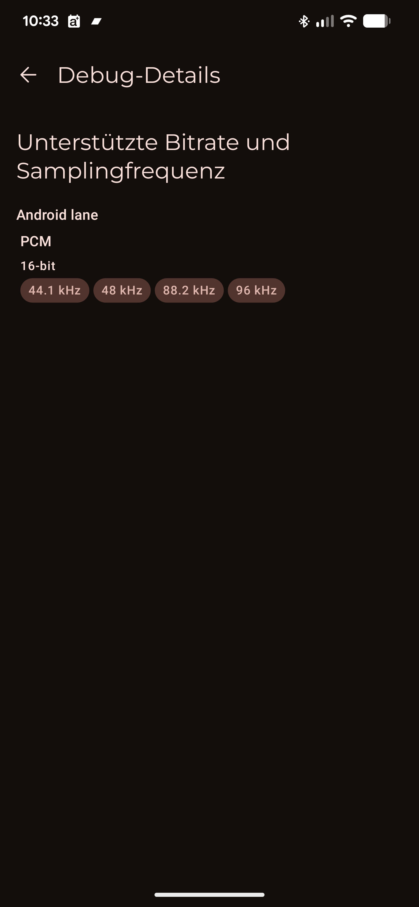

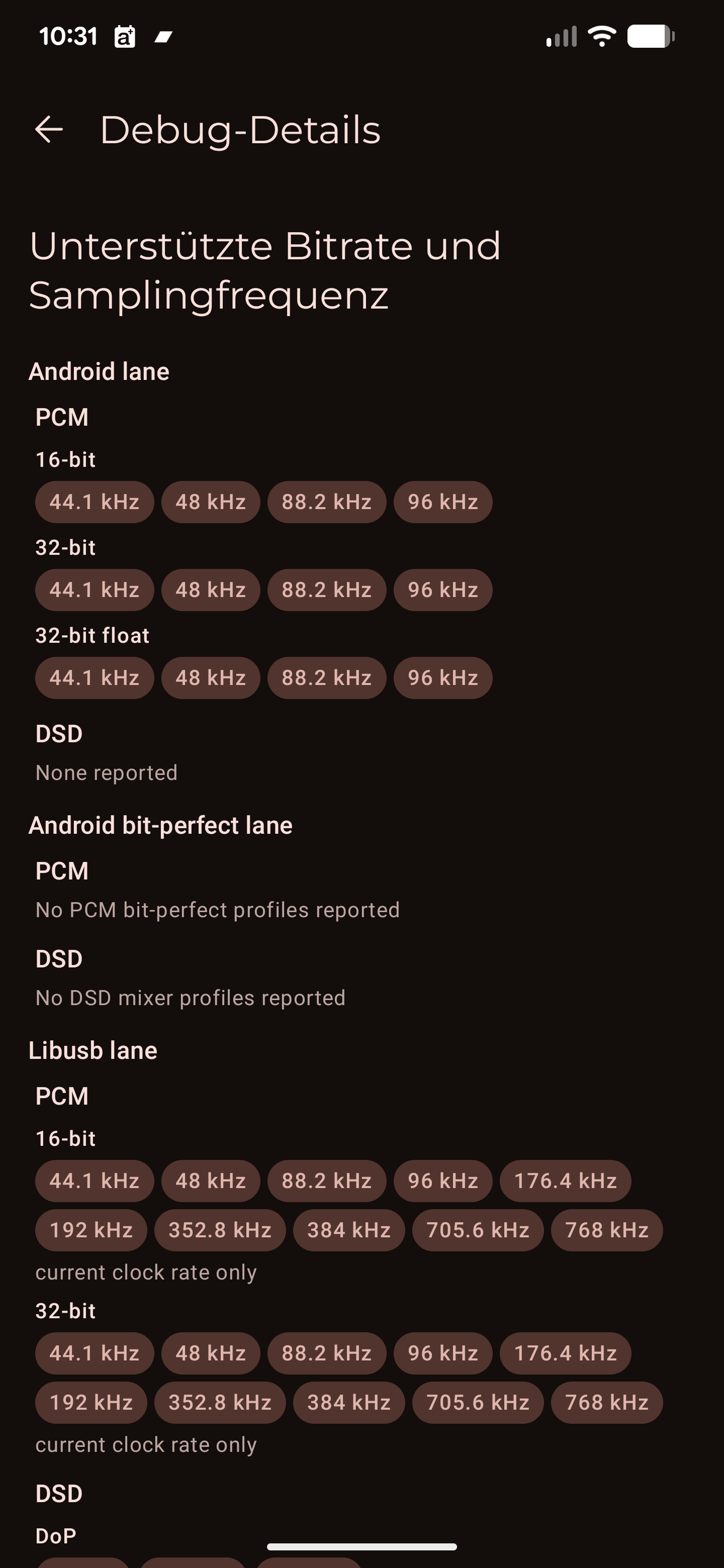

Tested with a FiiO BTR17 on Symfonium 15.0.0. The device is currently identified as a single output regardless of whether it is connected via Bluetooth or USB DAC.
Please upload logs when connecting in both modes and each time opening the debug details screen in the output section and tell me the description value so I can look when back.
I just uploaded two logs. The first one is from the BTR17 connected via a USB cable in USB DAC mode. The second one is from the BTR17 connected via Bluetooth (LDAC codec).
Screenshots 1 and 2 are from USB DAC mode; screenshot 3 is from Bluetooth mode.
