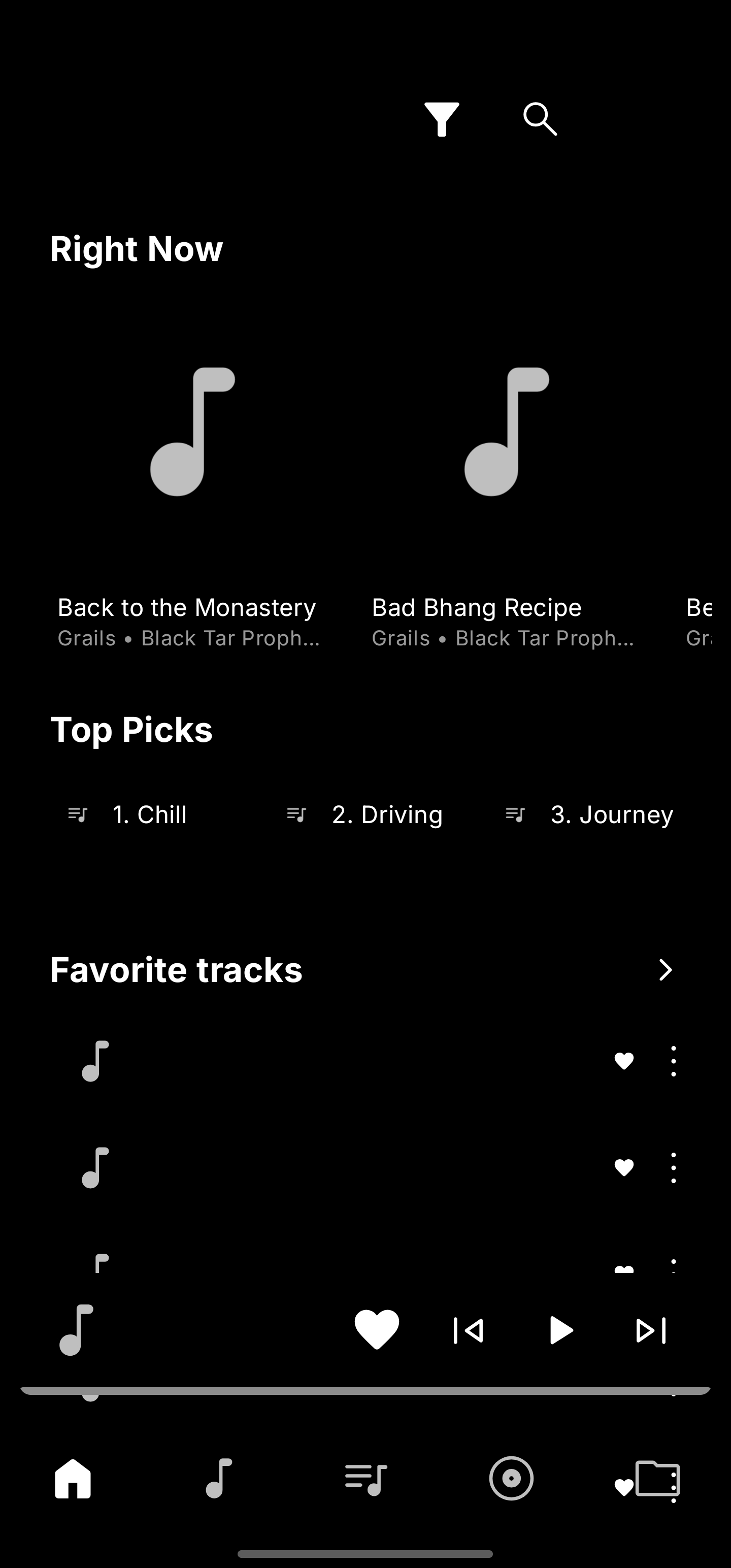

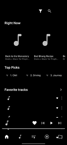

After uninstalling and reinstalling the app to clear up a massive storage issue (the app data had ballooned to 234GB however odd not have any offline downloads), I restored my backup but cannot get my “Favorites” (hearts) and user data to map to my actual local audio files. All tracks are stuck as unplayable “ghost” tracks.
Created a full backup (including User Data and All media entries).
Uninstalled and reinstalled Symfonium to clear the storage cache.
Restored the backup.
Because the reinstall revoked Android’s SAF folder access, my “Local device” provider showed “None” for files, however when syncing it scans all music. Also multiple playlists are showing playable tracks.
I went into the Local Device provider, remov seeed the dead folder paths, and re-added the exact same three local folders to grant fresh SAF permissions.
Ran a full sync.

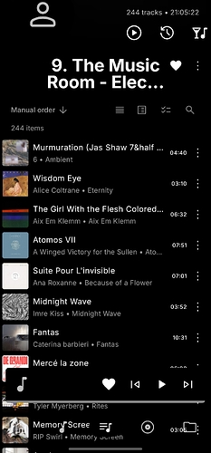

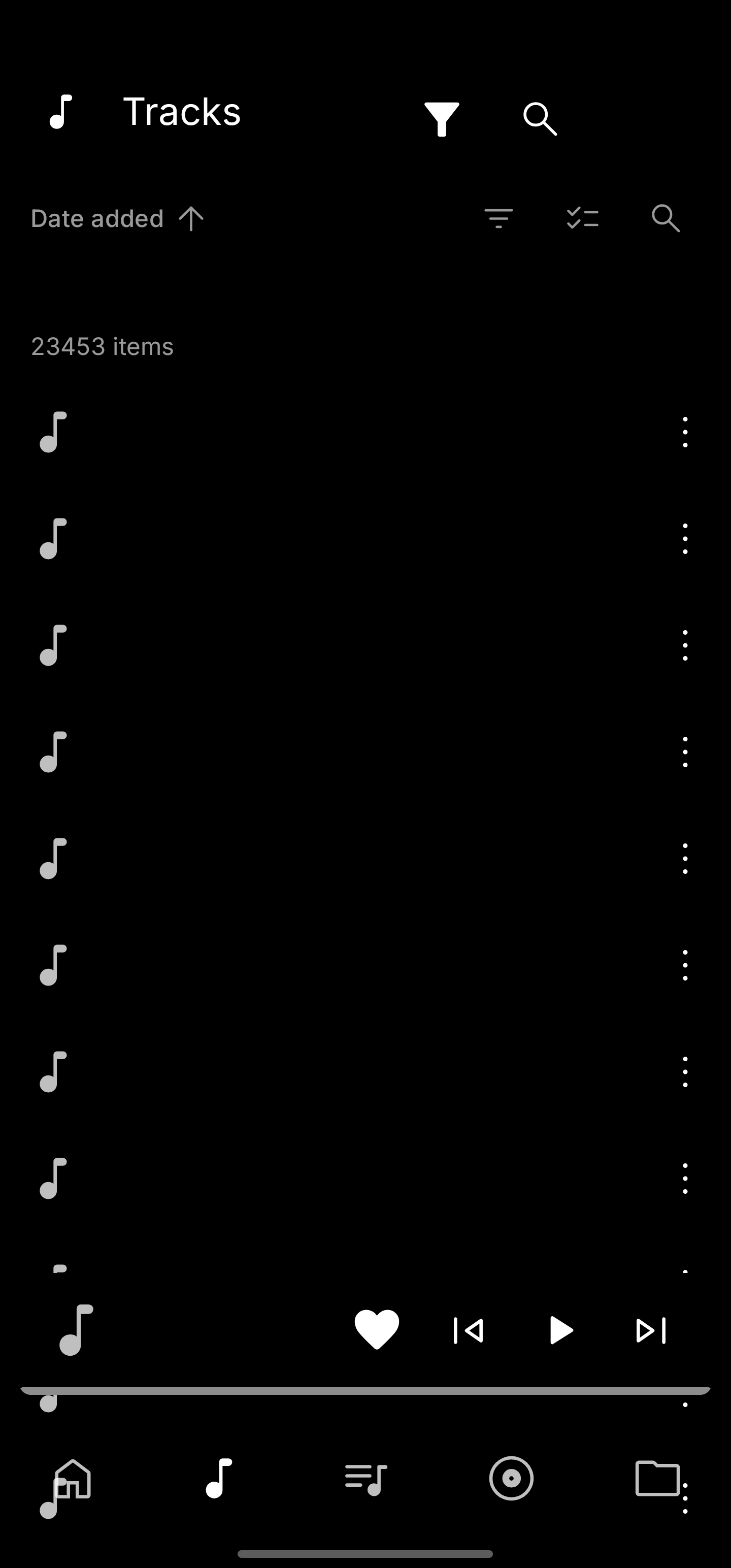

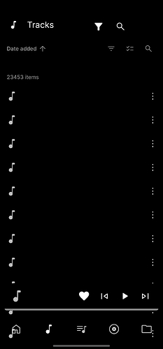

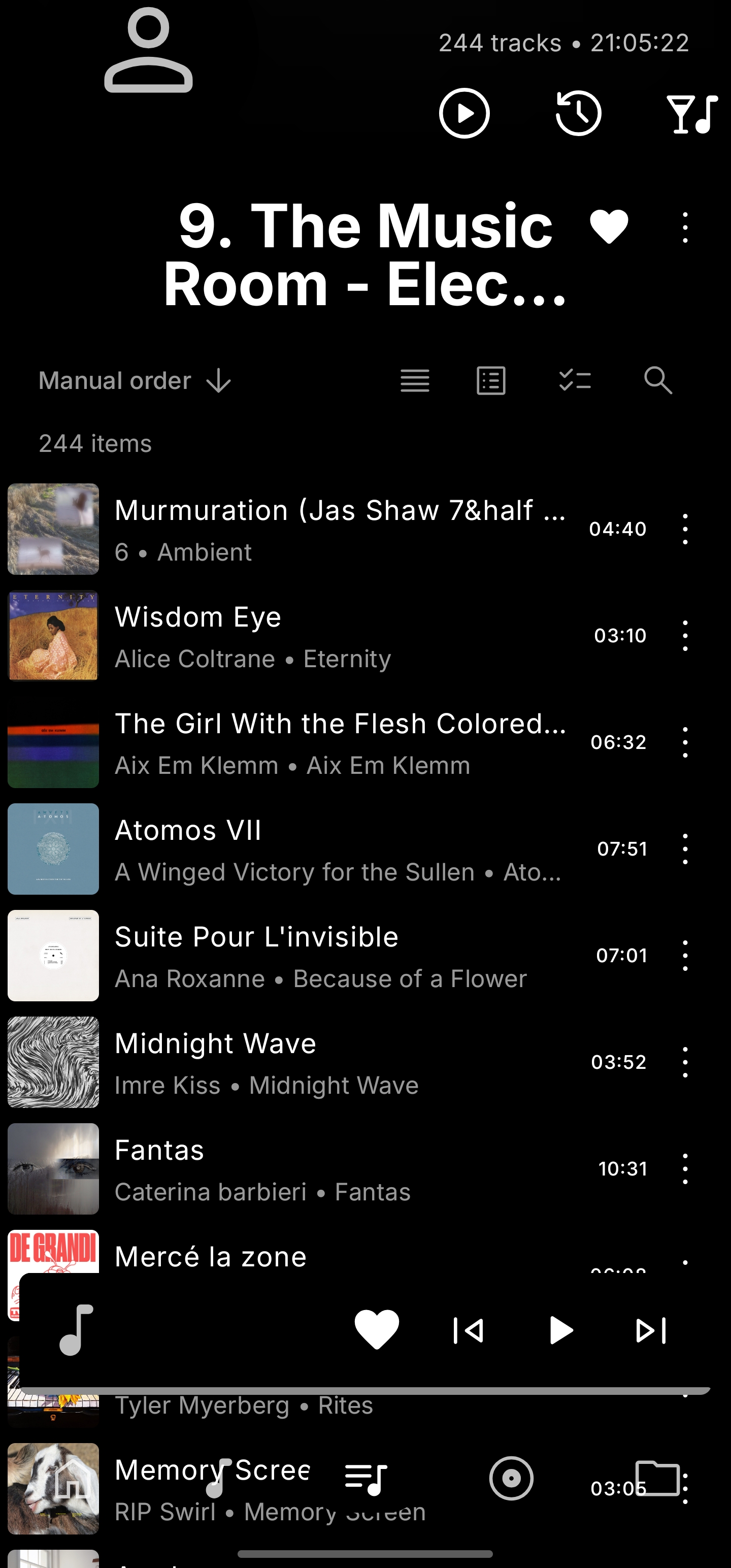

The sync pulled songs from my custom playlists. However All other tracks entries appear to be ghost entries.
I have ensure symfonium has all permissions
