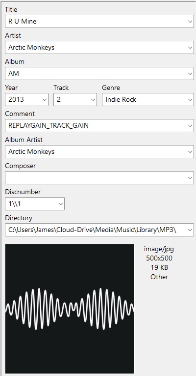

I have tried tagging the mp3 files per the screenshot, I may have done it incorrect but I am not sure.

Sorry, had to make the joke. But you can’t just add “RG Me Plz” in the track’s comment and expect the app to take over. :laughing: It doesn’t work that way, it’s not a simple toggle.
To get it to work, you need a tag field called REPLAYGAIN_TRACK_GAIN and in that field should be a numerical value that tells the app how to adjust the volume.

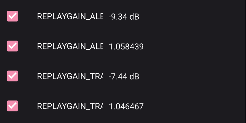

Here’s what my tags look like for a random track:
There’s four relevant fields. (Sorry for it being cut off, this app is ancient.) Track Gain, Track Peak, Album Gain, Album Peak.
The values are not something you guess or figure by hand. Look for a software like rsgain and run it on your files to generate these for your library.
