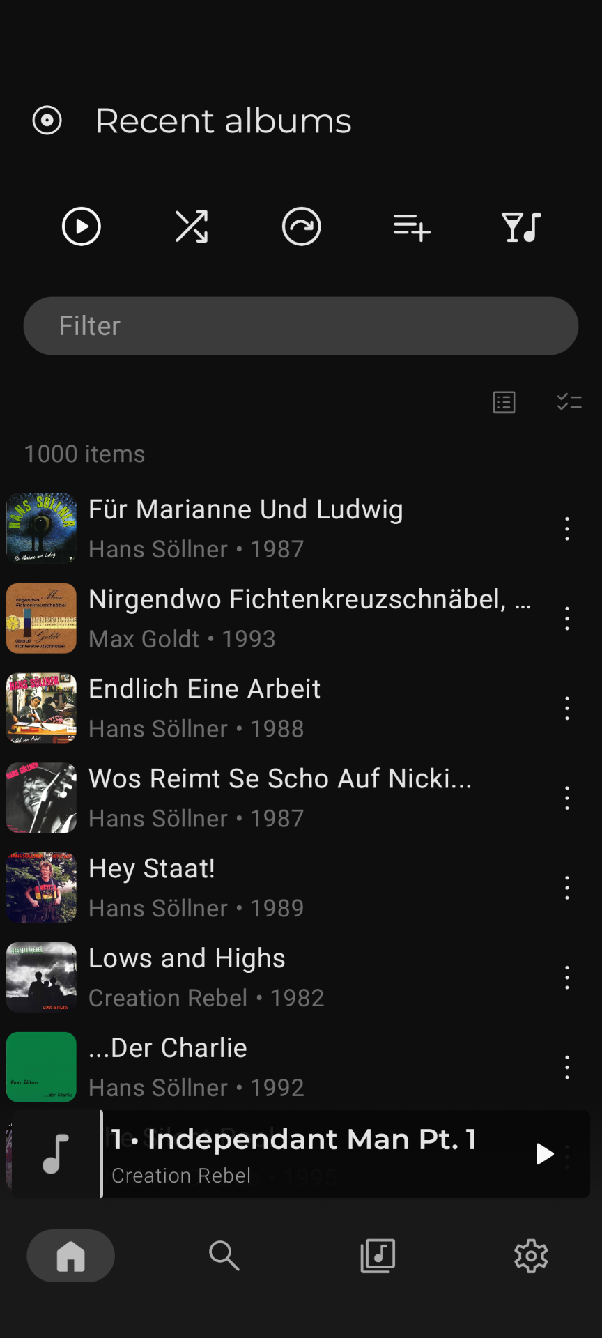

I did setup a Navidrome Server with mostly perfect tagged files. All seams to work fine except one strange behaviour. The Albums shown in “Recent Albums” are all much older. Some even from the 80’s. All my flac (98%) and mp3 (2%) do have a propper filled date tag in the YYYY format. All other date related tags are deleted (e.g. releasedate, originaldate, etc. pp). Funny part is, when I use the same files for a jellyfin database Symfonium does show them in the right sort order. Same applies when I use Navidrome + Feishin App on my Desktop. When I go in Symfonium to “All Albums” and sort based on Added I see the same sort order than given in Recent Albums view. Why is Navidrome fetching the added date and not the “date” tag itself…

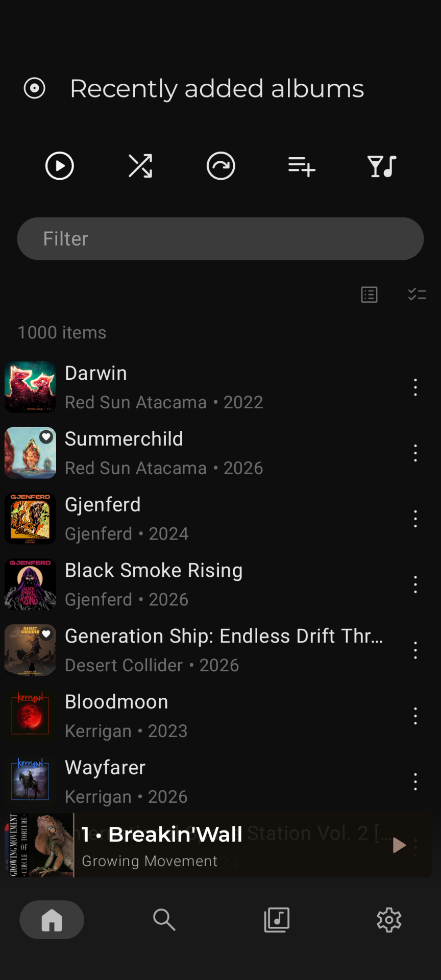

Attached also a picture, just to show that I do have newer Albums :wink:

Setup Navidrome and sync with Symfonium. Than head to recent albums and check sort order…

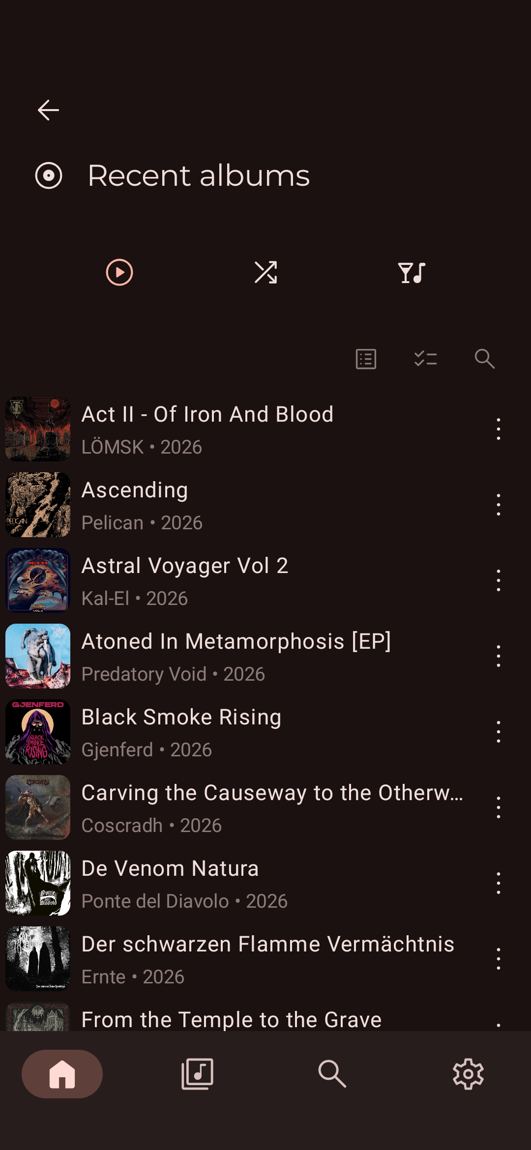

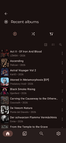

Below a screenshot where you see that Symfonium handles the date tag with jellyfin as I would expect. Since Jellyfin is very heavy on my DIY server I really would like to stay with Navidrome.
