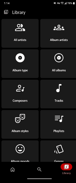

This, I can still reproduce. I’ve uploaded an extra log as Celorien_QueueLoad_Swipe in case it is needed.
I had my swipe action set to “Queue” rather than “Play Next” and had the same behavior. The other swipe actions work fine (since they don’t affect the queue).
Note: I could only reproduce consistently when first loading the app. After stopping the broken queue, the issue does not reoccur for me unless I reload the app. (Swiped it out of Recents, didn’t need to force close.)
20260909_131651
