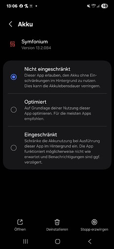

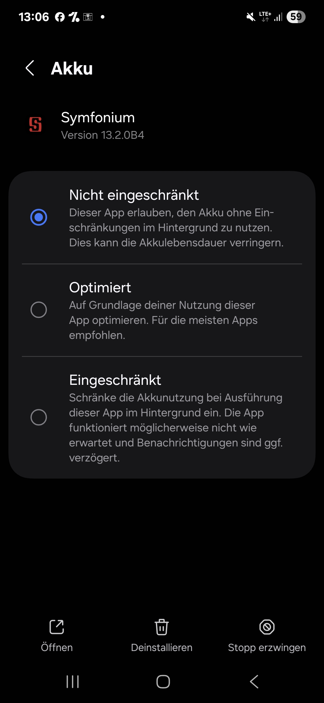

Moreover, in the settings the app has this setting regarding battery options:
Please provide proper logs showing just that.
