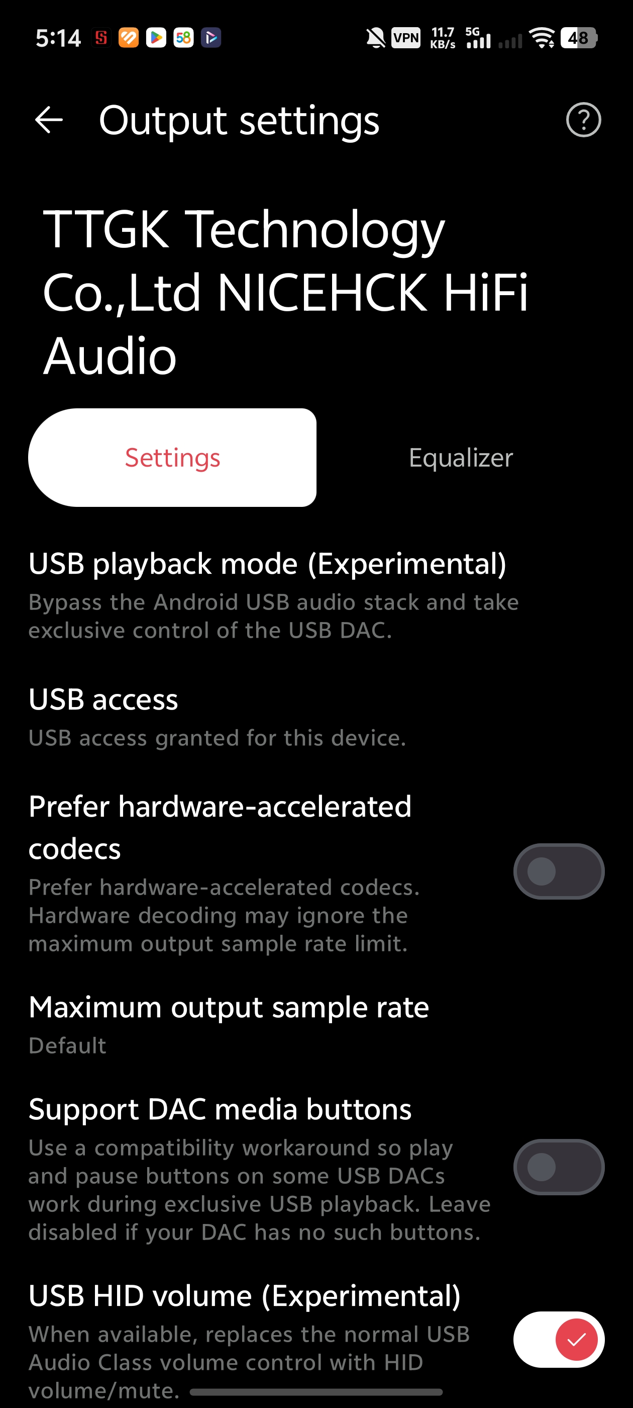

While Switching between apps (any apps), the playback stops for 1-2s when the app opens. I’m using USB exclusive mode.
My device: Vivo x100s
Dac: nicehck nk1
Navidrome

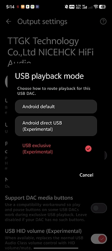

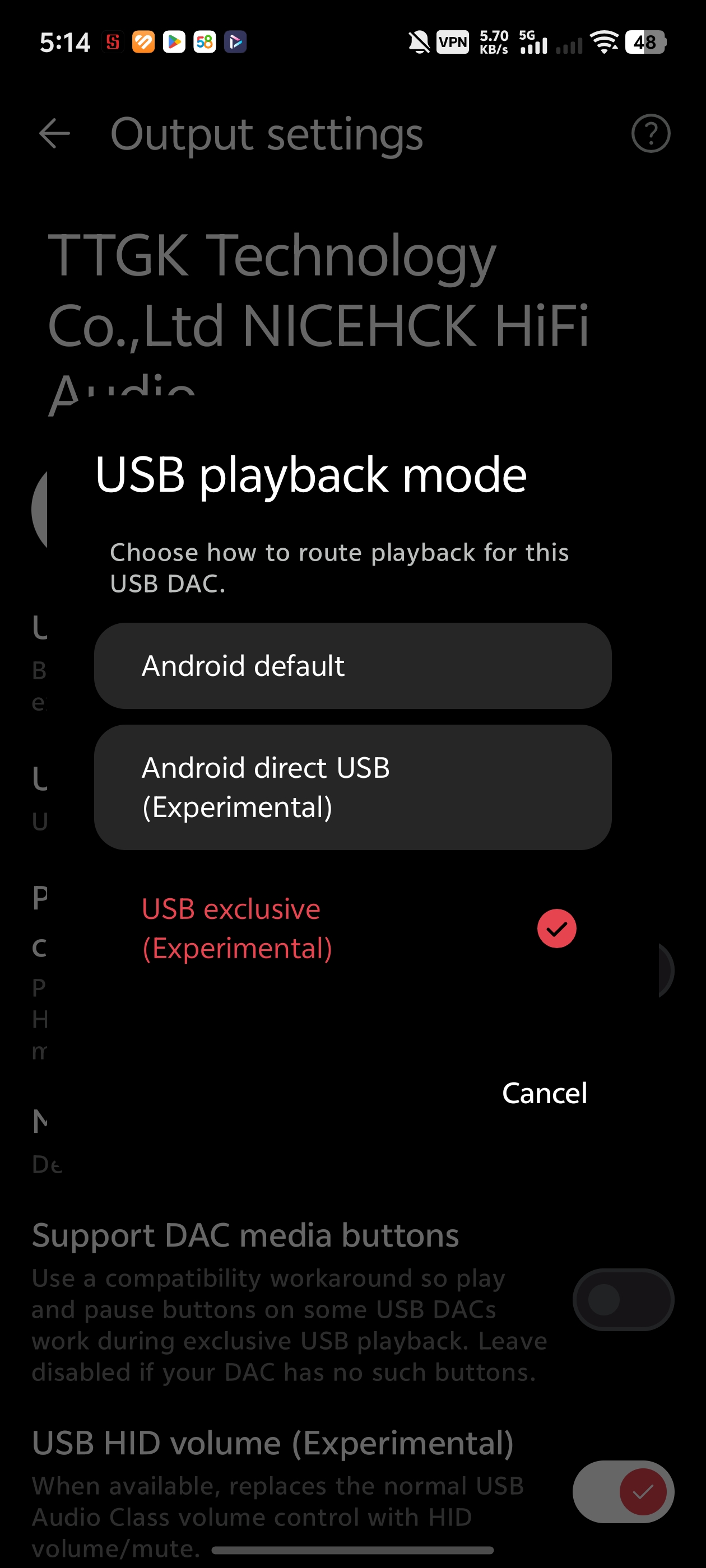

  1. Enable USB Exclusive mode on playback settings.
  2. Play a song from navidrome server.
  3. Minimize symfonium and open another (any app) app.
  4. 1-2 second lag and then playback starts again.
