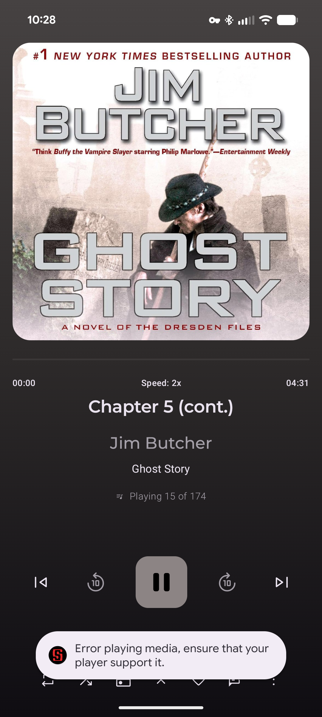

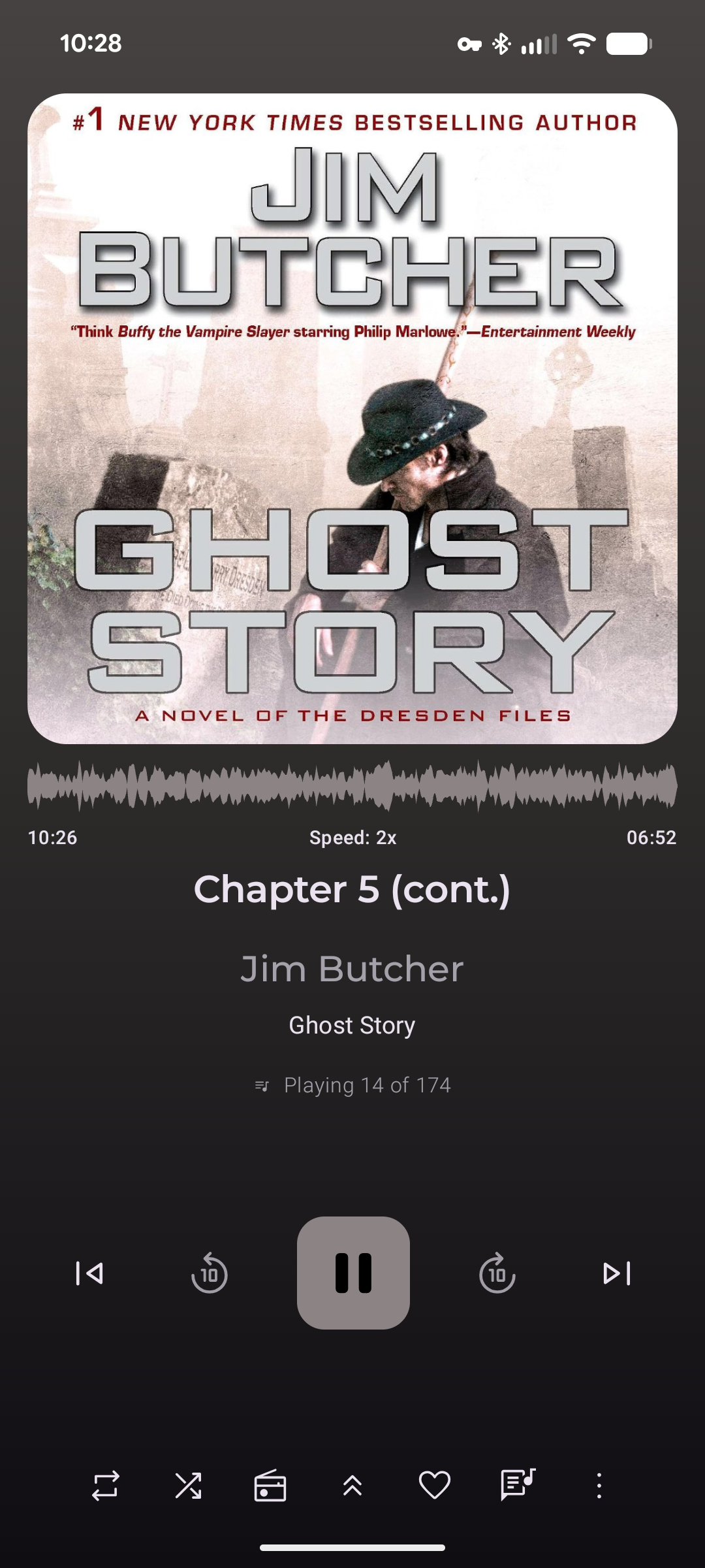

When listening to audiobooks at speeds over 1x (I’ve tested 1.5x, 2x, 3x) it seems like playback desync’s between the timeline and the actual audio. It seems like the tracked duration is off by the multiplier (e.g. 6m into a 12m track at 2x shows as 12m). Something about this also seems to cause the player to forcibly advance before the end of the actual track, though the exact amount seems more or less random.

  1. Open a track that’s ~5m long.
  2. Set the playback speed to 3x.
  3. Hit play for 50s, the timeline should be at 50%, but will instead be at 7.5m and past 100%.
Attached two screenshots, one of the timeline problem, one of the error after skip (should be in the debug logs as well, hopefully).
