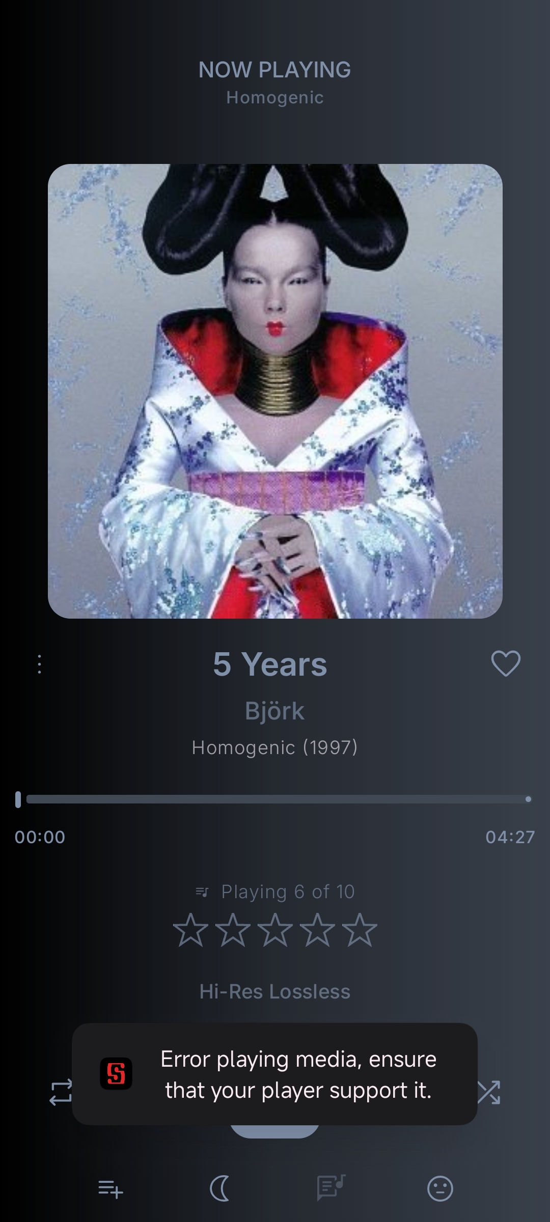

Symfonium has been experiencing issues when I use it with my Jcally JM6 Pro DAC. After pausing a track, when I resume playback, the track doesn’t play and then an error occurs, causing it to skip to the next song. I’m using Bypass Processing.
The logs are now shared via Symfonium
Open Symfonium
Use the Jcally Jm6 Pro DAC
Play a track
Pause for a few seconds
When playback resumes, the track does not play; an error occurs and it skips to the next track
Estou usando bypass processing

I managed to reproduce the issue and share the logs. It’s titled JazzElysium.
Thanks will be fixed in a future release.
