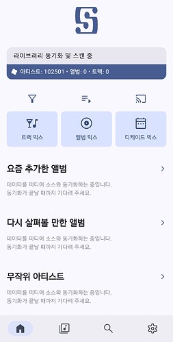

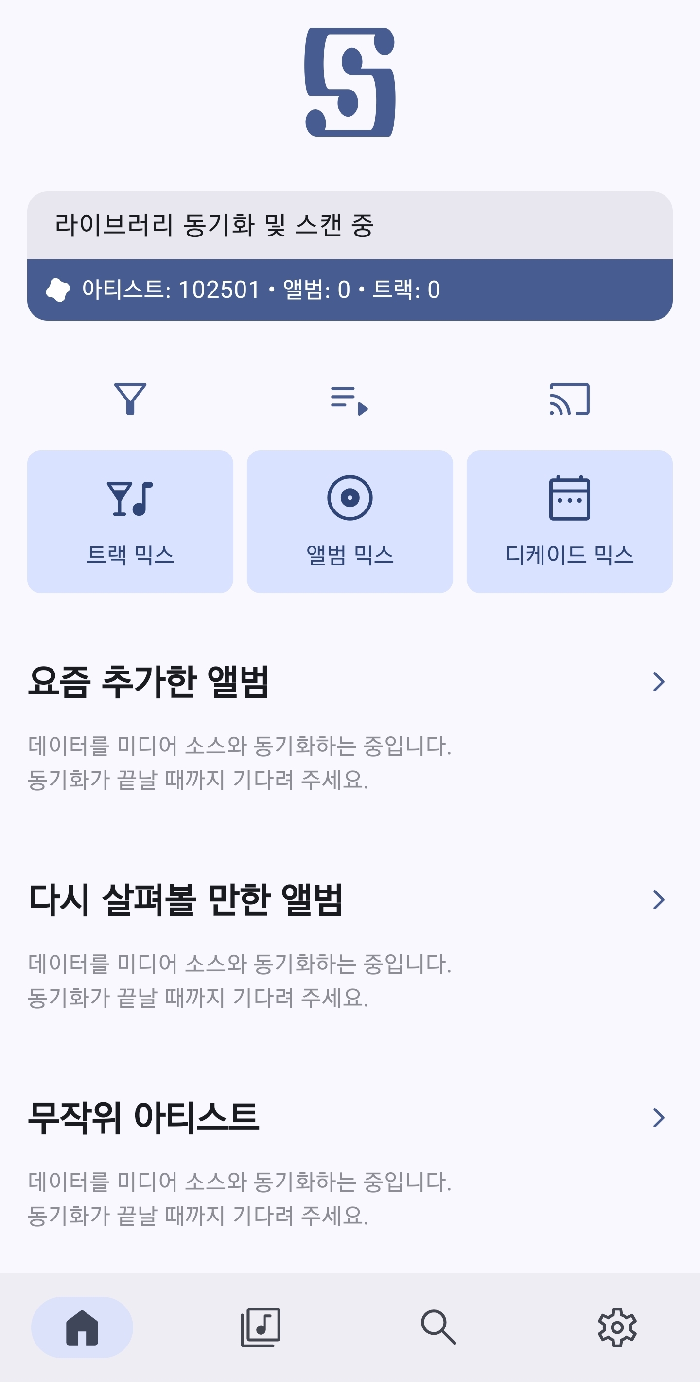

Opensubsonic(ampache) sync, stop at artist index 102501
If I sync opensubsonic(ampache), it stops at artist index 102501. The server side log says it’s still ongoing, but it’s still stuck.

The whole music is about 25TB, so it’s probably right. In the previous version, it synced without any problems, but it’s stopped in sync since yesterday. I woke up and checked and now it’s stopped in the album.
