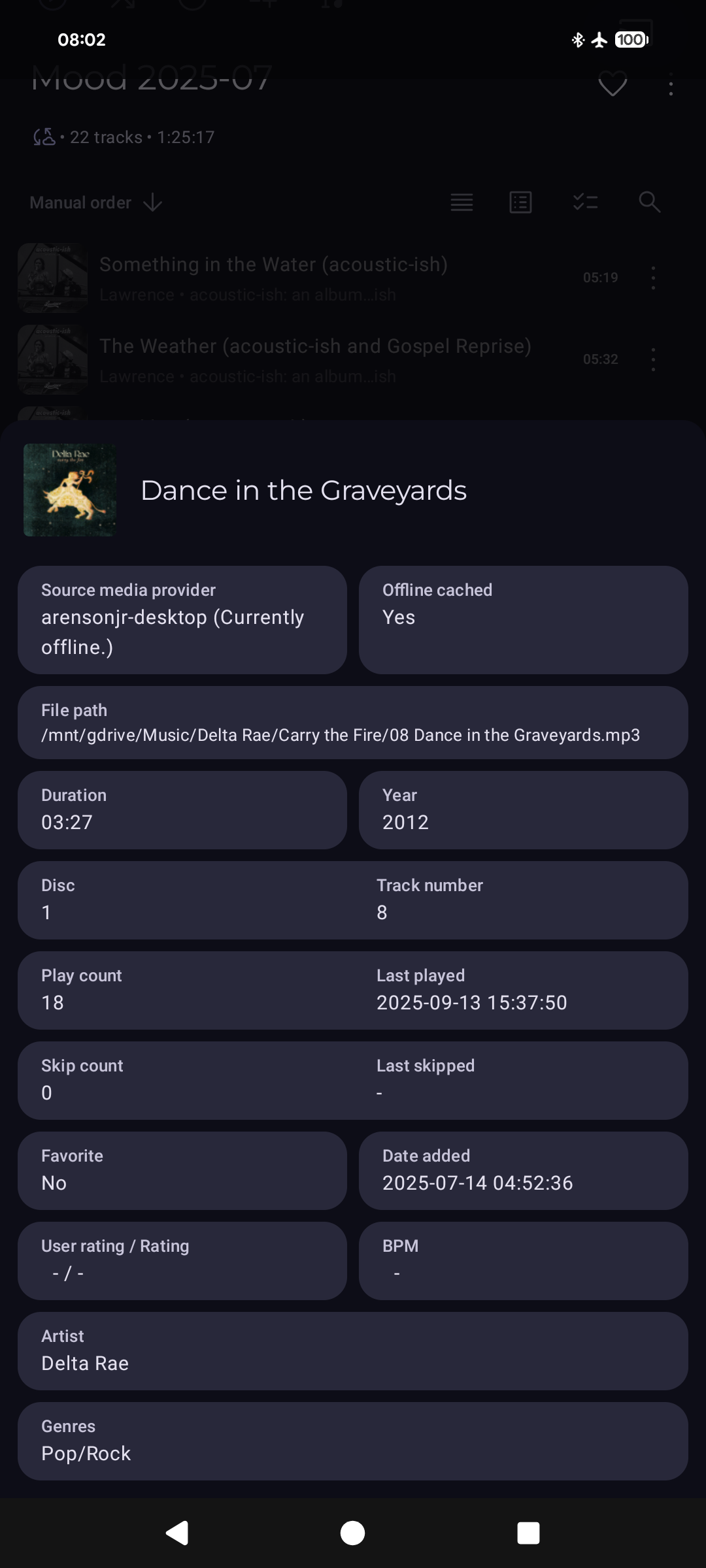

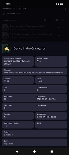

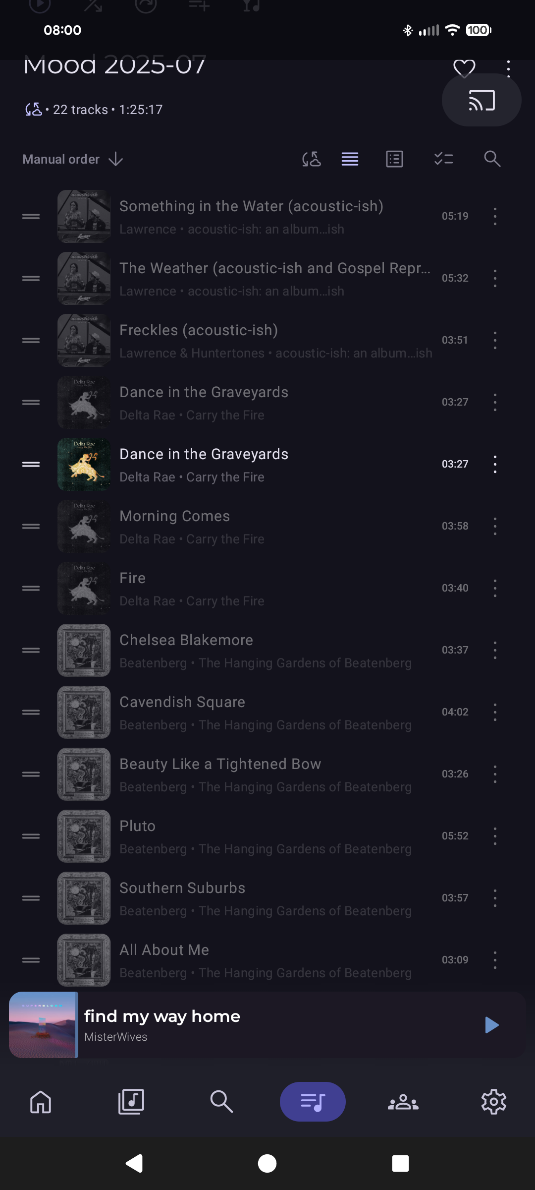

Sometimes (I haven’t noticed a pattern), certain songs – which I can verify on the “Manage offline files” page are available offline – appear as offline in playlists. If I add a new copy of that song to the playlist, it does appear available offline, as if it’s somehow a different copy. However, the triple-dot => details panel for both tracks appear identical, both give the same filepath, both give the same media provider, and both say “Offline cached: Yes”.

I think I’ve figured this out.
At some point in the past year, I moved my Plex server from one machine to another. The library filepaths are slightly different on the new system than they were on the old. Following these steps, I migrated the libraries in Plex itself such that it re-discovered the new files, associated them with the same tracks, and play counts, etc. were maintained.
However, if I export the playlist from Symfonium, I still see the full filepath of the track from my old Plex install.
Some further debugging shows:
  • When I turn on the “Hide media not available offline” filter, these tracks are greyed out, and they’re auto-skipped (if I try to play them, Symfonium instead advances to the next non-greyed-out track).
  • However, if I turn that filter off, then the tracks are no longer greyed-out, and I can play them even while completely offline (airplane mode / wifi off).
It seems like I have two problems here: my playlists contain a “version” of the track with an out-of-date Plex filepath, and Symfonium’s “Hide media not available offline” filter doesn’t use the same logic as whatever is allowing it to otherwise successfully find matching tracks while I’m offline.
