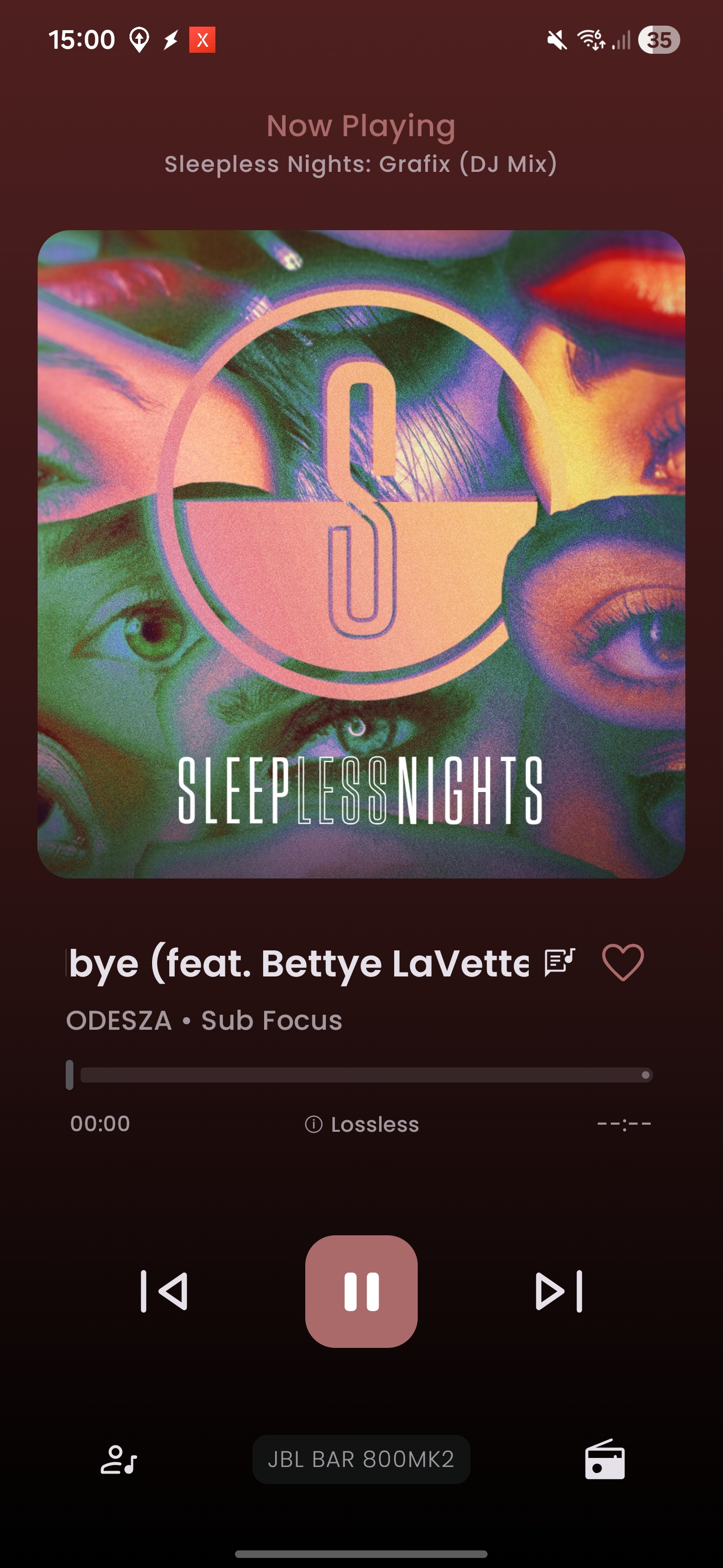

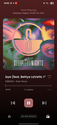

@Tolriq Kindly check new logs uploaded just now. The problem still exists. This time Im listening on my headphones and progress bar end is not showing anything. Will upload screenshot shortly.

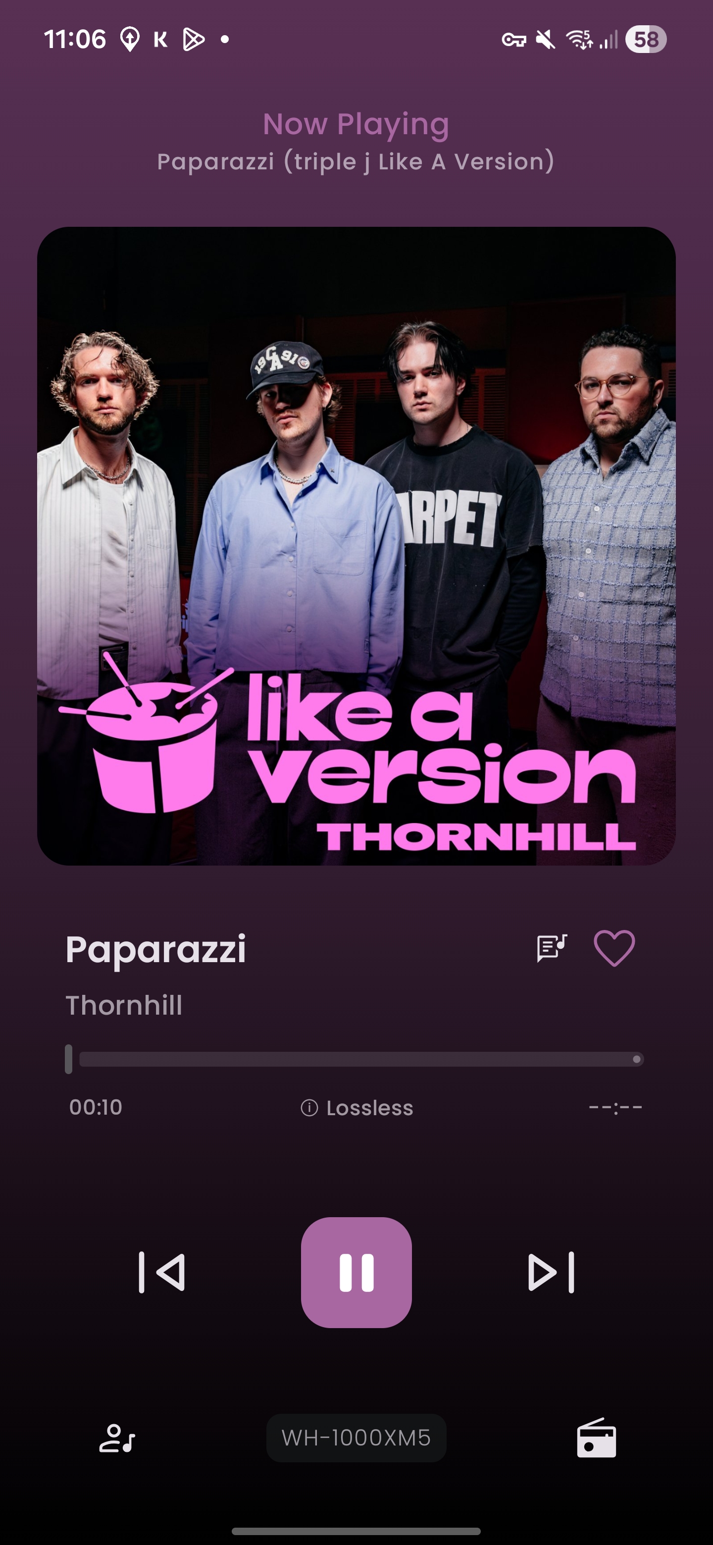

Please also check logs named “thekingpin2”, here I have directly replicated the issue. First playback doesnt report any track end, but, when I skip forward/back to track the track end is reported correctly.
If it helps, I cannot seek the track while end is not reported. When I skip forward/back to the track, seeking becomes possible again. It’s almost as if the initial transcode is problematic until the track gets cached. I haven’t changed anything in the Navidrome transcode though.
Coming back to this again, I can confirm that the issue is only present when transcoding. When playing in original format, the track end is reported immediately.
