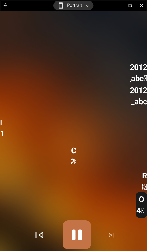

Pic 1: ChromeOS displays a ⌧ for this extra character. (If not for this, I never would’ve figured out the problem.)
The top two pairs have the same text but the first pair uses \n while the second pair uses %lb%. The first pair clearly cuts off the start.

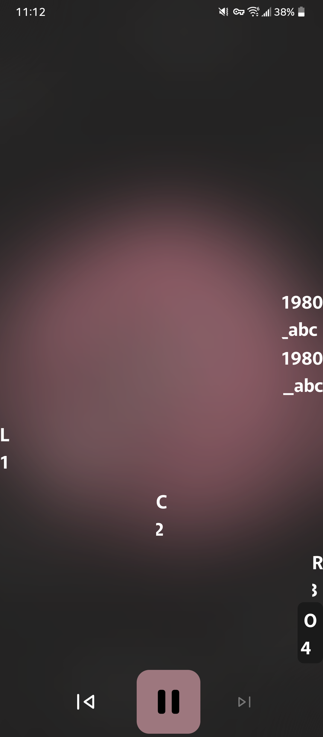

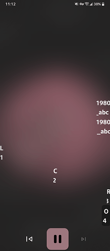

Pic 2: On my Phone, extra character is not visible but still affects alignment. (Horizontal margins are set to zero.)

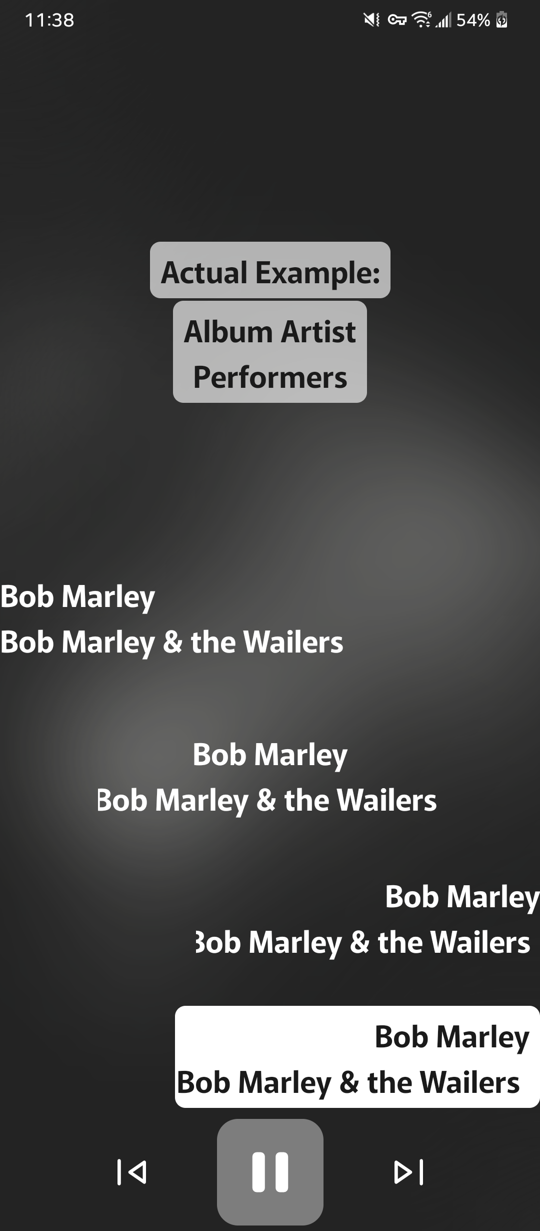

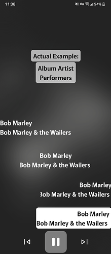

Pic 3: a more normal scenario. My workaround was to just enable an overlay (as seen at bottom) to prevent the text clipping. But I see now that the alignment is still off due to the extra character.

You are abusing an hack :slight_smile: I’ll have both work like LB for consistency but the trailing \n will no more work.
To clarify, I assume trailing LB will also not work?
I’ll have to figure out a normal way of handling that string now :laughing:
It already does not work, I’m just being consistent.
