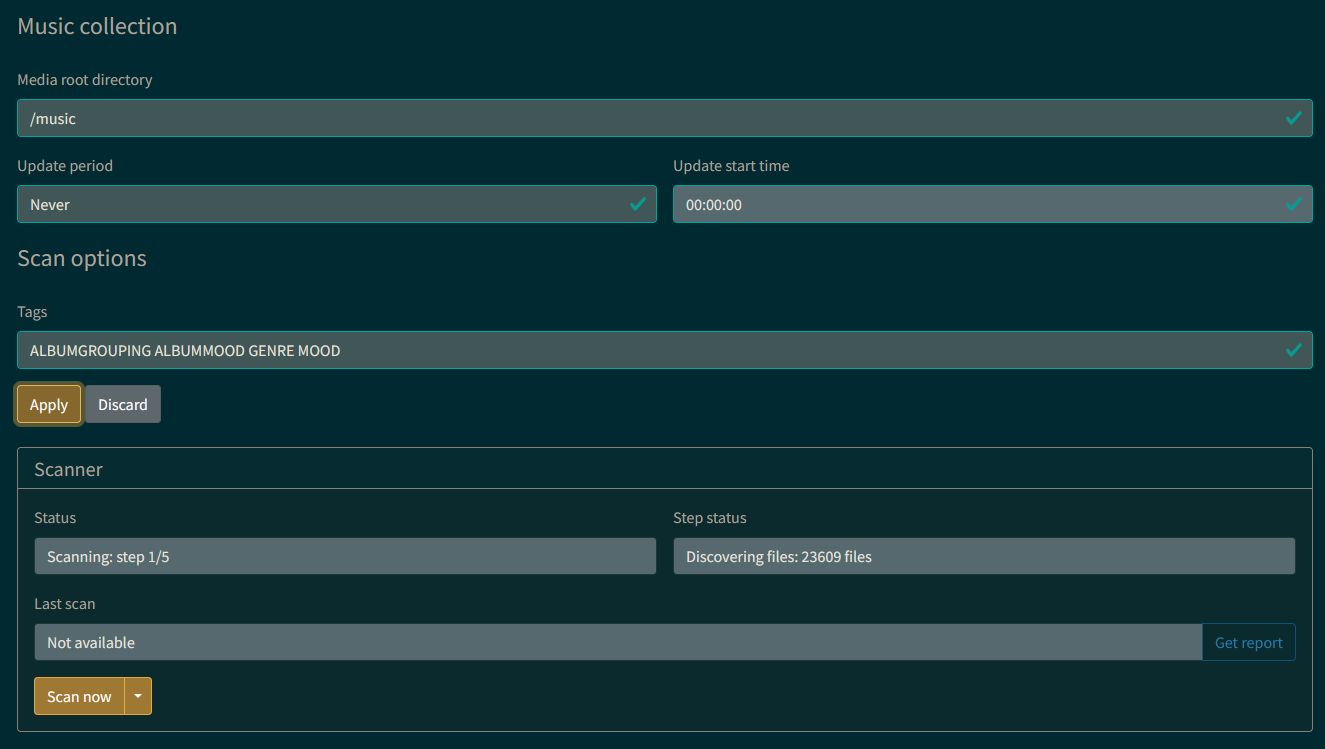

These are the complete logs from starting the container, logging in, supplying /music as the root and hitting scan.
_lms_logs.txt (15,7 KB)
@itm so is there anything else I can try? Otherwise I’ll bench using lms for now.
From the logs, it looks like the root media directory is not set.
I guess you directly started the scanner without saving changes first?
That’s hilarious and sad at the same time.
From the layout it looked to me like “Apply” only affects the “Tags” section of “Scan options”, which I did not change and thus I did not think of hitting “Apply” there.
Now it’s merrily scanning away.
Indeed poor UI, will try to better isolate the scanner
