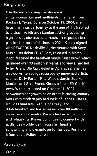

Hi i have used proper syntax for adding website links and insta links in Artist.nfo file but it doesnt get recognized in symfonium , i also tried adding in bio also , the links still they are not clickable !! am i doing anything wrong ?

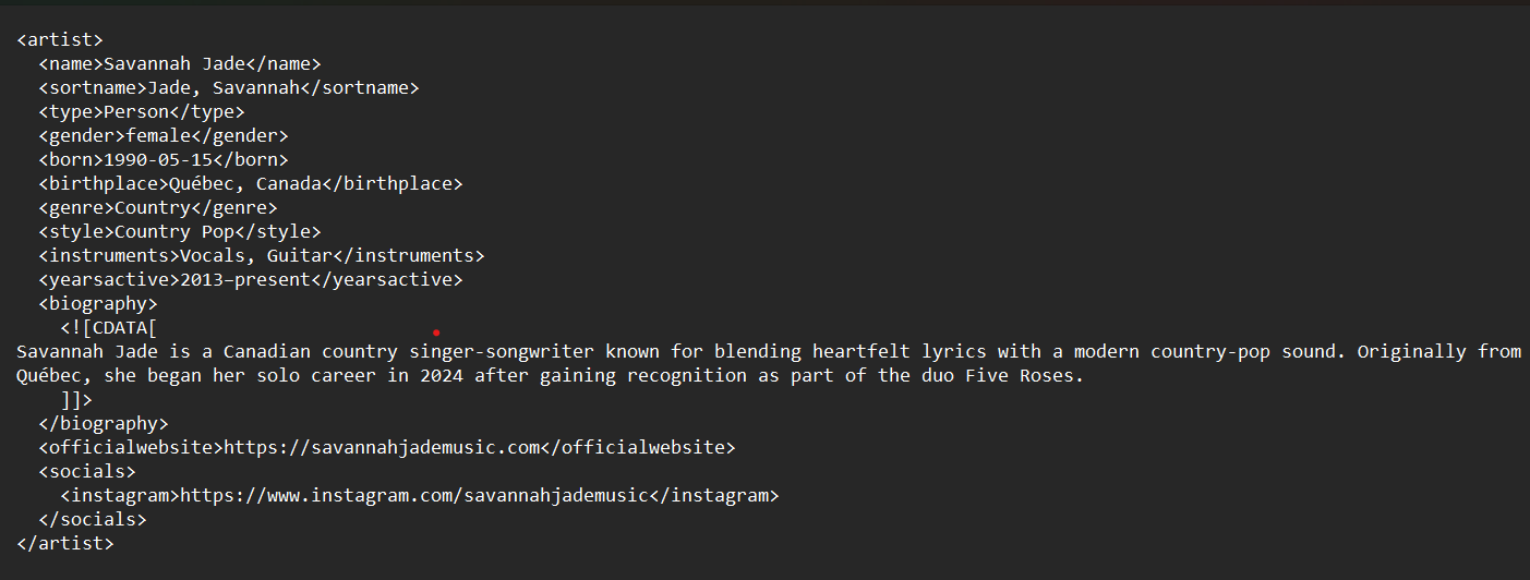

this is the demo syntax i am using for the artist :
please guide me accordingly !! I dont think Logs is not required for this !! still i have uploaded the logs .
Upload description: debug logs
Everything shows , except the website link and insta link !! Thanks
What made you invent those tags that are not existing anywhere ? :wink:
Put the link inside the biography.

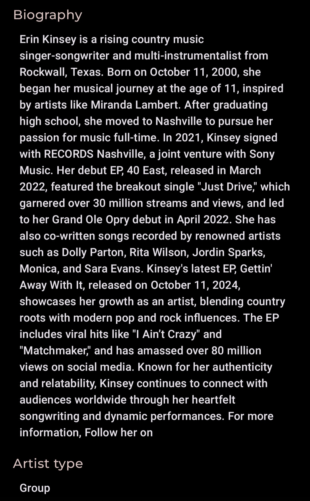

I just googled up for the insta link syntax and tried to tweak it , see if it could help me . If i add the webiste or Instagram link inside the bio , it doesnt work , can you help me how to solve this ? Thanks !

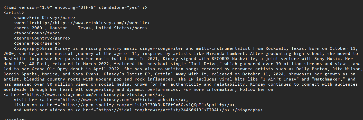

So i used this another syntax and added links inside the bio and the links are not detecting , what should i do ?
This is not a valid XML …
Use an XML syntax validator, either keep the CDATA stuff or properly escape.

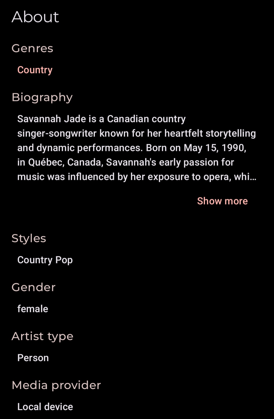

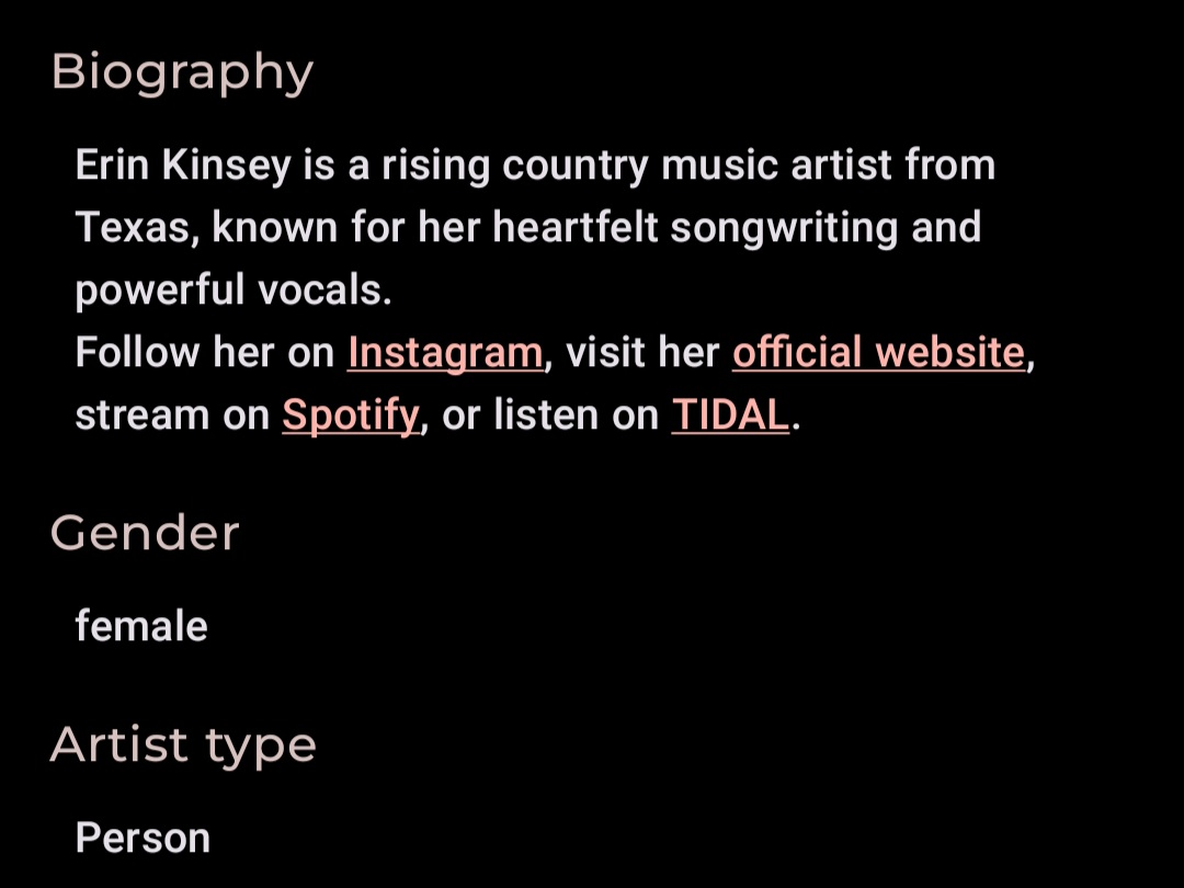

Used CDATA and it worked !! Thanks Tolriq for the help …
