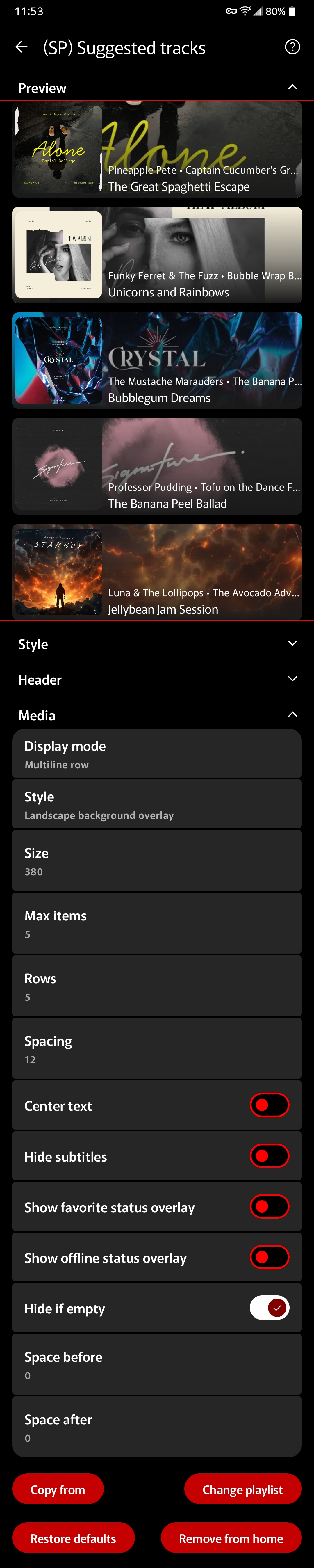

The “Size” takes a little playing with, but Multiline Row can mostly achieve what you are after:
The trick is to make sure “Max items” is less than or equal to “Rows”. This ensures that you get a single column instead of multiple. Then adjust the “Size” until it fills the width of your screen.
You are limited to 12 items, since that is the max value for the “Rows” option. But as long as you don’t need more than 12 items to show, this setup should do what you asked.
