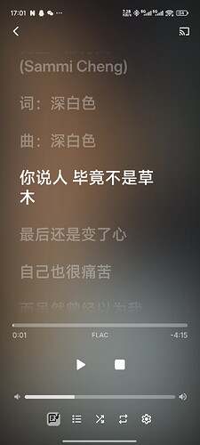

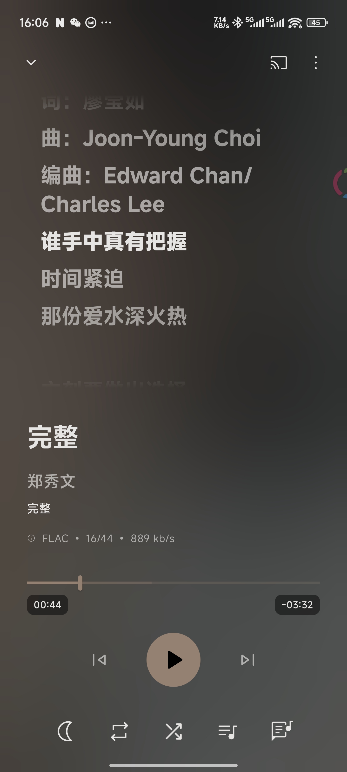

pic 1 is the embedded lyric in Emby, pic 2 is in Symfonium. All of them are in the postion of the first line of lyrics(the correct one is “你说人 毕竟不是草木“). The incorrect lyric in Symfonium is previously from a wrong .lrc file.
The first of the two attached images has been replaced, as the wrong old image was posted initially. It also seems there are some discrepancies in the song file’s lyrics (just slight differences in the opening lines due to different song providers, but both lyric versions correctly correspond to this song. The lyrics called up in Symfonium were indeed the previously incorrect version).
If you had already viewed both images, you may need to double-check that it’s the new one.
