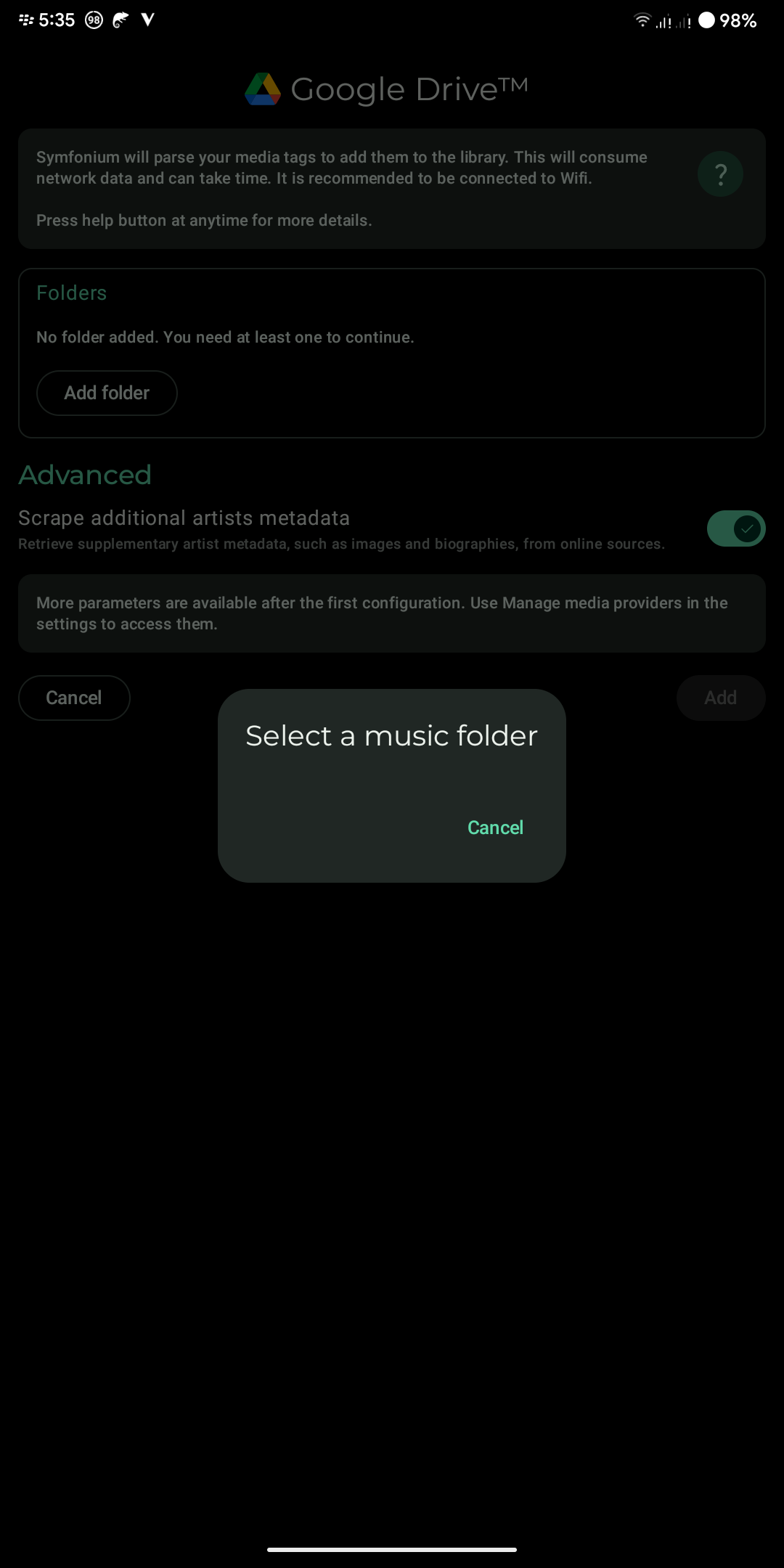

GoogleDrive login was successfull but when i was about to select folder, it stuck on “select a music folder” ! in same app before a month ago i was able to select folder without any problem. And one more thing why we cant able to choose folders by ourself then symfonium should do rest of the work.
see i used “shared with me” folder last time, it detected songs but it took good enough time to recognize it because “shared with me” folder having so many other folders too, so my request is after authentication/login page users should have the access to choose folders, sub folders, then symfonium do further things.

But I have no idea what you are talking about, you can and need to select the folder you want.
For subfolders just create shortcuts.

answer: Yes! And google drive asked me that symfonium wants access then i gave then i redirected to the page of symfonium, screenshot i above shared. But i told you before too, its a “shared with me” folder of google drive but in actual the drive is empty. Catch is, it was working a month ago with ‘shared with me’ folder of google drive which was shared by my friend. And i tried to access them in gdrive is totally fine. and can i send logs here ? Safe here? Not public?
I got the new logs and Google does not return any accessible folder via the API that’s strange.

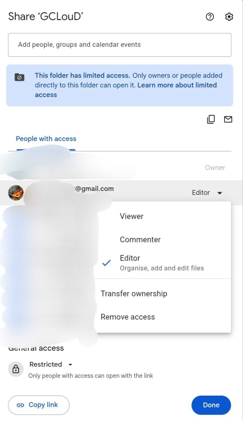

How are the folder shared with you? Can you show me what you see when logged to web Google Drive.

i’m as an ‘editor’ in that ‘shared with me’ folder of GoogleDrive.
Brother my friend just checked, if you have “OWNERSHIP” of “shared with me” folder of GoogleDrive then only symfonium recognizing it, symfonium recognizing the same folder because he’s the owner
and almost a month ago it was not like that.
i was the editor of that folder
that time too but it was recognized by symfonium. May be new version of symfonium have this problem. And its quite disappointing.
