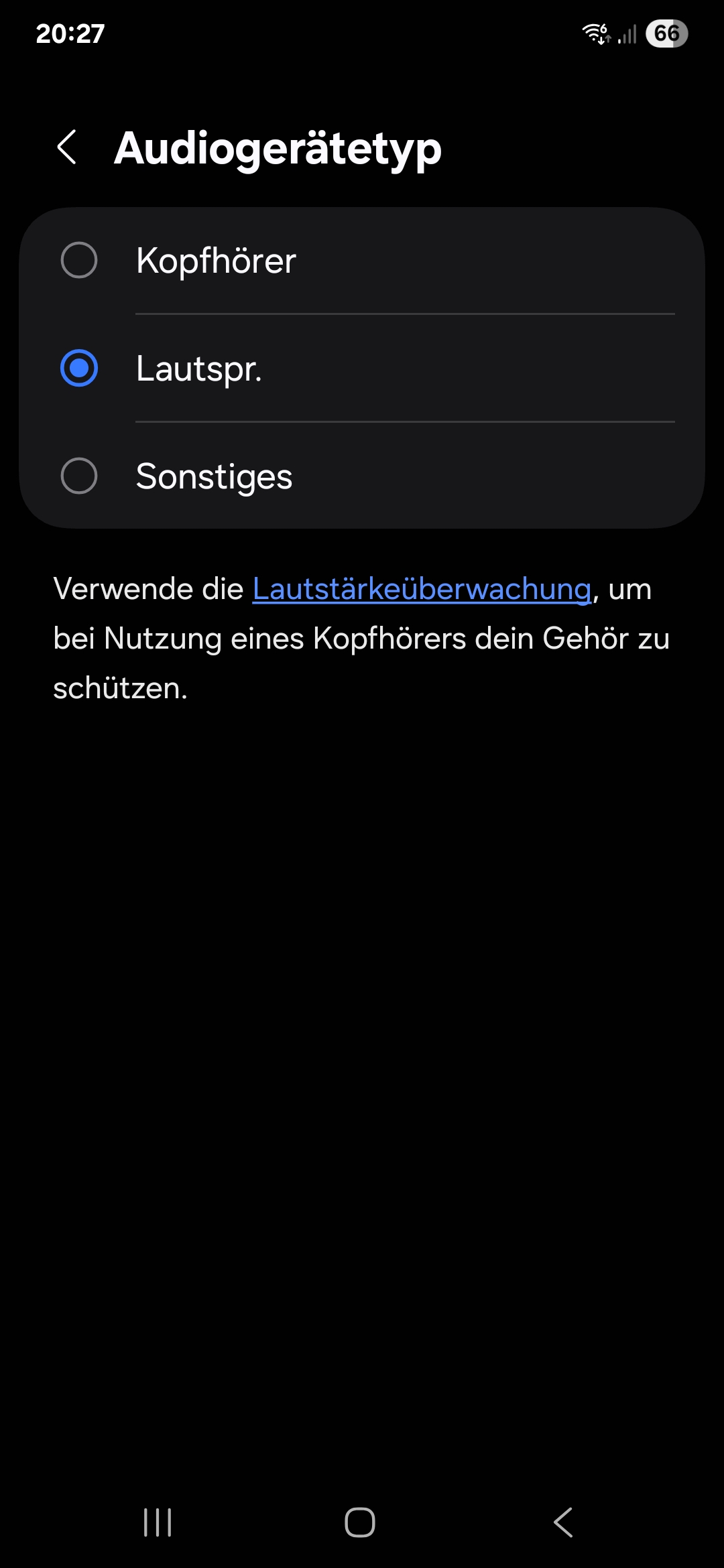

While searching for the reason I came along a setting (I think it was in bluetooth settings) declaring the car audio bluetooth connection as “other” (in german “Sonstiges’) not as “speaker” or “headphone”…
Might this be the reason why the screen switches off?

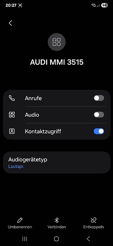

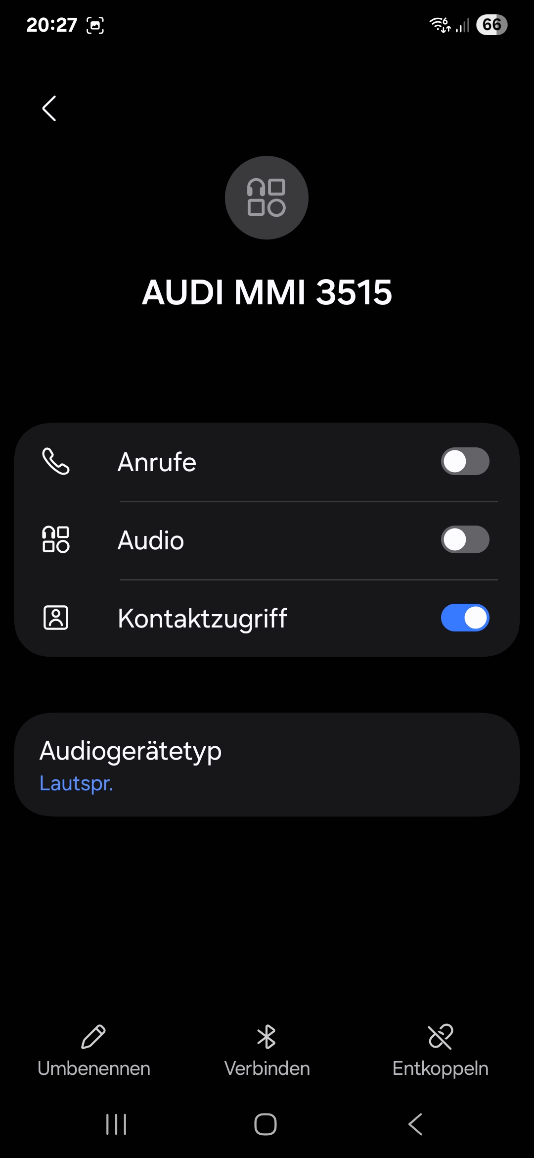

I could make a further test and it confirms my assumption:
When I change the audio device type for the Audi MMI connection in the android bluetooth settings from “other” to “speaker” the screen stays on…
So it seems to be something between Samsung phone and car bluetooth connection…
By the way this change does not interfere with the car multimedia display… title and play time etc. are displayed in the usual way on the car display!
So I think it is safe to keep this setting (audio device type as “speaker”) and everything works as expected! :slight_smile:
