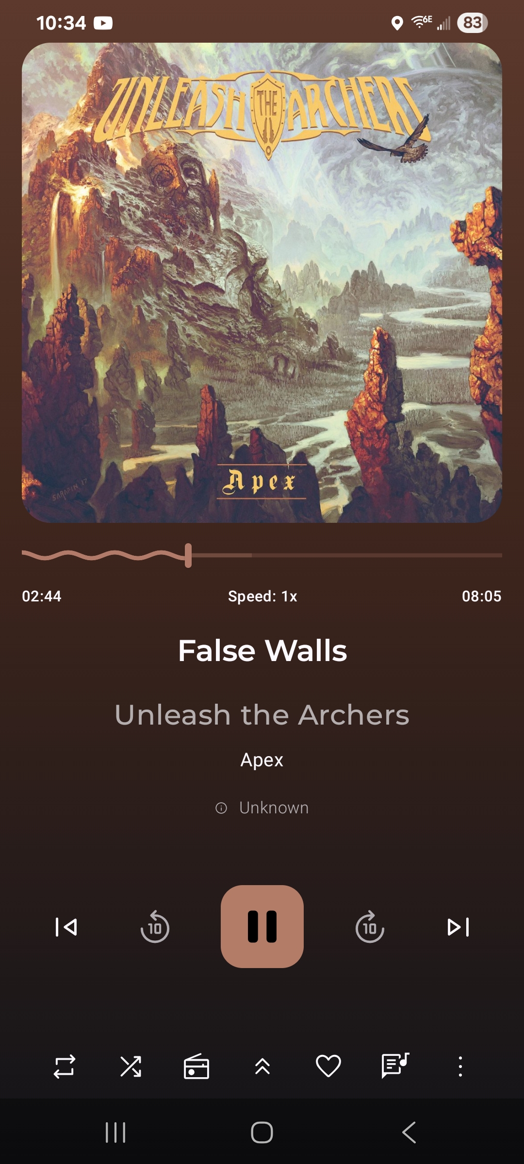

Hello all.
I just setup a Navidrome server a couple nights ago, so I’ve been playing around with clients on my devices.
I’m using Symfonium on Android, and while the app seems great and well worth the price for a license, the only issue I’m having is that when I play something the info just says Unknown.
All my music is FLAC, so it’s not like I don’t know what the codec is, but seeing the “Unknown” just irritates me for reasons I can’t really explain.
I don’t know if this is client side or server side. The Navidrome UI doesn’t even seem to have a place to show you the codec when media is playing, at least not that I’ve found, so I can’t verify that it’s showing up correctly there.
I have an iPad I’m using Amperify on, and there, when I first start playing something, it shows me the bitrate but not the codec, until I’ve played it, then if I cycle Previous and Next and play it again, it has the codec then. That’s why I thought I might be missing some configuration server side.

Upload description: Xyn, can’t help it’s only three characters
All my music is in FLAC, hosted on Navidrome through Docker Compose.
Whenever I play any song I have, it plays perfectly, but it irrationally bugs me that the playback info just says Unknown no matter what I try.
Your proxy returns error 404 when trying to extract the details. check it’s logs.
Thanks! I had a feeling it was server-side.
Removing the Authentik middleware from the stack makes it work immediately, so the problem was that it was trying to authenticate the /rest call with Authentik.
I’ll have to decide if using Authentik is even worth it in this case. Probably not, considering that app clients need to authenticate with username / password anyway.
