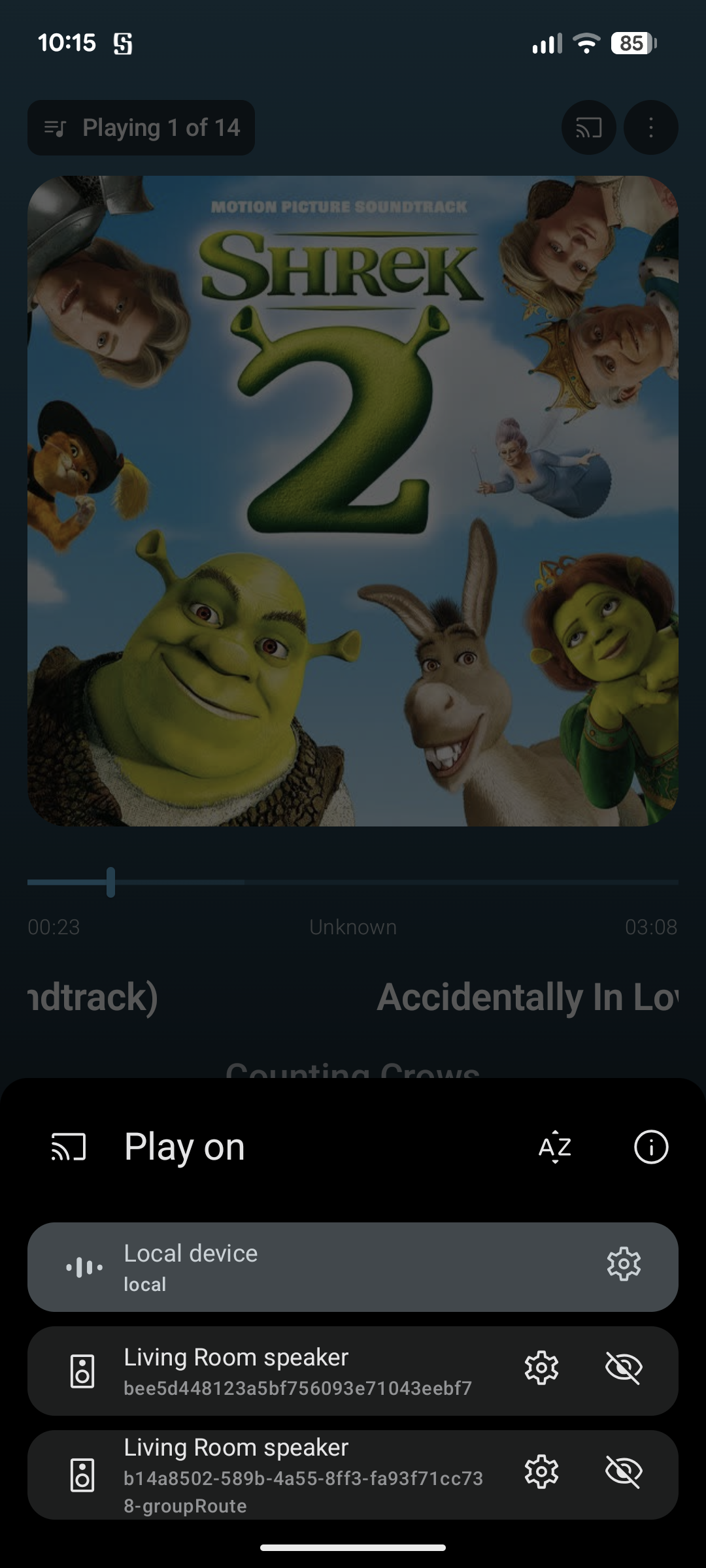

Thank you for being so responsive btw. Sorry for the delay didn’t have a lot of time those last days. Here is a screen recording https://youtube.com/shorts/14iGPpVzJLU?si=EESOKcJ2Eq8b1gKl . I uploaded the logs under my user name (augusto_ornelas). Another weird thing that happens is that the chromecast device is listed twice. I wonder if it’s related to the fact that I have 2 wifi access points at home or the fact that I enabled. Let me know if you need any other details.
Can you press the top I button when you have the duplicated chromecast to see their ids ?
Indeed the duplicate appears when I change access point.
Does the 2 access point use a different SSID and are not roaming ones ? Trying to repro that one.
Yeah, different SSIDs and not roaming ones.
Thanks will hide the second one as it’s not really actionable and the main issue should be fixed in next release too.
