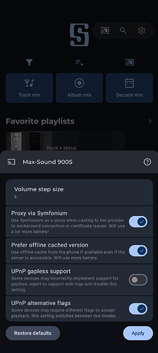

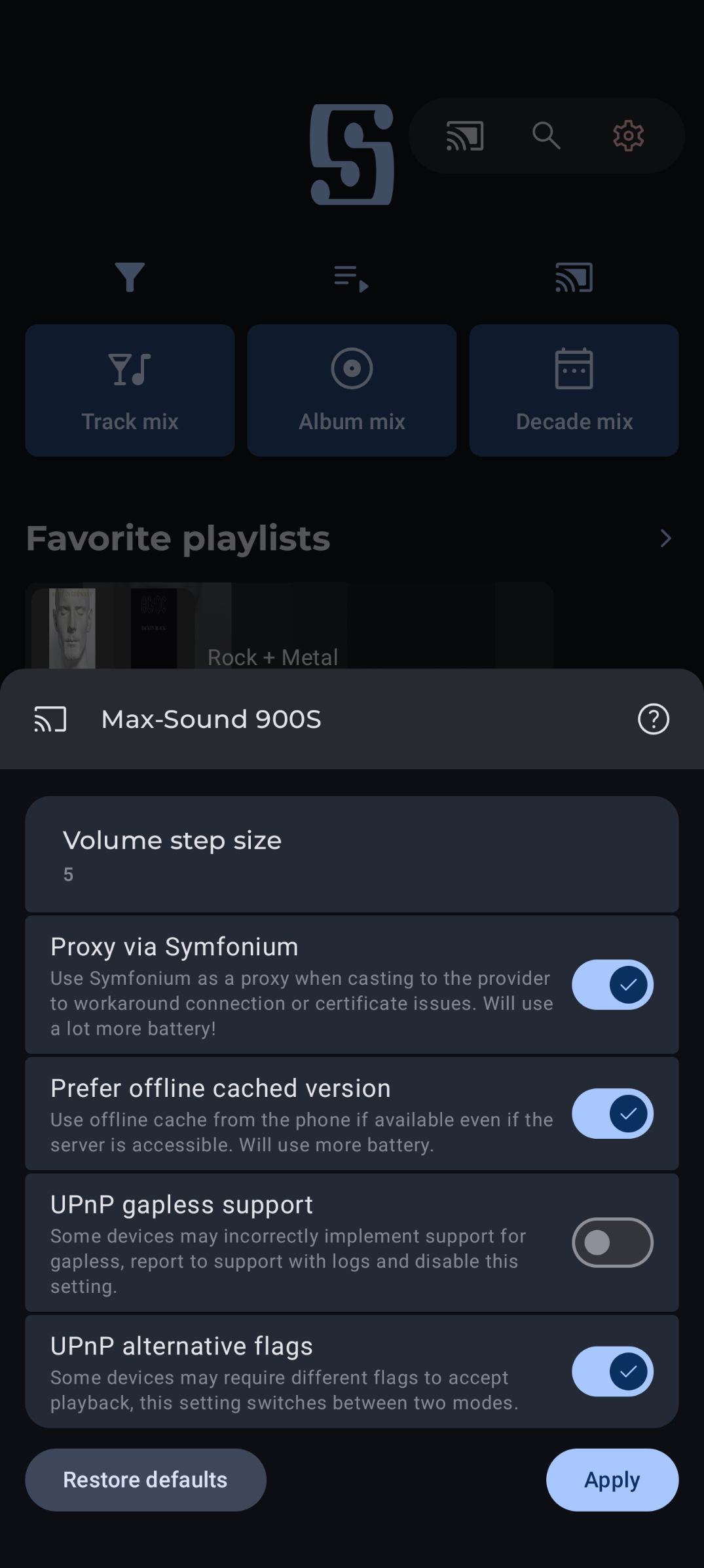

Why do you have the proxy enabled and the prefer offline cached option enabled ?
If i disable the proxy option, then it doesnt even play offline files.
I enabled the prefer offline option, because when its downloaded i want to save some data.
